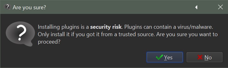

No delay here, a second after selecting the downloaded zip (it's on my desktop), I got this:
Name:	Screenshot 2023-12-15 114259.jpg

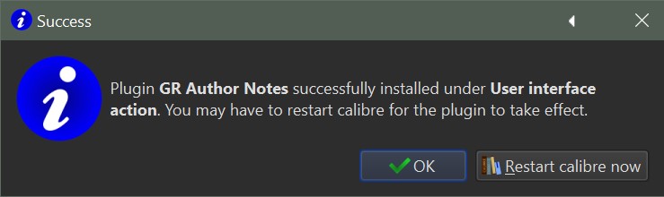

On clicking OK I got this:
Name:	Screenshot 2023-12-15 114348.jpg
Attachment 205204
Attachment 205205
This is what I get as well. I'd be interested to see error you are getting upon restart when run in debug mode.

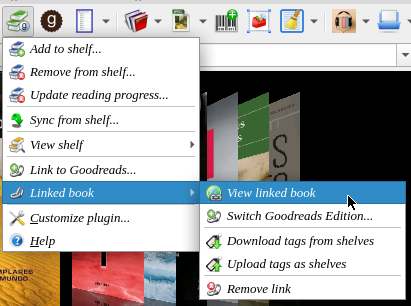

Originally Posted by azuravian View Post
I'm also working on matching the author to the book in a more appropriate way. Right now, it's probably 99% accurate, but it will definitely be wrong sometimes.
You could see how the goodreads (metadata) or goodreadssync plugin marks the book with its link.
Maybe that will help you
