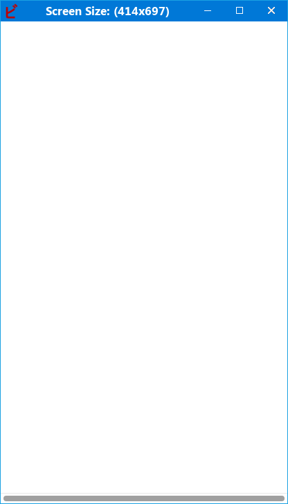

That is not true; sorry to be harsh, but your code doesn't work. This is how it looks under:
Bibi Reader:
Attachment 205200
The cover is not showed at all.

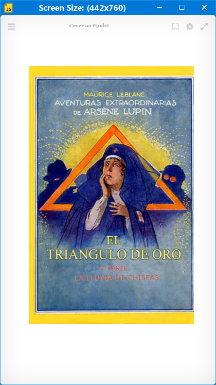

EpubJS Reader:
Attachment 205199
The right side of the cover is not showed.

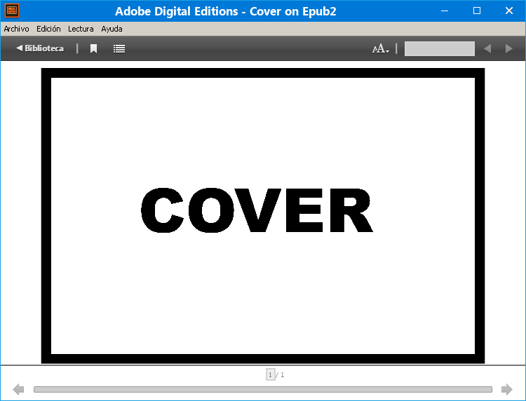

The cover code I posted above (that makes use of a svg wrapper), so far worked everywhere (epub2 and epub3), and even in FBReader. But if you find an app/program where the code does not work (that can be perfectly possible) I will thank a lot if you tell me about the issue.
It does work in ADE 2.0.1.
So far, the code I posted is working in:
  • Kobo
  • ADE 2.x (Windows)
  • ADE 4.x (Windows)
  • Thorium (Windows and Linux)
  • Koodo Reader (Windows and Linux)
  • IceCream Ebook Reader (Windows)
  • NeatReader (Windows)
  • Foliate (Linux)
  • Readium (as Sigil plugin)
  • Bibi Reader (as Sigil plugin)
  • EpubJS Reader (as Sigil plugin)
  • Calibre Viewer (Windows and Linux)
  • EPUBReader (extension for Chrome and Firefox)
  • ePUB Reader (another extension for Chrome and Firefox)
  • PocketBook (Android)
  • Gitden Reader (Android)
  • Reasily (Android)
  • Aldiko Next (Android)
  • Lithium (Android)
  • OverDrive (Android)
  • Infinity Reader (Android)
  • Bluefire Reader (Android and IOs)
  • BookFusion (Android).
  • Colibrio Reader (Android)
  • FBReader (Android)
  • Supreader (Android)
  • Readera (Android)
  • Google Play Books (Android)
  • Moon+ Reader (Android)
So, if you say that the code that I posted above could fail, well, I cannot deny that because it may fail. But I ask where? Because in all the programs and applications in which I have tested it so far, it works.
