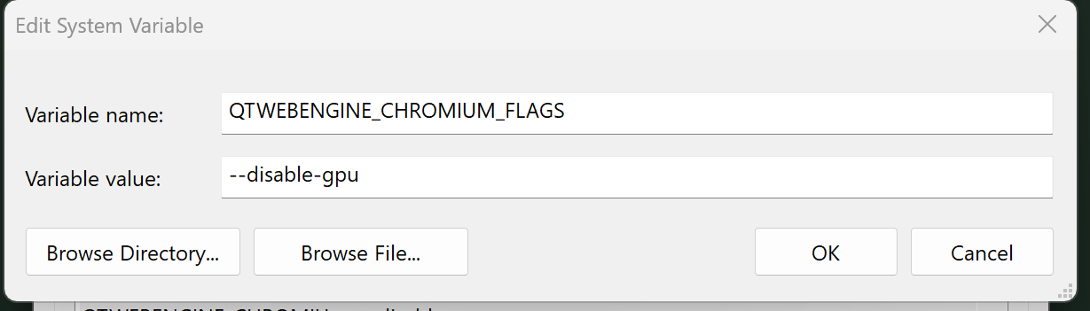

Hi, yes, I did. Still no luck. See screenshot.
Name:	2023-11-18 22_39_21-Settings.png
dhowl is offline   Reply With Quote
Old 11-19-2023, 12:00 AM   #20
Posts: 22,924
Karma: 34252880
Attachment 204795
That's the QT environment variable.

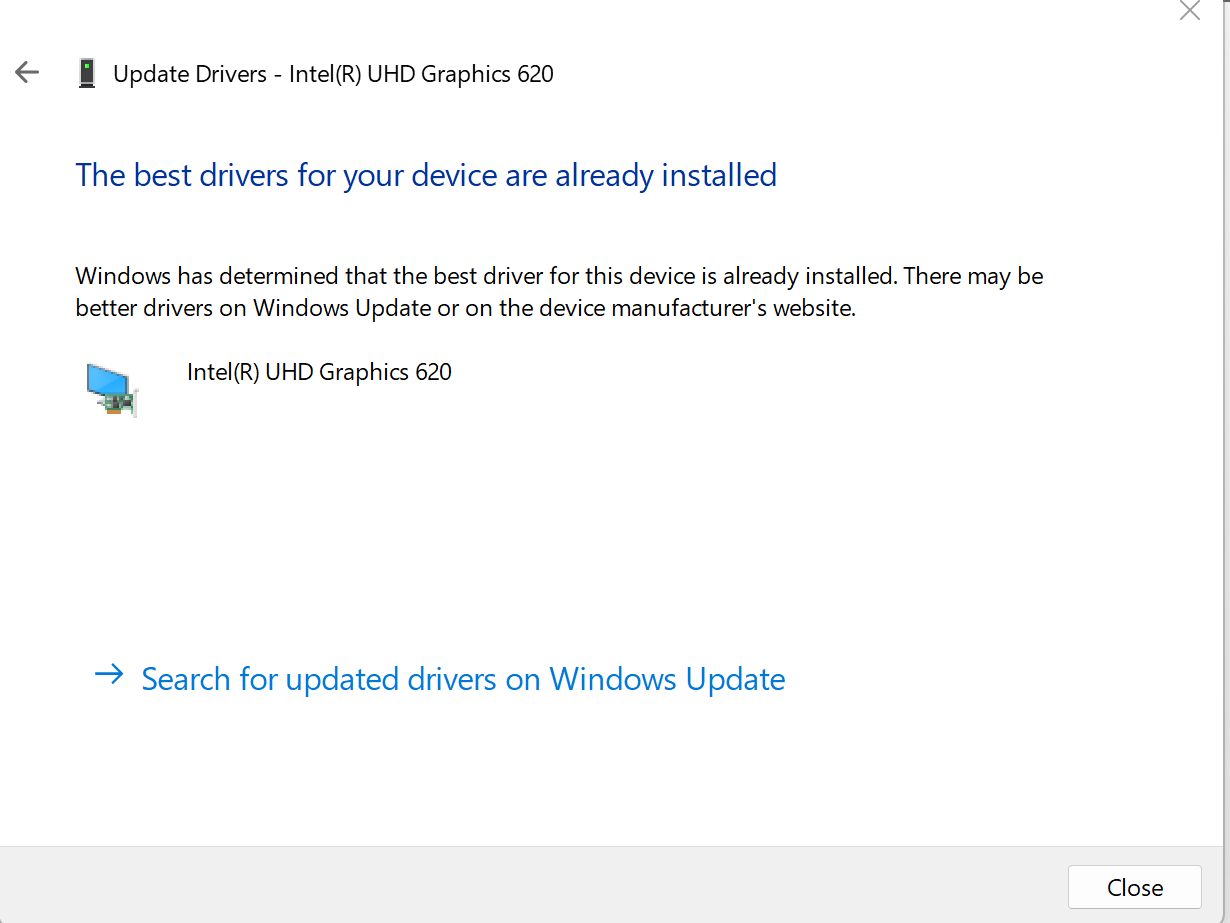

Drivers are updated via the Device Manager, type "device man" into the start menu and Windows should offer it, then:

Oh right. I did try that before but it says the driver is up to date.

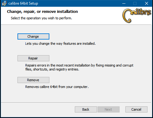

maybe try a repair install?

Tried repair too. No change.

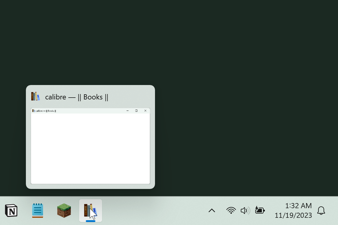

Just to show you one aspect of the behavior. The below screenshot shows that when I hover over the taskbar app, it appears as a white window, but if I click on it nothing happens. So it's there, but won't bring up the window.
