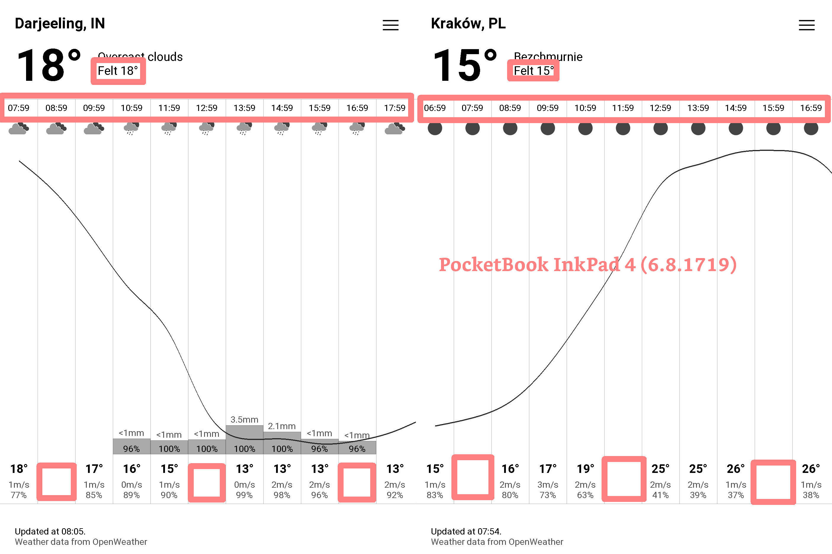

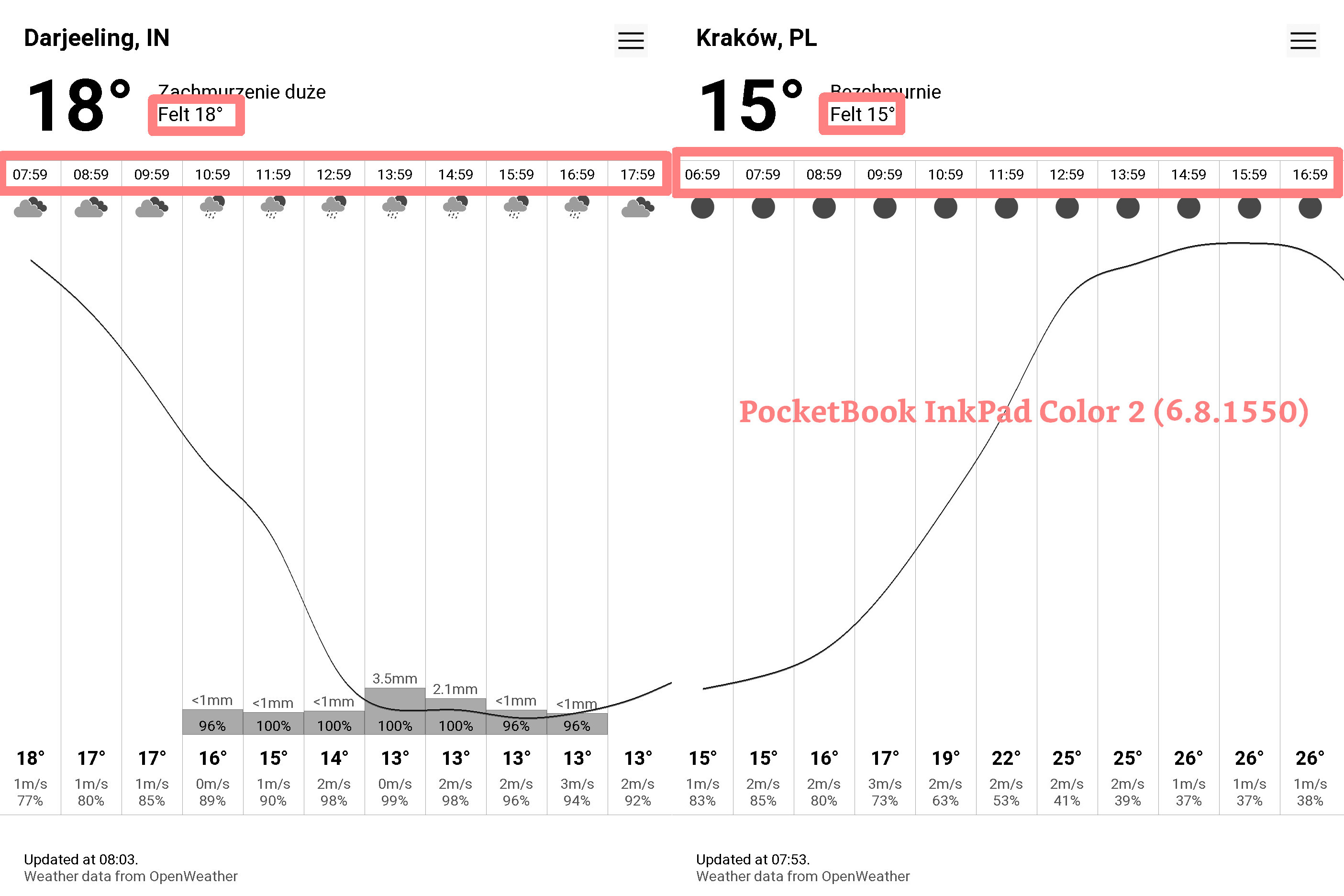

I'll create an issue. It seems to be related just to InkPad 4. Empty spaces are in other locations and other language versions of menu. There are no empty spaces on InkPad Color 2 (Polish menu, different locations). See attachements.
I'll chceck other models later.
ID:	203639   Click image for larger version

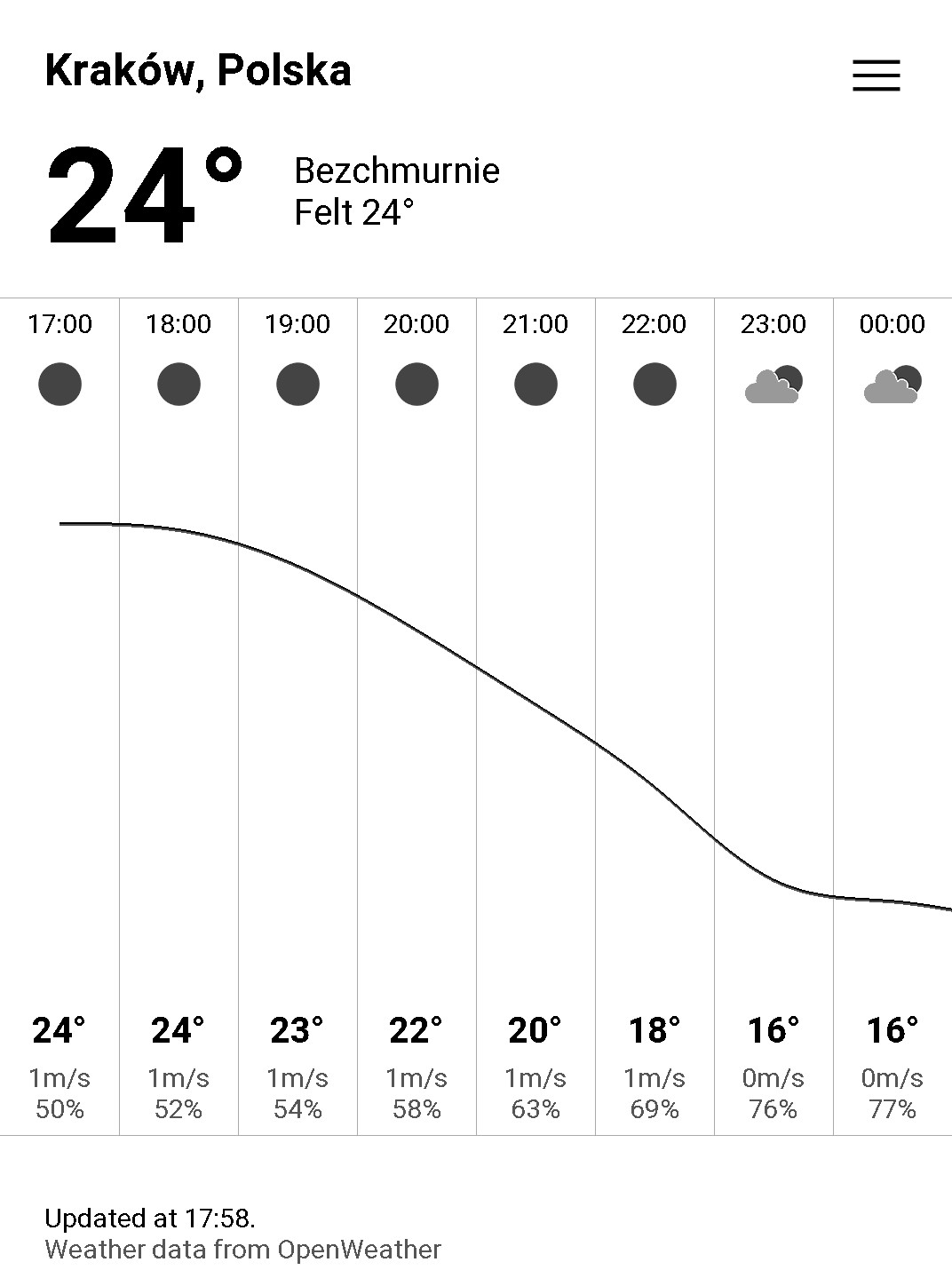

Originally Posted by orontee View Post
Sorry I can't reproduce, even after I changed the language of my reader to polish.
Does the problem of empty forecasts persists on your side? Even after you refreshed the data (first menu entry)? For other cities? With different language?
The other weird problem related to time display may come from Openweather since taranis only convert the timestamp of the forecast. Anyway I'll add code to round to the nearest exact hour.
It looks much better on PocketBook Touch HD 3 (firmware 6.7.17.06) - no empty places, time is OK. So software version or screen size is the factor.
Cyfranek is offline   Reply With Quote

I'll create an issue. It seems to be related just to InkPad 4. (...)
Ok. Can you post the software version used on this reader?
Also, if you have a terminal running on this hardware, can you post the output of a call to `locale`?
I haven't got terminal on this ereader. Software version is 6.8.1719.
