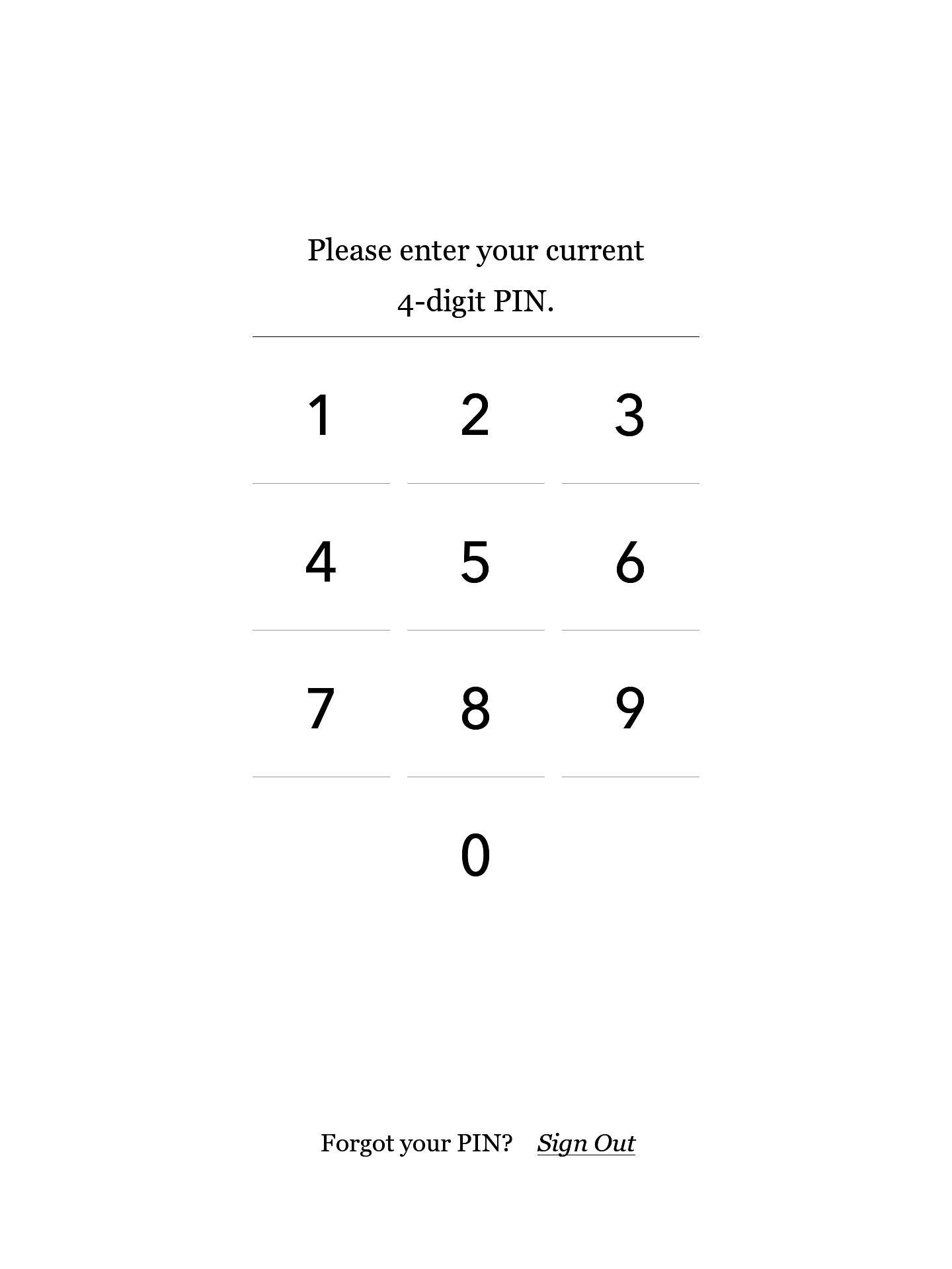

Is your Kobo (home screen) Password protected (Is that even possible?)
Yes. If you have enabled a PIN (Settings => Energy saving and privacy = PIN LOCK), it will be asked for the PIN before showing the cancel/connect popup if the Kobo is not awake when you connect it to your computer.

I don't have a PIN on my Kobo. I'm wondering whether my problems with the collections (or shelves) are due to Calibre or the Kobo firmware.

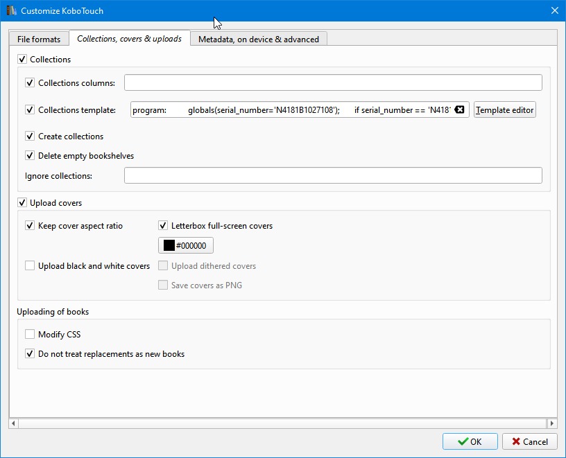

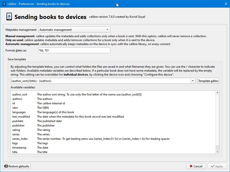

Lets start with checking the basic calibre configuration. Please post images of the following two calibre dialogs:
  • The Kobo driver Collections, covers, and uploads dialog.
  • Calibre's Sending books to devices dialog.
Images of mine are attached.

In the meantime, I'll tell you how the first dialog box is configured:
1 Collections: checked
2 Collection columns: tags
3 Collection template: unchecked
4 create collections: ticked
5 delete empty shelves: ticked
6 Load covers: ticked
As for the second image, mine is identical to yours
Patrick Faret is offline   Reply With Quote

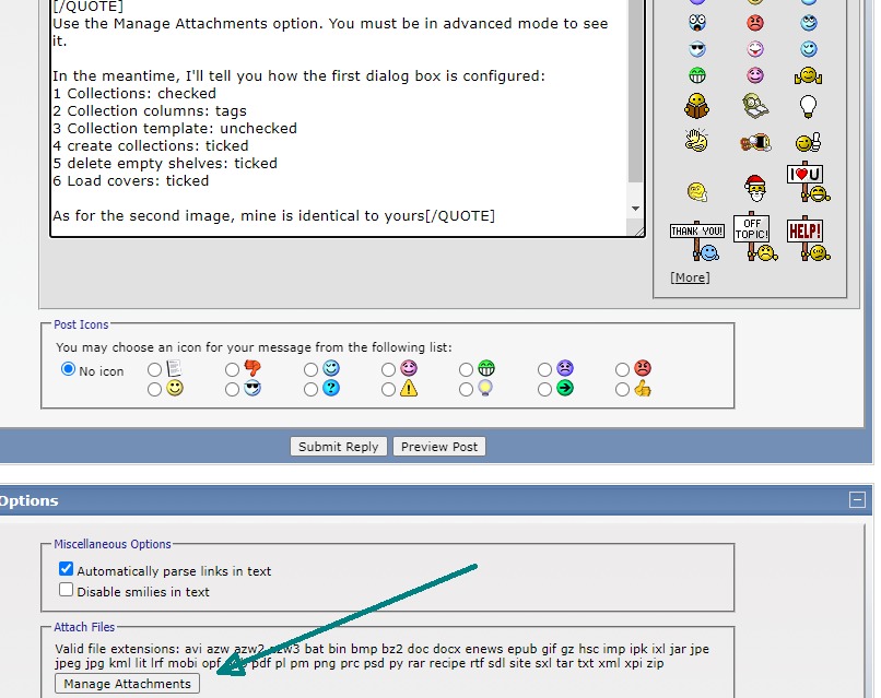

Can you tell me how to attach the images you're asking me for? I'm not very good with computers.
Use the Manage Attachments option. You must be in advanced mode to see it.
Those seem correct.
