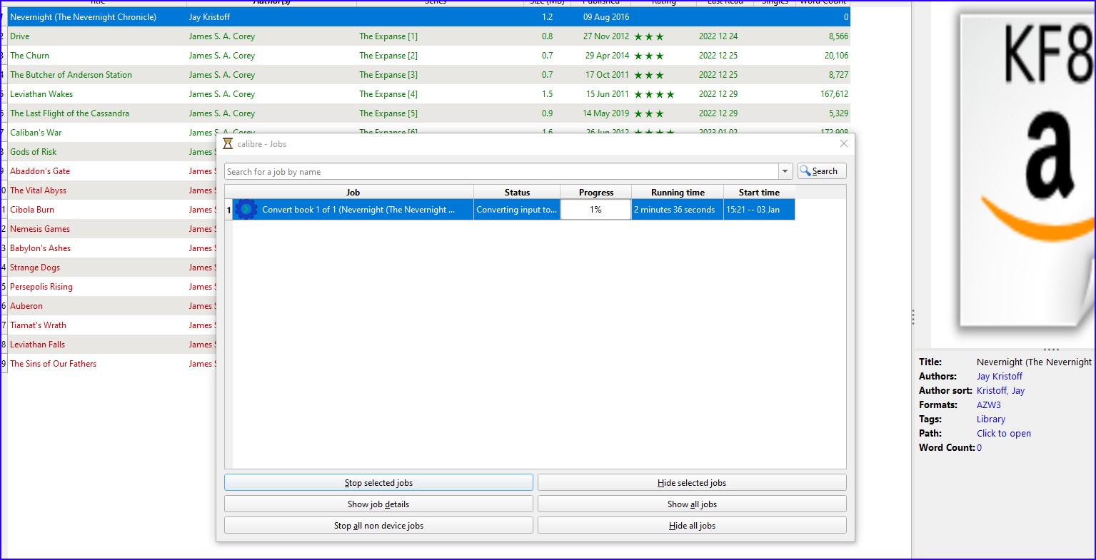

A bit late to the party, but I gave the conversion a try with Heuristics enabled (which I have never used)
I seem to have got stuck on 1% using about 10% of my i7-10700 cpu.
This is my log... https://paste.kodi.tv/ovameledid
Once I disabled heuristics, it coverted in about 3 seconds.
