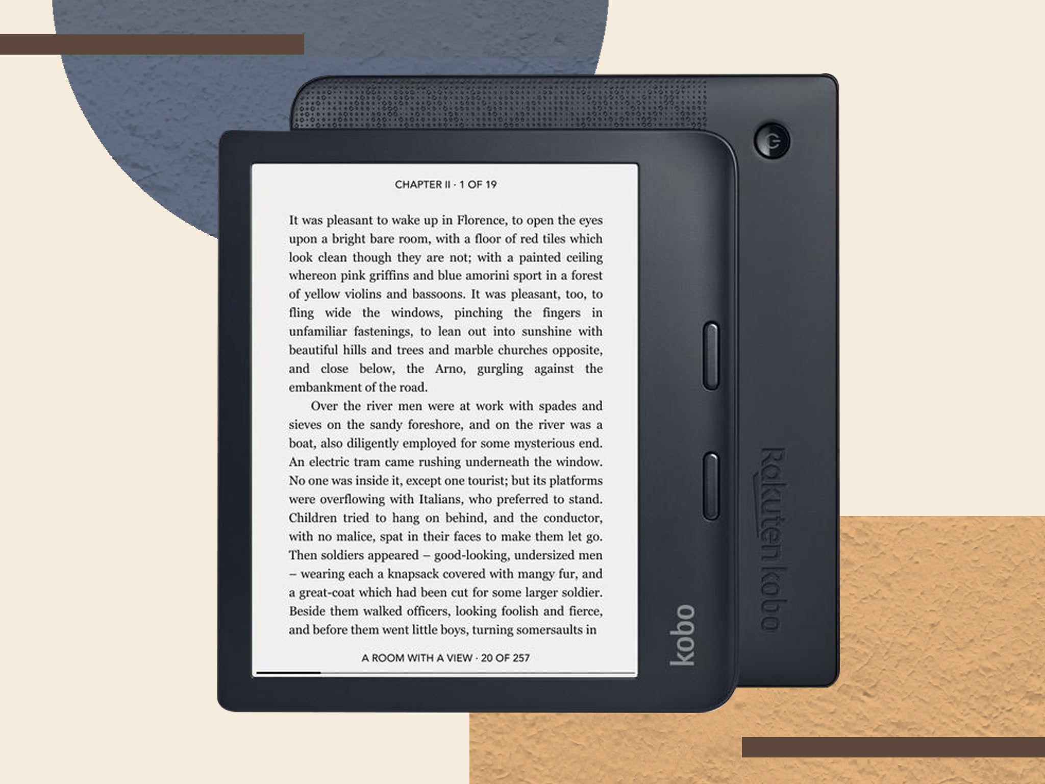

Originally Posted by fogice View Post
Ah, shoot. I did an image search for Libra 2, and that's the one I grabbed. I drew the star on it myself, so I know that is the correct location for the on/off sensor.
Yes, I will confirm that the location of the sensor is correct.

Old 10-19-2022, 05:37 PM   #21
Posts: 85,665
Karma: 154365285
So did I. I just typed in Kobo Libra 2 and bingo, I got the correct images. Here's one.

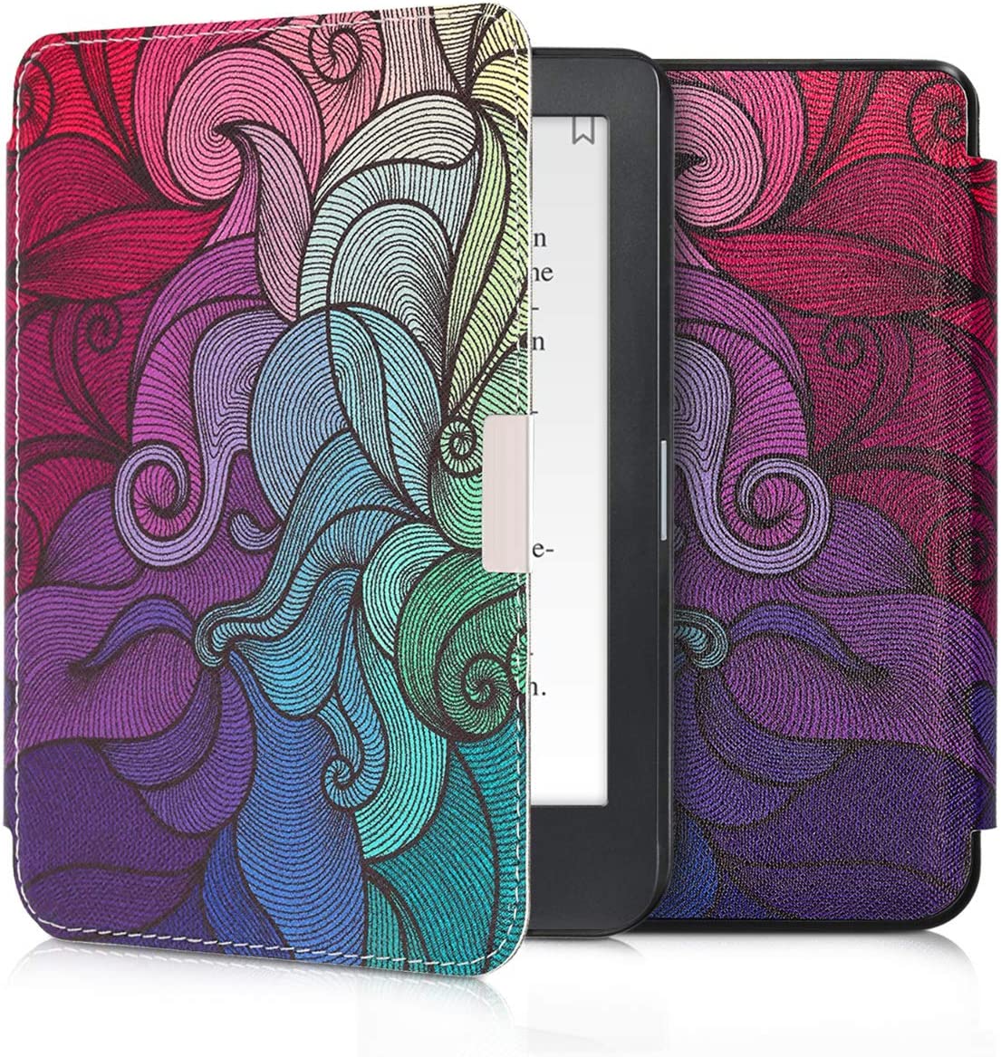

Old 10-19-2022, 05:43 PM   #22
Posts: 85,665
Karma: 154365285
This cover is for the Clara HD. Notice the metal on the front cover. This solves the sleep problem when folded back. The cover I have for my H2O has the same bit of metal on the cover.
