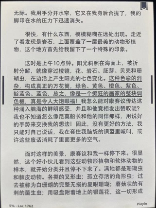

Old 08-11-2022, 04:54 PM   #18

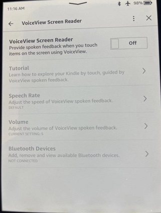

To my eyes, the image in post #10 does not show whether Voice View is turned on or off which was supposedly shown in the image in @Devot3d's first post (#1 in this thread).
Can you see anything in that image about Voice View in the image in post#10?

Originally Posted by Devot3d View Post
[IMG]https://www.mobileread.com/forums/attachment.php?attachmentid=195705&stc=1&d=1660044 833[/IMG]

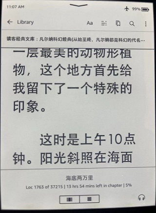

Anyhow, you can see on compatible books there's a headphone icon
[IMG]https://www.mobileread.com/forums/attachment.php?attachmentid=195706&stc=1&d=1660044 833[/IMG]
When you hit the icon and press play it will try to connect to your bluetooth device.
[IMG]https://www.mobileread.com/forums/attachment.php?attachmentid=195707&stc=1&d=1660044 833[/IMG]
While reading it will underline the current sentence.
The TTS actually sounds really good.
[IMG]https://www.mobileread.com/forums/attachment.php?attachmentid=195708&stc=1&d=1660044 833[/IMG]
As you can see the voiceview screen reader is not turned on.
Your images did not post properly so we cannot see what the user interface looks like to you.
Could you please post them as attachments instead of inline images?
That would explain all the confusion in this thread ��������
I see them but opening the thread in a private browser window I no longer see the images ��
Here are those images, I think it was my "new user" status causing trouble
1 is the headphonee icon
2 is the play controls
3 is during reading
4 is voiceview not being active.
