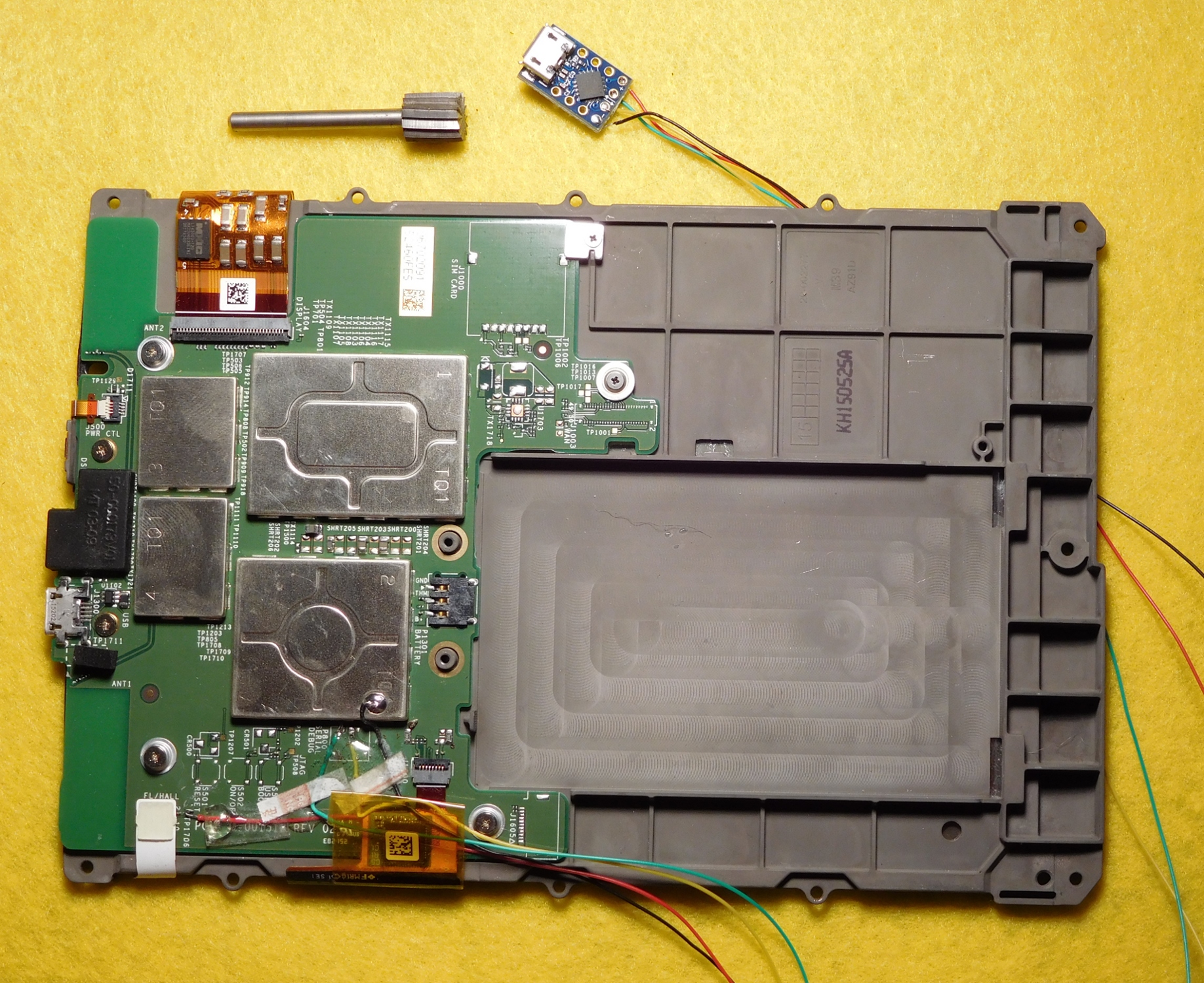

For "spray freezer" do you mean the cans used in case of injuries?
Also, which of the four metallic covers holds the emmc (please open the image, because the orientation changes)? So that I can spray on the right one and be more effective.
I have attached an image of the board (that's a PW3 board, but the aspect is the same of the PW2 one).

Emmc is at the bottom left, closest to the button connector.
I was referring to the freezer used in electronics to search for broken connections. They cool to about -50 degrees Celsius.
