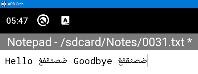

I have no idea what the problem is.
Maybe your Word is doing stuff. Just use any normal text box.
If you start empty and hit something in Arabic then it goes into RTL mode.
If you hit something first in English it stays in the default LTR.
(The Arabic word I use is what you get when you hit "qwerty".)
The first is "qwerty Hello qwerty Goodbye".
The second image is "Hello qwerty Goodbye qwerty".
They behave as I'd expect.

You could try using the Unicode U+200E (LTR mark, ‎ ) and U+200F (RTL mark, ‏ ).
Since in Android Ctrl, Shift are modifiers, I don't think they can be easily used just by themselves without modifying some code.
You can make Ctrl-Shift-LeftArrow be a directional mark. (DPAD_LEFT)
key DPAD_LEFT {
   ctrl+shift:      '\u200f'
key DPAD_RIGHT {
   ctrl+shift:      '\u200e'
I just tried that. The keycodes come through correctly.
When I hit the keys it does wacky LTR/RTL things.
(Full disclosure: I don't really understand how LTR/RTL layout works.)
You'll need Magisk or root or a loadable keyboard map APK.
