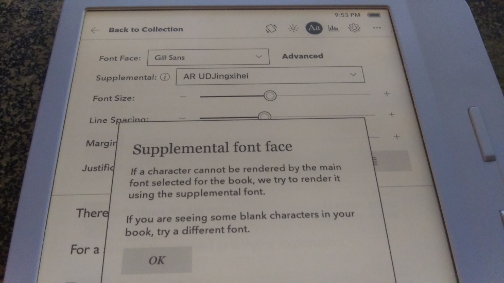

ownedbycats
Custom User Title
ownedbycats's Avatar
Posts: 11,913
Karma: 83456789
Join Date: Oct 2018
This is what I see on a sideloaded book:
Attachment 193232
OMFG that's AMAZING!! It might finally be time to sideload Noto CJK...
Well, now that they moved much of the font logic to the fontickle binary, what would be super awesome would be if they gave us a way to set a default monospace font (and might as well do them all: serif, sans-serif, monospace, cursive, and fantasy, just like you can on Calibre's ebook viewer).
Definitely going to update once the patches are done, but is it really true that advanced font settings for sideloaded fonts by default only works with EPUBs and not KEPUBS without a patch?
