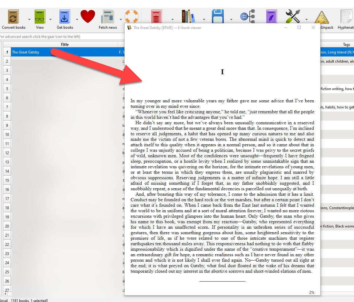

I've just opened a free .epub and .mobile book from Project Gutenberg in Calibre and with the built-in viewer the line spacing is fairly large.
So perhaps it isn't the Kindle/Kindle apps that cause the spacing issues, rather it is the underlying .mobi/.epub file?

I dunno what on earth you are looking at, but that's not what I see. Neither in KP3 nor Calibre:
So...whatcha doin' there?

I've since sorted the line spacing in Calibre by adjusting the line height setting.
Still trying to work out how to make the mobi file when it reaches the kindle to have the proper line spacing like it does with purchased books.
All purchased mobis have 1.2 em line-height. If that's what you want, email it to your Kindle email address.
