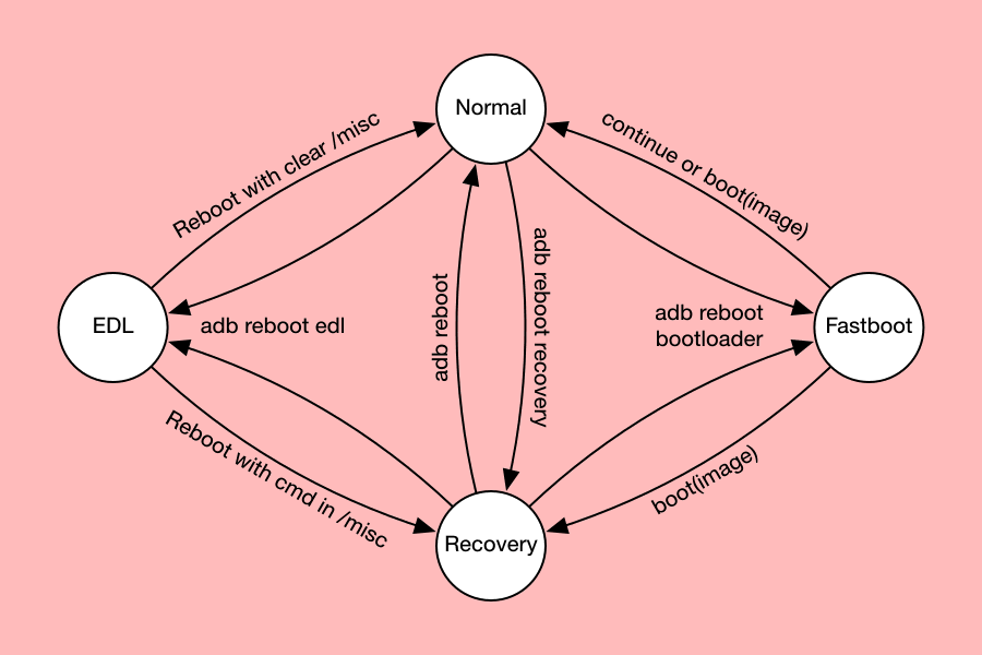

I was trying to draw a diagram to make things clearer. Mmm, not sure that it did.

Thanks for your elaborate response and the diagram (it looks crystal clear ).

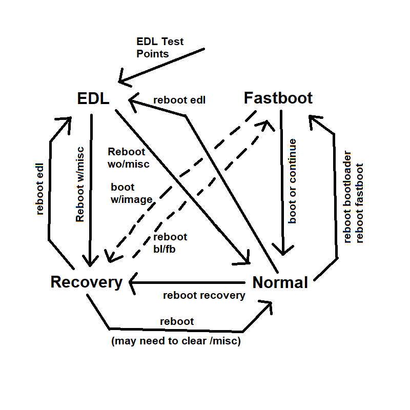

Ok, is this any clearer?
