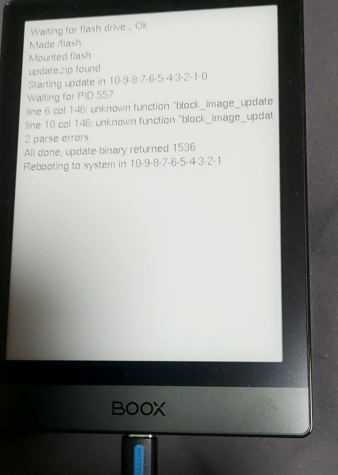

did every step as mentioned, got the white black white screen as well...
got up to autoupdate and then I got this error message
line 6 col 146: unknown function "block_image_update...
line 10 col 146: unknown function "block_image_updat...
2 parse errors
PS: Yes I did use DeBooxUpx.py to create the update.zip from the poke 3 update.upx file

Sorry, my bad. I stuck the wrong update-binary in there.
Load a new version of p9mod from the same URL, it should be 20,766,720 bytes.
Now that you know how it goes, you should be all set.
As I said, the only thing left *might* have to be a prop or a symlink.
