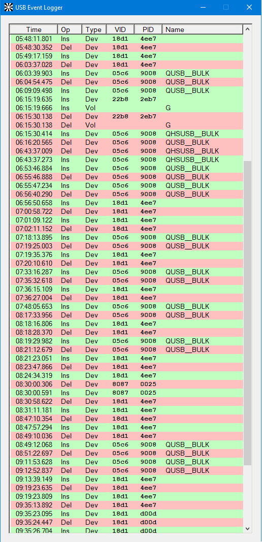

Old 04-07-2022, 01:38 PM   #24
Renate
Onyx-maniac
Posts: 4,582
Karma: 22201479
More and more screwiness.
I don't understand that 0% Ok, that makes no sense. Did it actually go to 100% but it's not showing that?
Late in the day for asking this, but the Max Lumi 2 has buttons so that you can always get to fastboot?
Go to fastboot. Plug, unplug the cable a few times. UsbLog should probably show 18d1/d00d in green when it's plugged in and Windows should not complain.
If UsbLog is not changing all pretty, go to Zadig, Options, List all devices and look for 18d1/d00d, install driver.
Edit: Once again I'm guilty of bad/misleading messages from edl.exe, but (probably?) not of the actual problem. Thanks for helping me clear them up!
I think that you're still having flakey USB problems
Sheesh: There's a new edl.exe up at 131,584 bytes.
In my own defense, I'll just say that I've been using edl.exe on something else and have been slinging partitions around for hours without any problems.
Old 04-07-2022, 02:18 PM   #25
Machinus
Machinus began at the beginning.
Posts: 42
Join Date: Sep 2017
The Lumi 2 has a power button on top, which can hard reset after 15 seconds, and a "back" button on the front. By go to fastboot, do you mean hard reset?
I have it plugged directly into the motherboard root hub in the back of my PC, with a brand new short cable.
I have not been able to see a fastboot device or a d00d in the Zadig list.
Machinus is offline   Reply With Quote

Ok, it's time to dive in. Do you know UsbView.exe? It's here: https://www.ftdichip.com/Support/Uti...crosoftUSBView
Figure out which location on the left side of the screen which is your port.
Just plug/unplug whatever and look for changes.
Make your Lumi go to fastboot.
Look in the right side of the screen for Class/Subclass/Protocol of ff/42/03 that's fastboot.
Interface Descriptor:
bInterfaceNumber:     0x00
bAlternateSetting:    0x00
bNumEndpoints:        0x02
bInterfaceClass:      0xFF
bInterfaceSubClass:   0x42
bInterfaceProtocol:   0x03
Then look up at the top:
Device Descriptor:
bcdUSB:             0x0310
bDeviceClass:         0x00
bDeviceSubClass:      0x00
bDeviceProtocol:      0x00
bMaxPacketSize0:      0x09 (9)
idVendor:           0x18D1
idProduct:          0xD00D
Edit: And it should also say this:
Open Pipes:              2
Check the VID/PID (idVendor/idProduct). Do they show up in UsbLog nice in green?
If not, find it in Zadig and load a new driver.
Does fastboot getvar all work? (It should spit out 100 lines).
I was delayed by other work, but I am back now.
I have found the Lumi2 in USBview.

The utilty Usblog shows the "Location/ID" as 16E91C12.
VID: 18d1 (also 0000, 05c6)
PID: 4ee2 (also 4ee7, 0004, 9008)
Under "Name," there are multiple events from today, some of which have the following two IDs:
BENGAL-IDP _SN:A2C376A9
QUSB_BULK_CID:041C_SN:A2C376A9
However, I still am not able to issue any command "fastboot" in the ADB folder:
C:\>fastboot getvar
< waiting for any device >

Originally Posted by SleepWithMachine View Post
That should also work on the Nova Air C, right?
Probably. Onyx keeps a lot of commonality. Some of the kernels (but not the DTBs) are bit exact between different models. Please give it a try.
@Machinus 18d1/4ee2 is just the normal MTP,ADB when you're running a regular system. Can't you put it in fastboot mode? On devices with lots of buttons it's just hold VolUp as you do a full reset. You don't have that. From ADB either "adb reboot bootloader" or "adb reboot fastboot" normally gets you there no problem.
Maybe you should practice with your phone to check what the problem is? You can "fastboot getvar all" and "fastboot continue" without risking anything.
Edit: Did you try going back and try to flash it with EDL? At least the newest edl.exe should report the error better. Also, 0000/0004 (and similar) is some uninitialized USB interface.
There is no volume button, so I have to do it from command line:
C:\>adb reboot bootloader
C:\>fastboot getvar
Once I did this, I looked at the options in Zadig, and the new entry was "Android." I installed WinUSB for that. Once I did that, it showed up in usblog as PID "d00d", VID 18d1, and Name "Android."
This did not help fastboot work:
C:\>fastboot getvar
I cannot get out of fastboot from command line. How do you do that?
I can hard reset, though.
Edit: Did you try going back and try to flash it with EDL? AT least the newest edl.exe should report the error better. Also, 0000/0004 (and similar) is some uninitialized USB interface.
I attempted the same commands you wrote, but the output did not change. It does not reboot.
I attempted to use my Blackberry. It showed up in adb devices, but also hangs on fastboot. Maybe I have a usb driver problem. What should I install?
