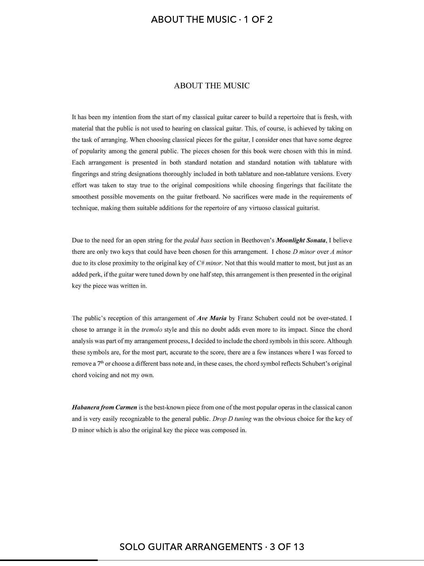

I looked at the sample of the book from Amazon. Unpacking the file with KindleUnpack gave me a collection of images for each page. I stuffed the images into an epub file using Sigil and added one image with a svg wrapper per xhtml file. Pretty much a minimal effort conversion.
Looking at the file I created on my Kobo Sage, one reason that this book is not available on eInk Kindles is that the text size (looking at About the Music) is below 4mm. Looking at the margins on the pages, the images could be trimmed to improve the text size.

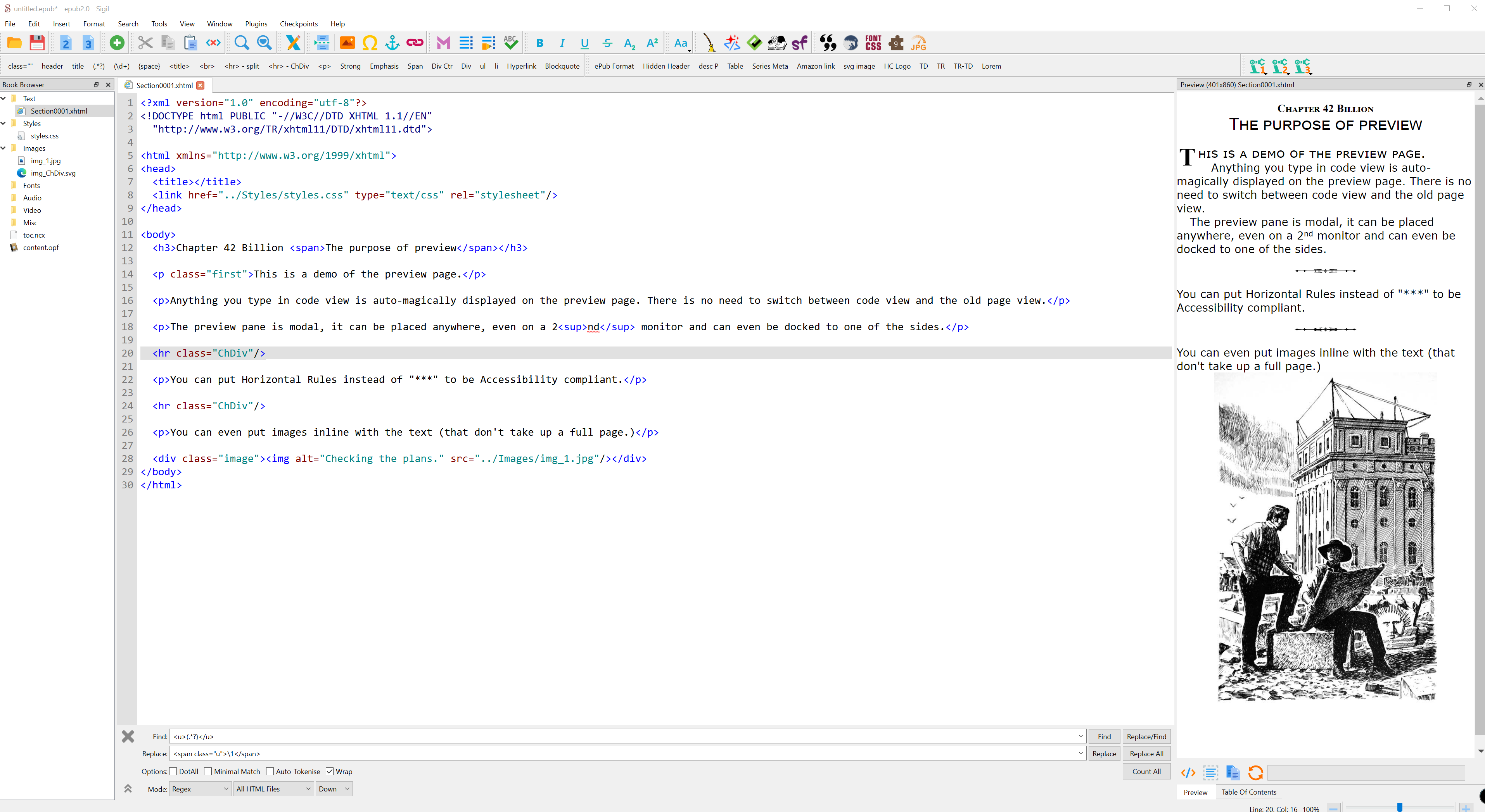

The function you are looking for in Sigil is called "Preview". It is a window that gives you instant visual of what you are typing in the code view window. It is 1000000001% better than the old page view that was very buggy and caused some bad code to be generated unless you were very knowledgeable about the subject. e.g. The current version is much better for newer users.
The only difference you need to be aware of from the directions on that video are instead of double-clicking on the page tab to switch between code view and page view, just hit the F10 key (or click on View/Preview in the menu) to bring up the preview window. Then you can dock it to the side, or keep it modal and place it anywhere, even on a 2nd monitor. When you close and reopen Sigil it will remain in its previous position.
PeterT is referencing an optional companion software to Sigil which is a basic WYSIWYG text editor. You can use PageEdit, or any other 3rd party html editor via Sigil's 'Open With' functionality, but it is not required. If you designed your whole book (Awesome!) then you certainly either already have, or can easily learn, the basic html/css knowledge to work on Sigil's codeview page.... we're talking basic stuff like putting paragraph tags <p>...</p> around paragraphs to designate the beginning and end of a paragraph, or heading tags <h3>...</h3> to designate the beginning and end of your heading (like a chapter title). (see the attached image)
There are also some helpful guides/tutorials on MR's Wiki page that may help...just be aware that some info may be slightly outdated.

Yes, I saw your post. What, I think, you are missing is that ALL ePub format books are made of html (actually xhtml but that doesn't really matter) and css even if your book is nothing but images.
The image files themselves are simply a 'resource' in the ePub that can be used throughout the book multiple times with different sizes, shapes, display regions, etc. As DNSB mentioned, you may want to trim your images to get rid of those massive margins...that's just wasted image space making your image files (and overall ePub) much larger than it needs to be. You can (and should) let the user set their own margin sizes on their own device/app based on their own preferences.
The html file is the actual 'paper' that you put the image on...these are the pages the user looks at. You could have a million images in the ePub but if they aren't referenced from an html page, with html code, then you would never 'see' them.
The css file is the resource page that lists all the information on HOW you want to display your image, paragraphs, etc. - How do you want to make it look... Do you want the image to have a pretty red border, a pink background, be really narrow but really tall, take up the whole page or just a portion of it, be on the right/left/center of the page, etc.
That old version (0.9.2 in the video I think) of Sigil used the WYSIWYG PageView that would put the html/css codes into the book for you...but it was often wrong, or created bugs that would be even more difficult to fix than just doing it by hand in the first place. The newer versions of Sigil removed that buggy function and replaced it with something much better.
The error that you were receiving was likely because you had your cursor somewhere that it couldn't be. Image references need to be in the 'body' of the document, not in the 'head' section; the cursor needs to be between the <body> and the </body> tags. Ideally you would put the image within some kind of element that you can style as you wish, such as a <div>.
The references and tutorials I linked in my previous post take a couple hours to look through...but it is time WELL spent. It will save you sooo much time because you won't have to try and find the step-by-step tutorial (that doesn't exist) walking you through how to do every little thing you want to do. YOUR book requires VERY basic html/css because it is just a bunch of images. The attachment image I had shows one option of inserting images onto a page...there are others.
