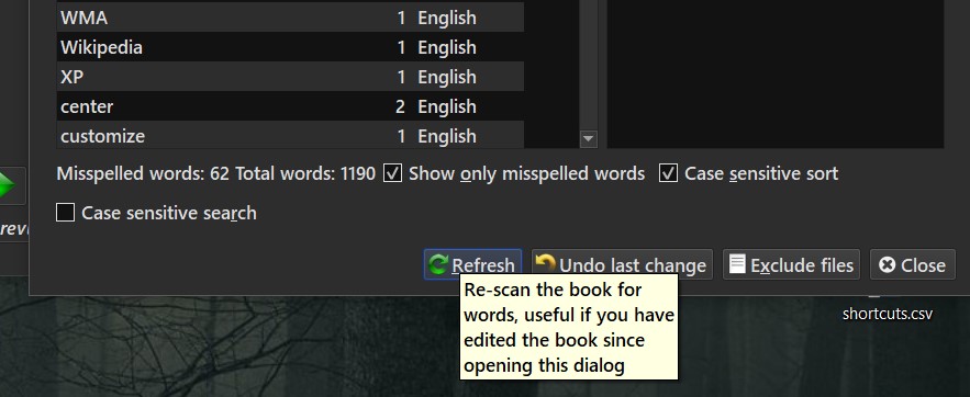

Posts: 22,255
Karma: 30317706
Maybe this is why Kovid put this in ebook-editor:
Name:	Screenshot 2022-01-24 124029.jpg

Which is exactly what Sigil's Refresh button does.
