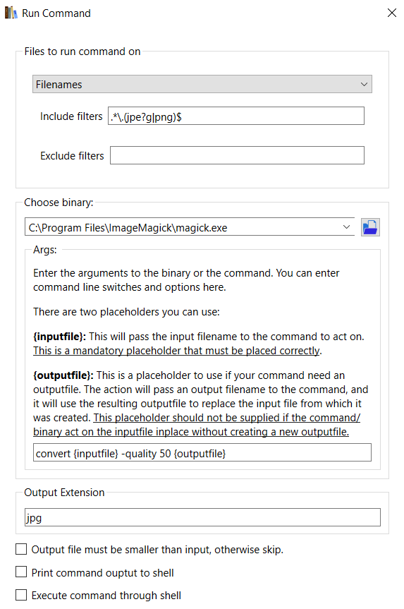

  • New Action "Run Command"
This action allows you to run a command on files inside the book. To better illustrate this I will give an example of chain I made which uses ImageMagick convert command to convert jpg and png pictures to a lower quality jpg and changes the colorspace to gray. The action will run this command for the selected files, and replace them with the resulting files. Below is a screenshot of the configuration for this action.
Notes:
  • You must have the commmand installed on your system.
  • Note the use of the placeholders: {inputfile}, {outputfile}.
  • If the resulting output files are of different extension the input files as in the example in the screenshot, you must specify the output extension so that it is appended to the {outputfile}. Also the original filenames inside the book will changed to reflect the new extension.
  • The configuration gives you the option to specify what files to include or exclude. Note that I included all png and jpg images except those that contain the name cover.
  • Using the combination of Action Chains and Editor Chains, you can run this action on multiple books. Refer to the first post of this thread for more on how to combine the two plugins.

But I have ImageMagick installed correctly (although my knowledge of its use is zero) on Windows 10.
I have copied your screenshot as it is and the thing does not work.
I'm guessing it has to do with {inputfile} and {outputfile}, and it would be great if you could tell me what to do.
Thanks in advance.

Unfortunately I cannot test on Windows. A quick search suggests that maybe the command on Windows should be:
magick convert path/to/input/image -quality 80 -colorspace gray /path/to/output/image
If the above command does not work on Windows, then the problem is not in the plugin and you have to figure the right command yourself.
If the command runs successfully on your machine, run it in Editor Chains and post the debug log. You can run the editor in debug mode using the following command:

Unfortunately it doesn't work with the new command either.
Attached (in case it is of any use) the debug log.
Thanks again for the try.

Editor Chains: Starting chain: Comprimir imágenes
Editor Chains: Comprimir imágenes: starting action No. 1: Run Command
Command error: Return code is 1 when running command for file: OEBPS/Images/autor.jpg
Command error: Return code is 1 when running command for file: OEBPS/Images/Figura_01.jpg
Command error: Return code is 1 when running command for file: OEBPS/Images/Figura_02.jpg
Command error: Return code is 1 when running command for file: OEBPS/Images/Figura_03.jpg
Command error: Return code is 1 when running command for file: OEBPS/Images/Figura_04.jpg
Command error: Return code is 1 when running command for file: OEBPS/Images/Figura_05.jpg
Command error: Return code is 1 when running command for file: OEBPS/Images/Figura_06.jpg
Command error: Return code is 1 when running command for file: OEBPS/Images/Figura_07.jpg
Command error: Return code is 1 when running command for file: OEBPS/Images/Figura_08.jpg
Command error: Return code is 1 when running command for file: OEBPS/Images/Figura_09.jpg
Command error: Return code is 1 when running command for file: OEBPS/Images/Figura_10.jpg
Command error: Return code is 1 when running command for file: OEBPS/Images/Figura_11-1.jpg
Command error: Return code is 1 when running command for file: OEBPS/Images/Figura_11-2.jpg
Command error: Return code is 1 when running command for file: OEBPS/Images/Figura_12.jpg
Command error: Return code is 1 when running command for file: OEBPS/Images/Figura_13.jpg
Command error: Return code is 1 when running command for file: OEBPS/Images/Figura_14.jpg
Command error: Return code is 1 when running command for file: OEBPS/Images/Figura_15.jpg
Command error: Return code is 1 when running command for file: OEBPS/Images/Figura_16.jpg
Command error: Return code is 1 when running command for file: OEBPS/Images/Figura_17.jpg
Command error: Return code is 1 when running command for file: OEBPS/Images/Figura_18.jpg
Command error: Return code is 1 when running command for file: OEBPS/Images/Figura_19.jpg
Command error: Return code is 1 when running command for file: OEBPS/Images/Figura_20.jpg
Command error: Return code is 1 when running command for file: OEBPS/Images/Figura_21.jpg
Command error: Return code is 1 when running command for file: OEBPS/Images/Figura_22.jpg
Command error: Return code is 1 when running command for file: OEBPS/Images/EPL_logo.png
Command error: Return code is 1 when running command for file: OEBPS/Images/ex_libris.png
Editor Chains: chain (Comprimir imágenes) finished in: 0:00:00.385428

That's a problem with running the command on Windows. I suggest you open the Windows command line (cmd) and run this command on a test image:
Take whatever error messages arising from the command to the ImageMagick forums to get help on what went wrong.
Once you get the command working on Windows command line (using cmd.exe), we would be able to investigate whatever problems arises with the plugin.
capink is offline   Reply With Quote
Old 09-01-2023, 04:37 AM   #28
jbacelar
Interested in the matter
jbacelar ought to be getting tired of karma fortunes by now.jbacelar ought to be getting tired of karma fortunes by now.jbacelar ought to be getting tired of karma fortunes by now.jbacelar ought to be getting tired of karma fortunes by now.jbacelar ought to be getting tired of karma fortunes by now.jbacelar ought to be getting tired of karma fortunes by now.jbacelar ought to be getting tired of karma fortunes by now.jbacelar ought to be getting tired of karma fortunes by now.jbacelar ought to be getting tired of karma fortunes by now.jbacelar ought to be getting tired of karma fortunes by now.jbacelar ought to be getting tired of karma fortunes by now.
jbacelar's Avatar
Posts: 422
Karma: 426094
Location: Spain, south coast
Device: Pocketbook InkPad 3
C:\Users\JB>magick convert path/to/input/wizard.jpg -quality 80 -colorspace gray /path/to/output/wizard.jpg
convert: unable to open image 'path/to/input/wizard.jpg': No such file or directory @ error/blob.c/OpenBlob/3569.
convert: no images defined `/path/to/output/wizard.jpg' @ error/convert.c/ConvertImageCommand/3354.
Instead with this one:
C:\Users\JB>magick convert wizard.jpg -quality 80 -colorspace gray wizard.jpg
It has worked perfectly.

both /path/to/input and /path/to/output are meant to be replaced with actual paths on your system. If you are doing this and the command is still producing errors, this would be some trouble with ImageMagick on Windows that I wouldn't be be to assist much with. Your best bet, as I said, would be the ImageMagick forums, because for the plugin to work with command, it must accept the full paths.

I'm getting the same issue too (Windows 11).
I have tried running clean-css cli with both directly and with a bat script I made that takes a css file as an input, and neither do anything.
My error log shows the same thing, "Command error: Return code is 1 when running command for file: {insert file name here}"
