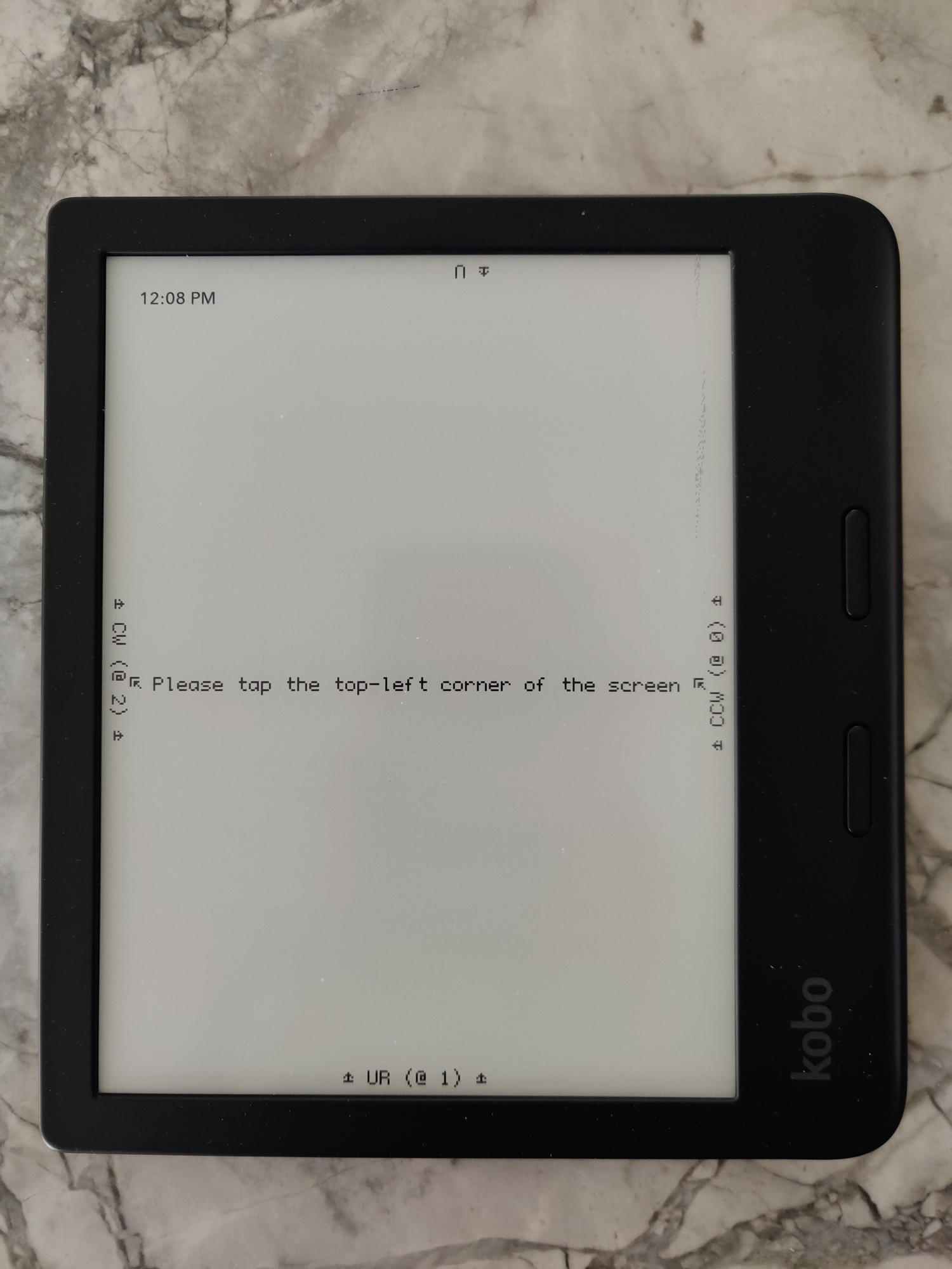

Photo attached.
Another random observation - when connected via USB, the Libra 2 identifies itself as product 0x4234 running Nickel and 0xdead running KOReader. I assume unknown devices are 0xdead to KOReader and the Libra 2 ID can be added to a mapping table somewhere.

@undecimo: Ah, that looks okay, thanks .
Does this behave in KOReader? (e.g., this latest fbdepth binary, and *NOT* disabling the x invert?).
As for the USB ids, that's to be expected, given that the USBMS tool hasn't been updated yet. It'll automagically behave once everything is merged .
