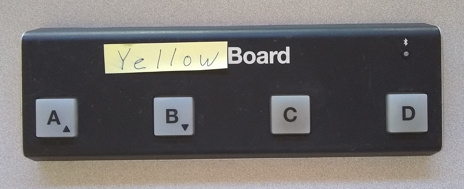

So, the next chapter of the saga...
I want to make my own clicker. I ordered some cases, they are the Serpac CA-4-4B (4 button). I was quite pleased when they showed up. They have 4 buttons in a weird Klingon-ish pattern but widely spaced. I think this will be a big improvement on those 5-way switches that are so tiny and it's easy to hit up and right at the same time. This is just the case, I'm working on the PCB.
The software is all working out well. I also retrofited an iRig BlueBoard and I'm quite pleased with it. I don't need to use a translator app to make it work with things and the button backlight is easier to turn on with a press on the outer two buttons (instead of having to go to some app and hit a slider).
Edit: So I did the board design, hit Enter and now the design is at the fab. I hope it gets here soon.

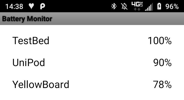

They do make it tough to check the battery on your Bluetooth devices.
Android was late to the game and they initially made checking of the batteries in your Bluetooth headphones years after Apple. They weren't thinking much of keyboards or mice or anything else. In the Android stock Settings you can click on a Bluetooth device and if it's a headset that takes phone calls it will display the battery level. Why can't it be a headphone that you only use for playing music or why not a keyboard? The devil only knows. In the latest Android source it should support everything else but it's not in the 3.1 software on my Poke 3.
There is an app (which I haven't even tried) called BatOn which should work. Why do we even have to have separate apps for what should be in the OS? Ok, so I wrote my own stupid app instead. It works fine for my stuff (i.e. stuff I wrote firmware for) but not for a commercial headset, a keyboard and a clicker. It's not clear if they are simply missing BAS service (the service that reports battery level) or what.
(The TestBed is at 100% because it's running on a power supply.)
