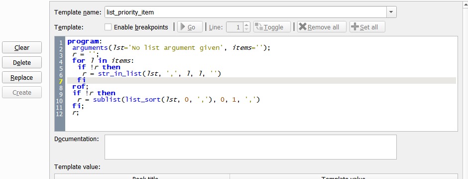

Question: Could a stored template be used to share the same code between a column icon and emblem?
I saved some templates I have in both places (reading_status, kobo_status, and format_icons) but I am not quite sure how to get them to work. The dialog says to use the 'call' function but I think I did it wrong as I just got an error about it being unknown.
Old 04-06-2021, 05:27 AM   #27
chaley
Posts: 12,529
Karma: 8125420
Location: Notts, England
Yes.
The documentation is wrong. I will fix it.
You use a stored template just as you use a template function, stored_template_name(args).
If you update source you will see some improvements in the stored template dialog. The most important is there is now a "test" button that opens a subsidiary template tester so you can try the stored template(s) without leaving the preferences dialog.
Example of definition and use of a stored template:
Definition:
The program text:
program:
	arguments(lst='No list argument given', items='');
	r = '';
	for l in items:
		if !r then
			r = str_in_list(lst, ',', l, l, '')
		fi
	rof;
	if !r then
		r = sublist(list_sort(lst, 0, ','), 0, 1, ',')
	fi;
	r;
How to call it
program: list_priority_item($tags, 'foo')

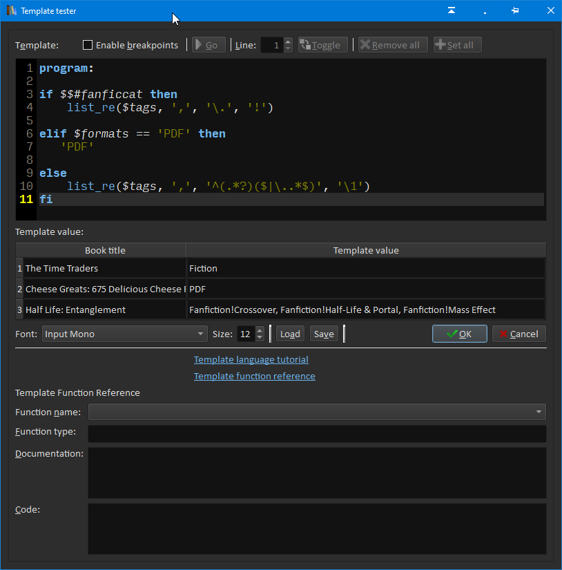

How do I escape a forward slash? the first if of this statement isn't working for me. I tried adding a second slash to escape it but it errored too.
program:
if $$#fanficcat then
    list_re($tags, ',', '\.', '!')
elif $formats == 'PDF' then
   'PDF'
else
    list_re($tags, ',', '^(.*?)($|\..*$)', '\1')
fi
Also, how would you apply a sublist of just first item to the list_re? See the third item in the screenshot. I tried enclosing it but I broke it. This is for my #kobopath composite for a save template.
