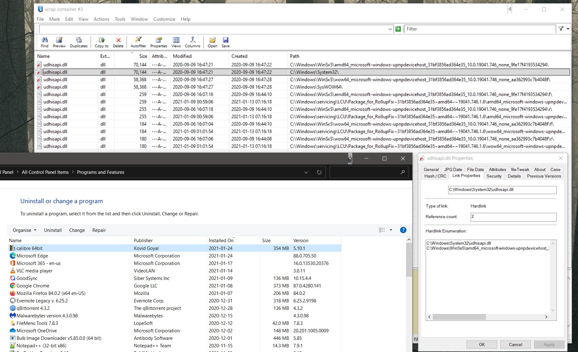

I wonder, though, what change was made so at least two antiviruses are flagging it.
VirusTotal notes that calibre.exe does write to a file inside of the Windows folder (udhisapi.dll, universal plug & play), which may be seen as a red flag. But I think older versions did this too.
Really, did they say which udhisapi.dll, the one in System32 or SysWOW64?
Name:	Screenshot 2021-01-24 073959.jpg
I just installed calibre 5.10.1 and neither appears to have changed. My records show I installed Windows security update (KB4577266} on 2020-09-09 which is the date the udhisapi.dll files were last updated.
