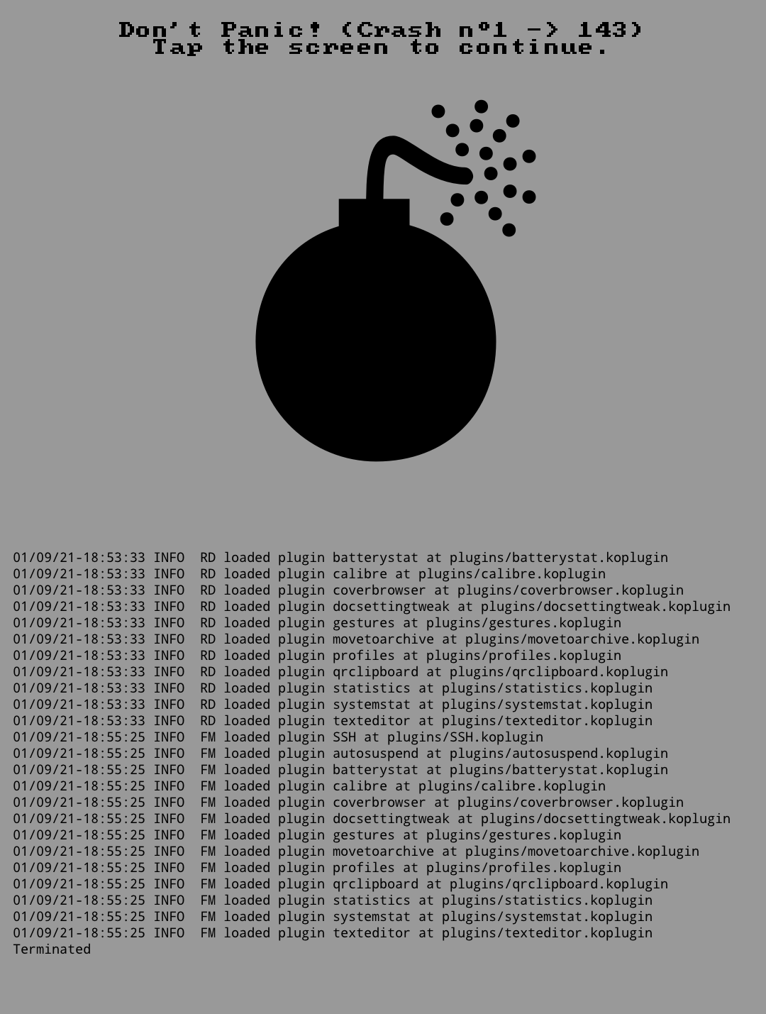

@Pajamaman: Stop. That's not a KOReader crash. You can tell, because KOReader hasn't, in fact, crashed .
That's what a (faked) KOReader crash looks like:
