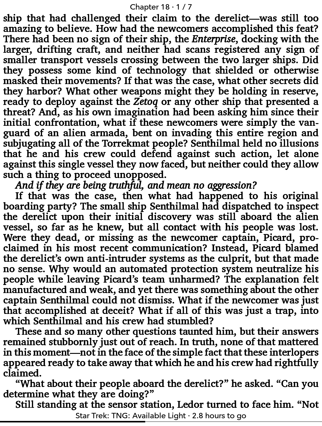

I go with what davidfor said. Plus, there are patches to change the size of the header/footer and the amount of space they take up. I have mine set to be smaller and the space is very minimal. Here is a screenshot of my H2O with the header/footer visible.
