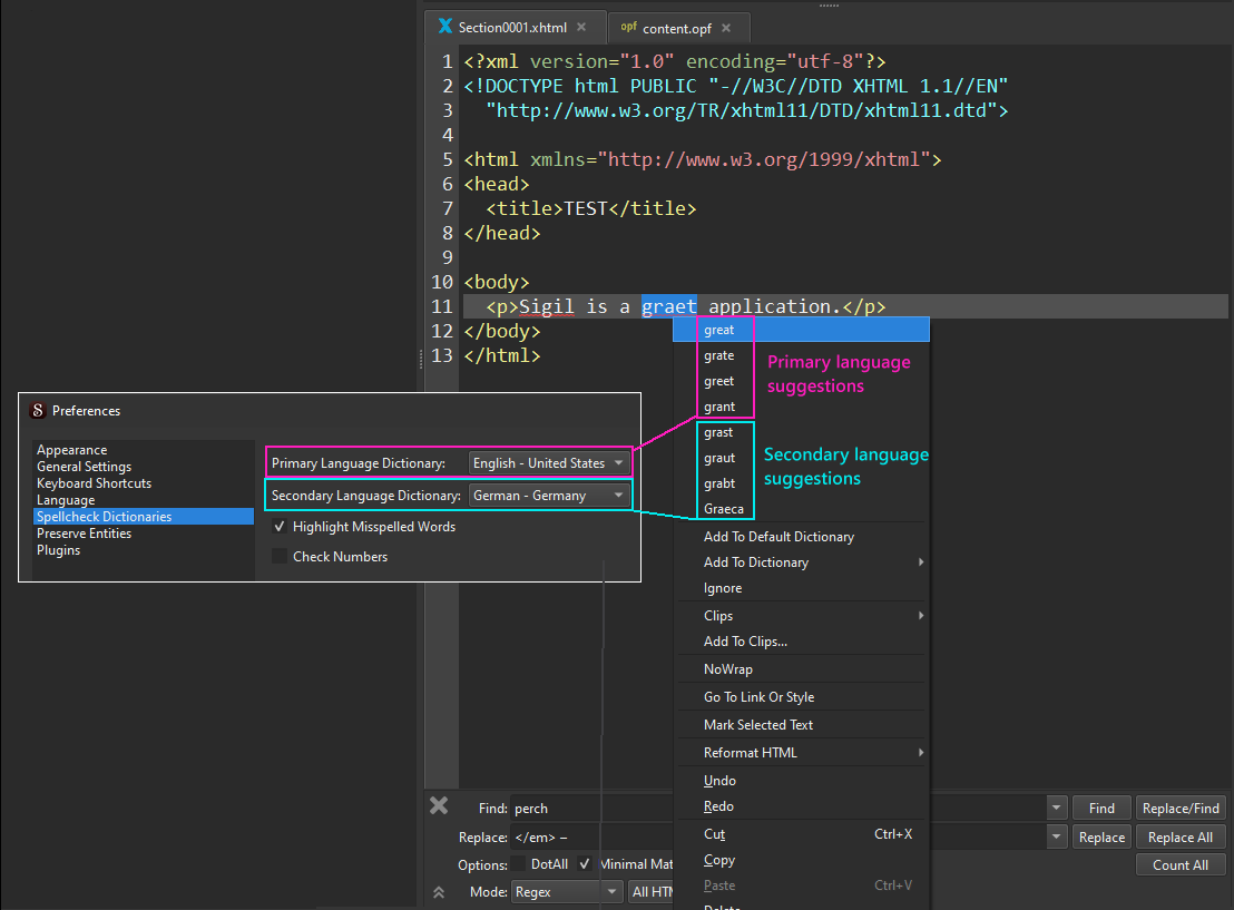

One more information for people who are learning about Sigil's possibilities. This picture explains how the primary and secondary dictionaries work.
