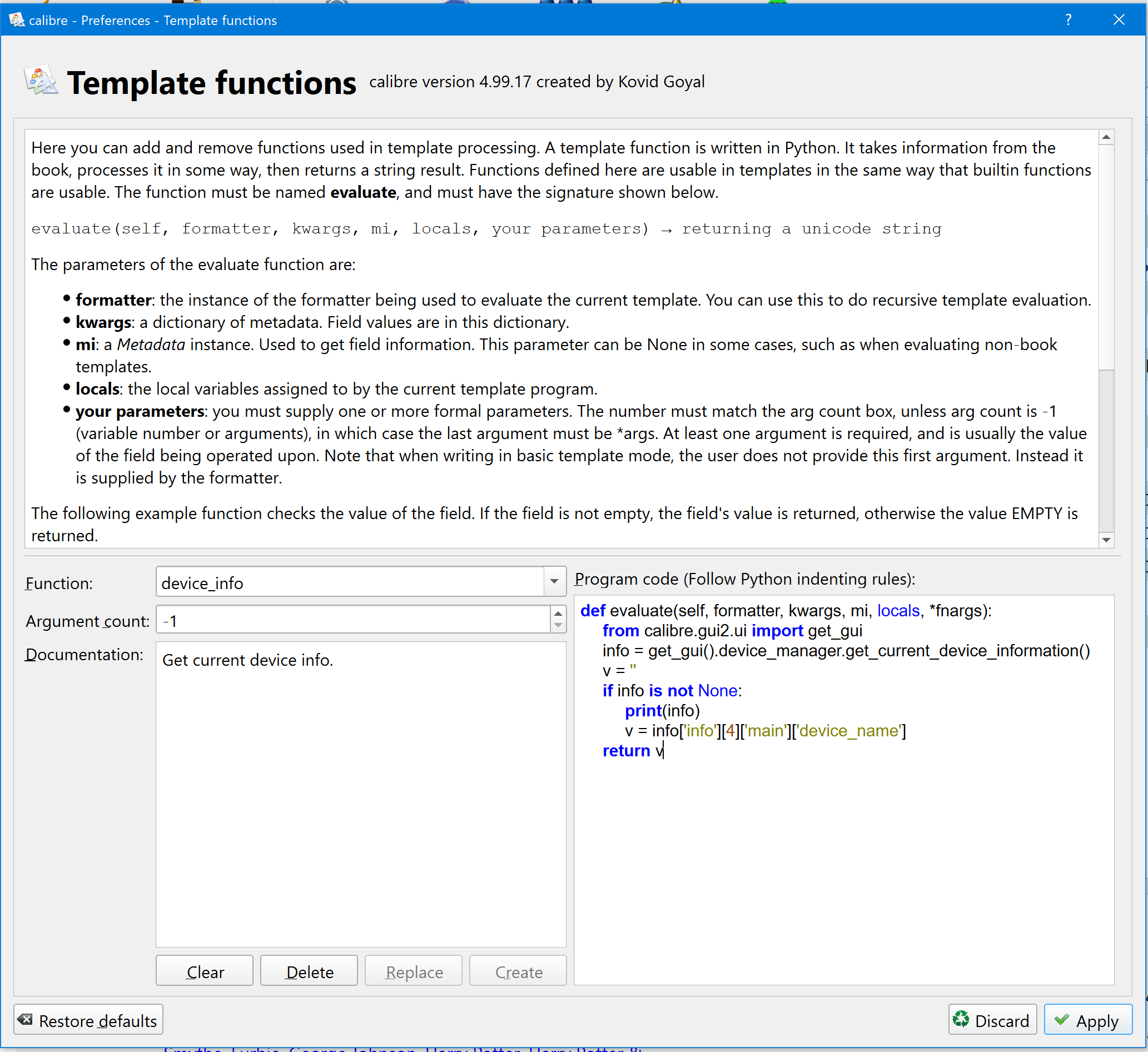

You can do the same thing in a custom template function. Example:
Does this answer your question?
Yes, thank you.
It's not polished, obviously, but this does what I wanted:
template function:
def evaluate(self, formatter, kwargs, mi, locals, *fnargs):
	from calibre.gui2.ui import get_gui
    dm = get_gui().device_manager
	info = dm.get_current_device_information()
	v = ''
	if dm.is_device_present and info is not None:
		print(info)
		v = info['info'][4]['main']['device_name']
	return v

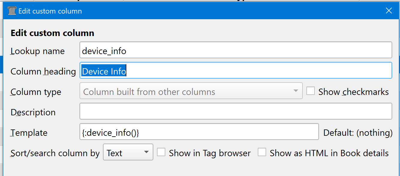

custom column template:
{:device_info()}
See attached screen caps for all the GUI settings.

Name:	custom column.PNG
ID:	182048   Click image for larger version
Name:	template function.PNG
