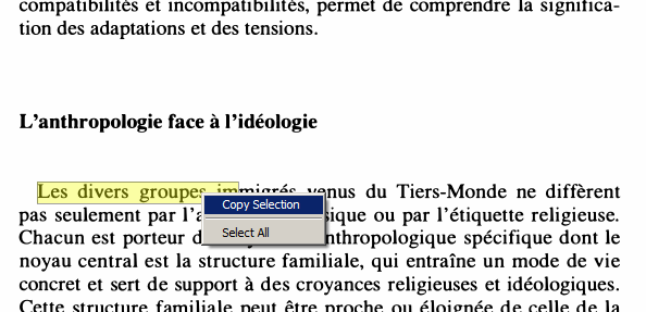

This time, I'm trying to convert a PDF to EPUB.
Lucky me, gImageReader says: "PDFs with text: These PDF files already contain text".
Indeed, when opening the file in Windows, the text is copy/pastable with the mouse, so it's not scanned images.
FWIW, here's what cpdf says about it:
XMP pdf:Producer: Adobe Acrobat 10.0 Paper Capture Plug-in with ClearScan
XMP xmp:CreatorTool: Canon
What would you recommend I do to turn it into an EPUB?

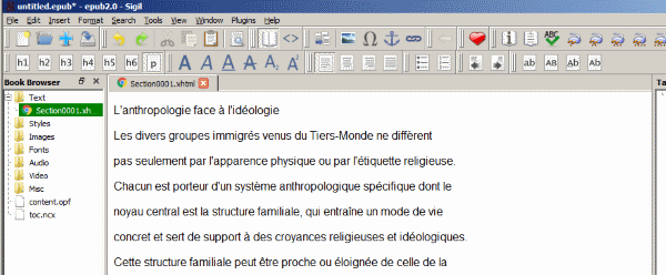

That's why it looked like scanned pages, but the text is still selectable like text PDF.
I'll play with Sigil and see if it's more convenient to build an EPUB than LibreOffice Writer. The mid-page carriage returns are especially annoying.
Transtools Unbreaker tool (Word Add in) can fix most of those, including when they're in tables

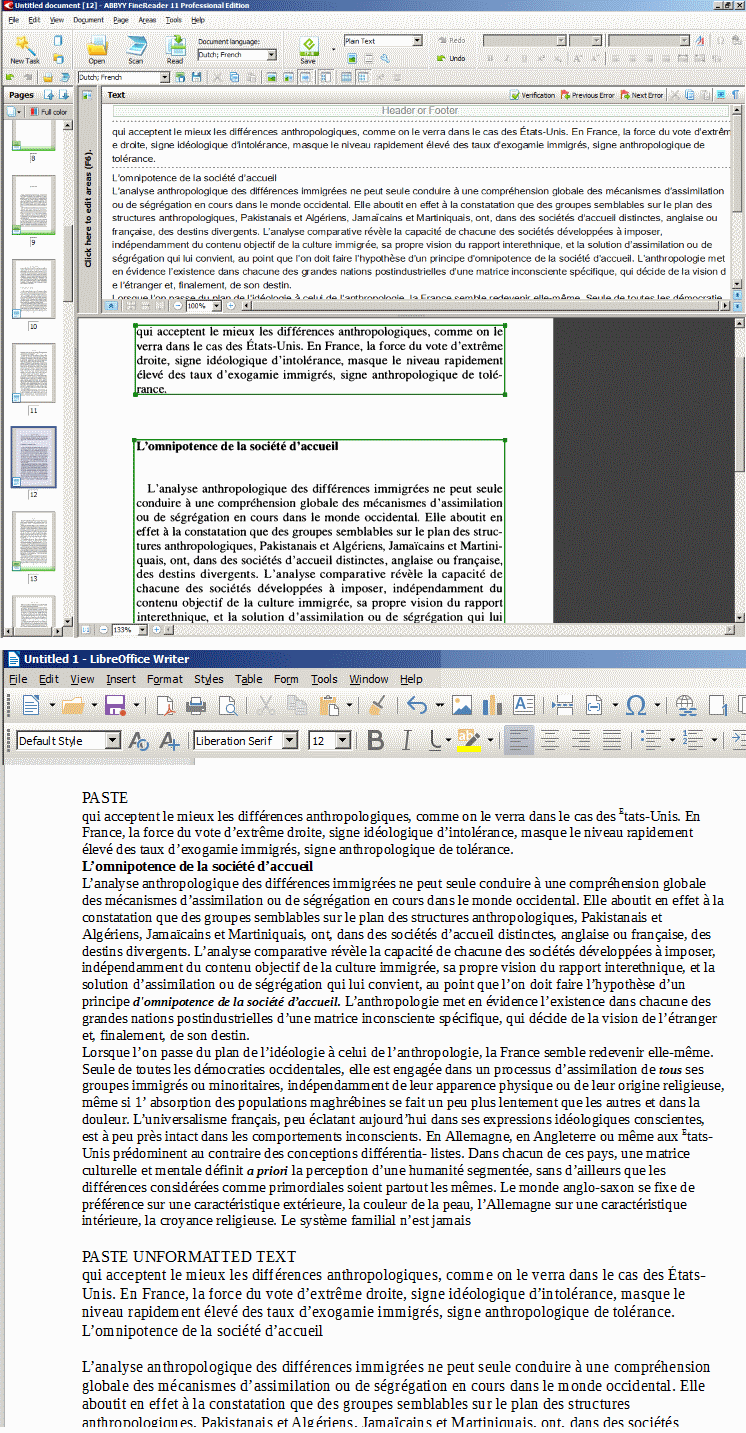

Edit: Opening the PDF in Abbyy FineReader does a pretty good job. Gone are the mid-sentence linebreaks (on a few test pages, at least).
An AutoIT script might come in useful to automate the process.
