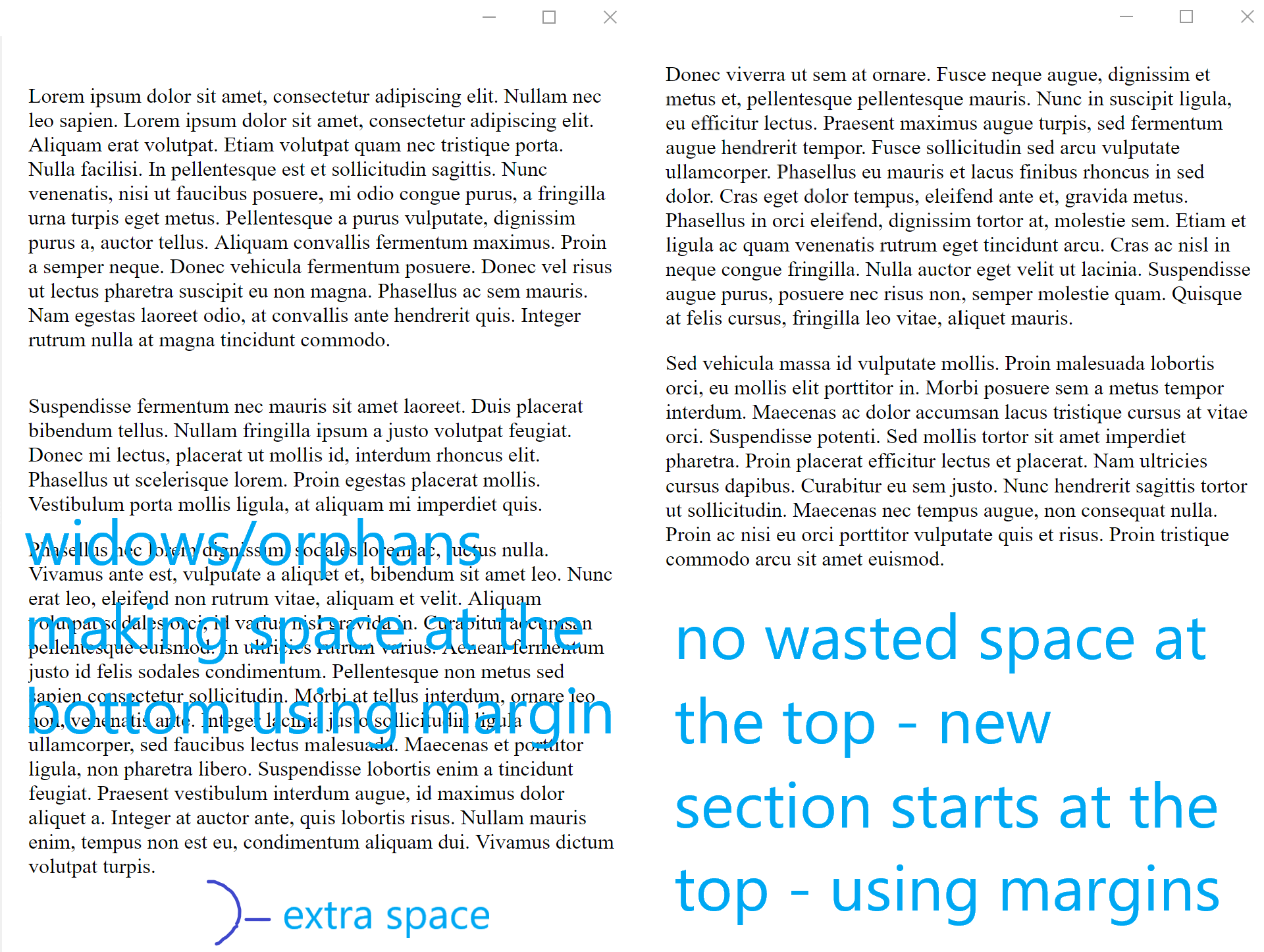

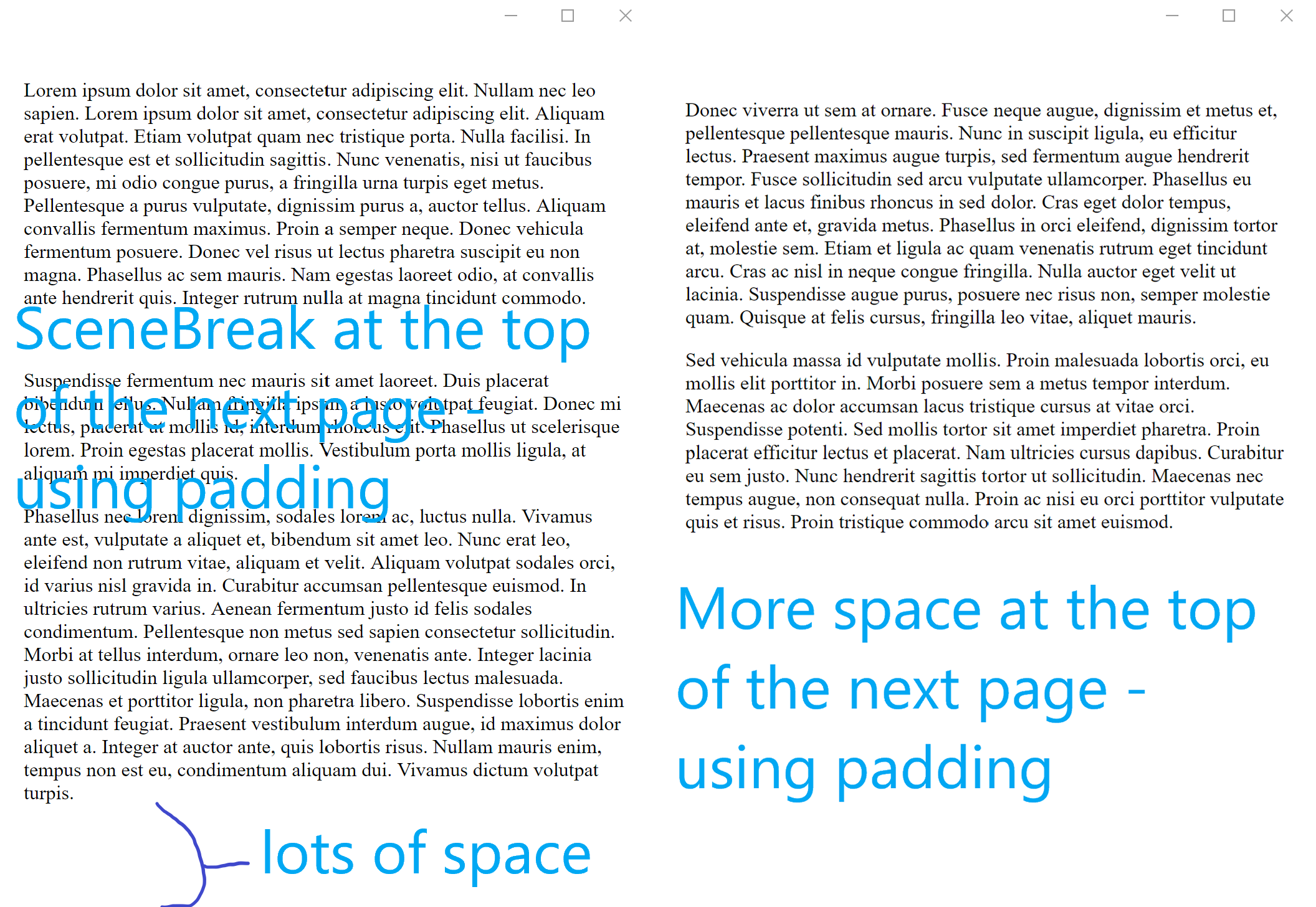

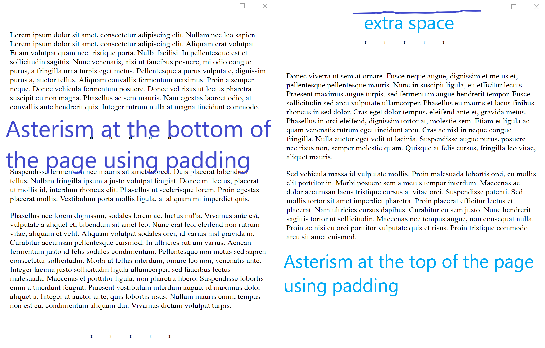

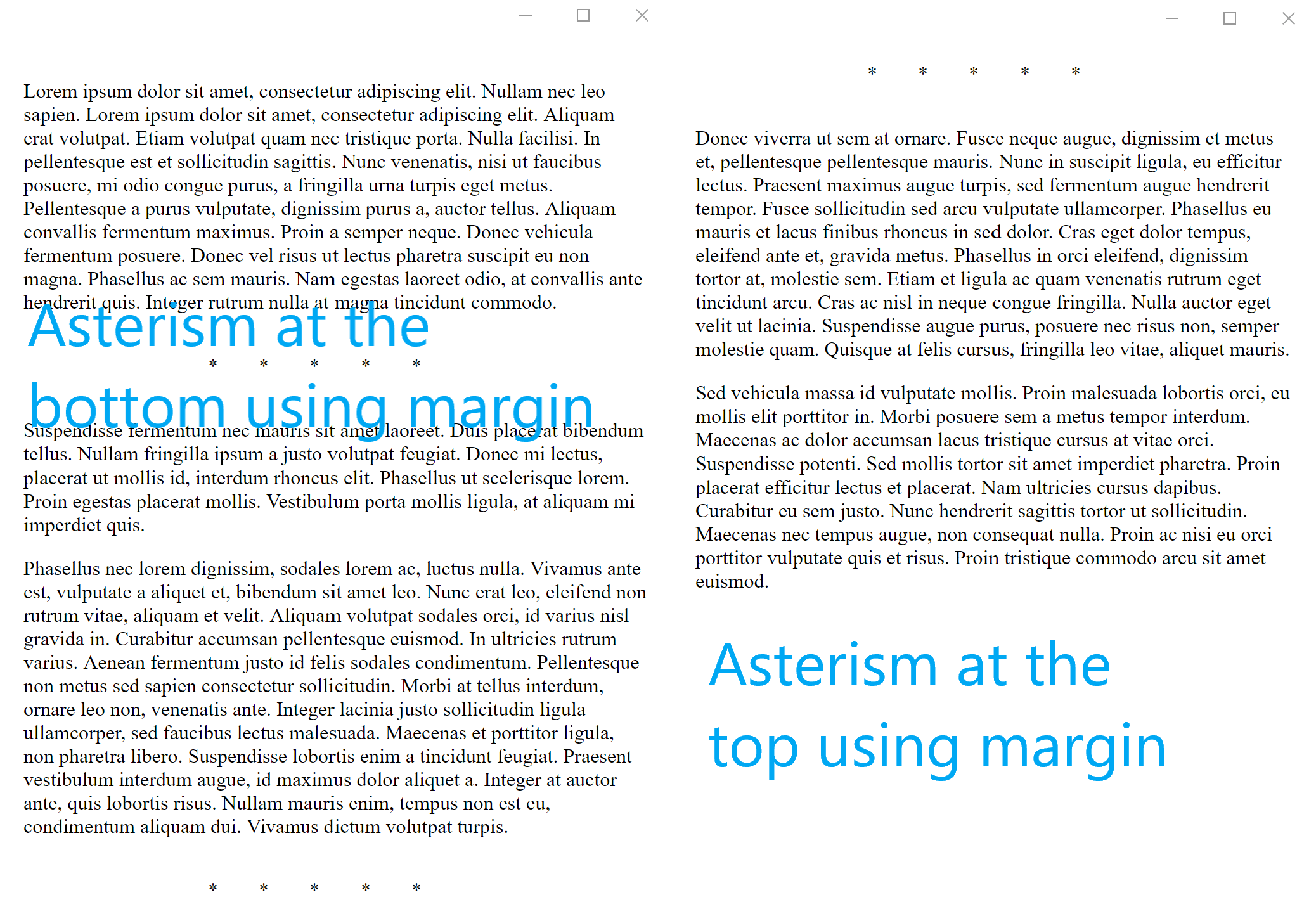

2. Empty space can be reliably done. I use padding-top: 2em and that works even if the section/scene break falls at the bottom/top of the screen. Plus, you should have the first paragraph of the new section be non-indented. Using margin-top: 2em is not reliable and doesn't work for the bottom/top of the page.
It's not correct to say padding-top is the best solution in all scenarios. The fact that padding is still honored at the top of a new 'page' doesn't mean the publisher (or reader) will want it to do that. Extra padding at the top of a new page is a "big waste of space" - as you so like to point out from Chapter headers - and is even compounded when you make use of the widows/orphans setting. As you know, using widows/orphans will push a paragraph onto the next page leaving a couple lines of empty space at the end of the first page plus a couple lines at the beginning of the 2nd page due to the padding-top.
Using margin-top will reliably put spacing between paragraphs in the middle of a page, and if it just so happens that the widows/orphans pushes the next paragraph to the next page (leaving space at the end of the previous page) it will NOT put even more space at the top of the next page. This is much cleaner, IMO, and doesn't waste the valuable reading landscape.
The other option, as others have mentioned, is to use an asterism of some kind all the time, either asterisks or a fleuron or something. You will still have the same issue of extra space being generated/wasted at the top of a page if you use padding...
I think it is appropriate to be aware of the pluses and minuses of both tools, and use the proper tool for the scenario presented. You don't need to push one tool over another.
Here are a couple of images to illustrate the point:
ID:	180353   Click image for larger version
ID:	180354   Click image for larger version
ID:	180355   Click image for larger version
Old 07-03-2020, 12:26 PM   #18
Posts: 85,442
Karma: 154365103
padding does work better then margin for blank space for section breaks. We cannot do what the pBooks do and put asterisks at the bottom of the page to signify a section break. So want to have the full space even if it wraps to the next page at the top. This lets us know it's a section break instead of widows and orphans.
For asterisks, margins work no problem.

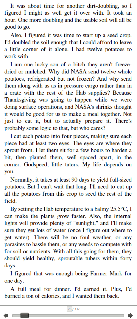

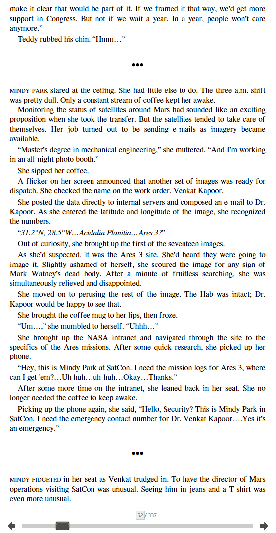

The simple gap+noindent also causes issues when the new scene starts at the very top of a page. You'll assume it's a continued/split paragraph from the previous screen.
I think the one I read all those years ago was Andy Weir's The Martian. I just checked, and they mix Chapters > Daily Logs > gap+noindent / 3 centered bullets •••:
ID:	180387 Click image for larger version
ID:	180388 Click image for larger version
Image 1 is the previous page.
Image 2, you can see the gap+noindent landing on the very top of the screen. No reasonable person would notice this. You would continue reading, then wonder why there was just a drastic change in scene/tone, become confused, MAYBE click back... and/or just continue reading.
Image 3 shows centered bullets in a later chapter.
Overall, not the best ebook decisions, and probably just replicated the Print formatting...
Nobody is reading the book at Image 1 and thinking: "Oh, that final word ends before hitting the right margin... the paragraph on next screen might start with no indent!"
Side Note: Also, another potential reason against gap+noindent is users may read with (*shudders just thinking about it*) left aligned or "block paragraphs".
