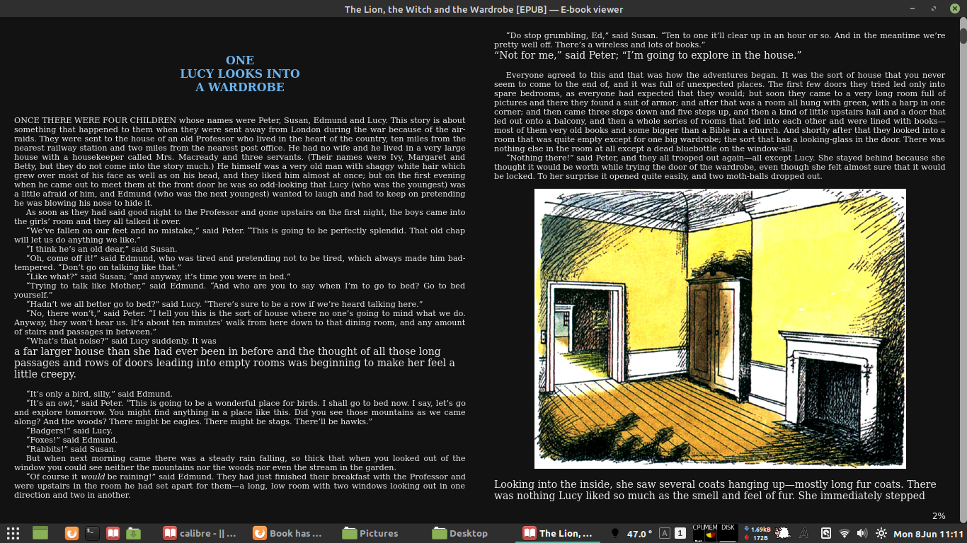

@droopy: Your images aren't comparing the same things. The images from the Kobo devices are for kepubs. The images from the calibre viewer are from viewing the epubs. If you were to open the kepub version in the calibre viewer, you would see the same problem as on the device.
You're right, davidFor. Here's the kepub version in the calibre viewer.
I've attached the same chapter from the Kepub. It ends in ".zip", but the real extension is ".xhtml". So please simply remove ".zip" from the filename.
Name:	Screenshot from 2020-06-08 11-11-29.png
File Type: zip 9780061974151_Chapter_1_from_Kobo_reader.xhtml.zip (19.5 KB, 120 views)

The problem is a bug in the released version of the kepub output plugin. It was also seen with the extended driver. Which was reasonable, as they share code. I posted a beta to fix the extended driver, with the explanation of what was causing the error. I wasn't going to release a beta of the output plugin as I was hoping for an official release of both. But, I have posted a beta of the output plugin in it's thread with the same fix.
Thanks, I see you have a newer beta in https://www.mobileread.com/forums/sh...&postcount=354. When I added it to my Calibre, it registers as 3.2.10
