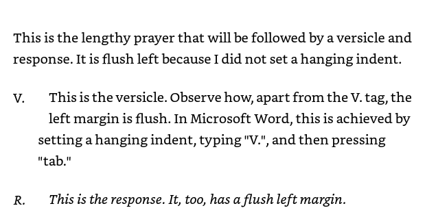

That does work with a large padding-left, but I think it works for the same reason that padding-left:4em works. If you reduce the padding, you get results like in the attachment—which is weird, because the padding is still more than the width of the V. element, so they shouldn't be interacting.
Name:	Annotation 2020-05-19 153332.png
Yes, I told that with a huge font-size ("9" or "10") there would be issues with the alignment. But who want to read with such a font-size? And with just padding, things can be different in portrait and landscape mode and different fonts can affect the alignment (4em can work for Bookerly but not for, i.e. Georgia).
