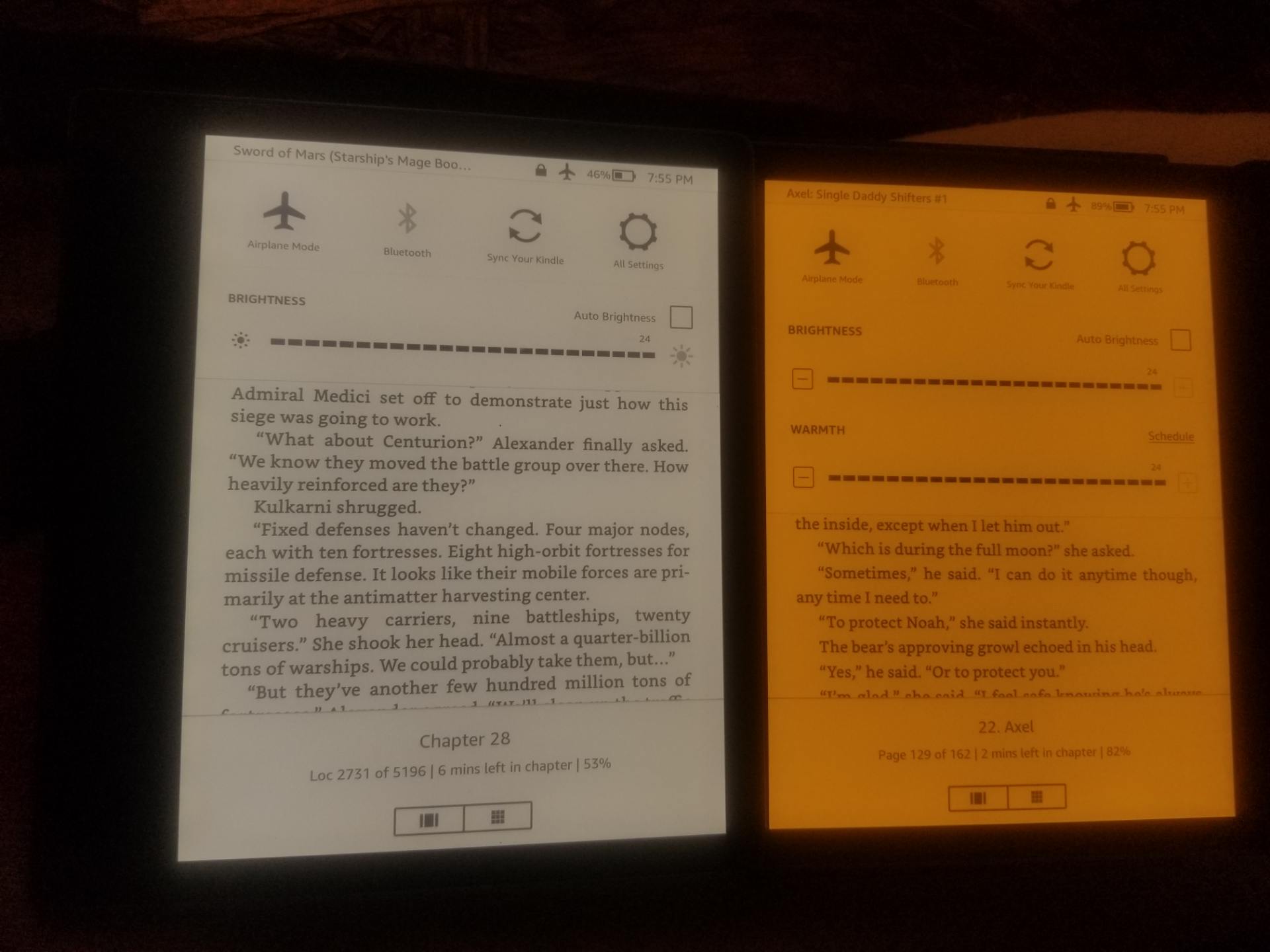

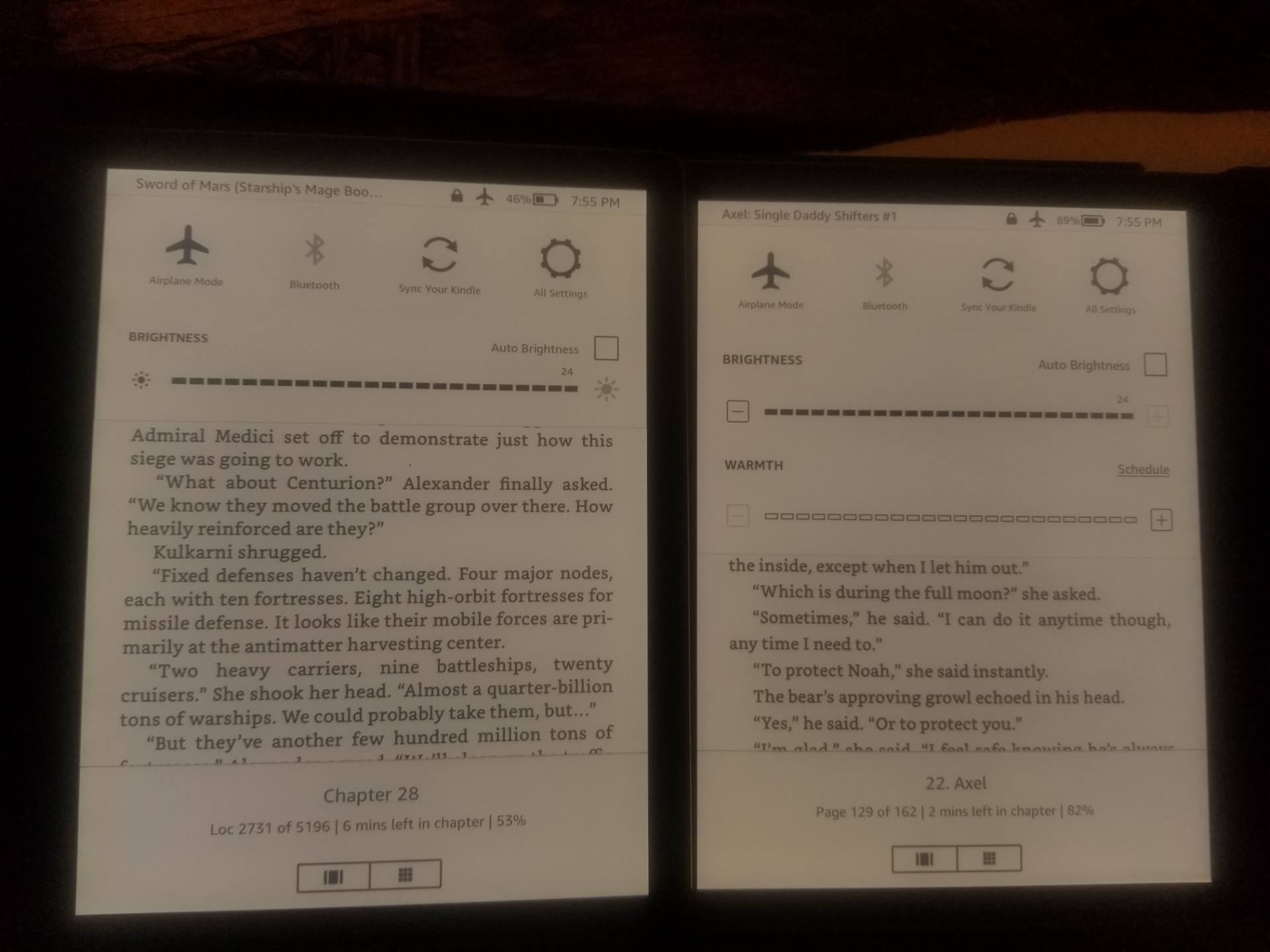

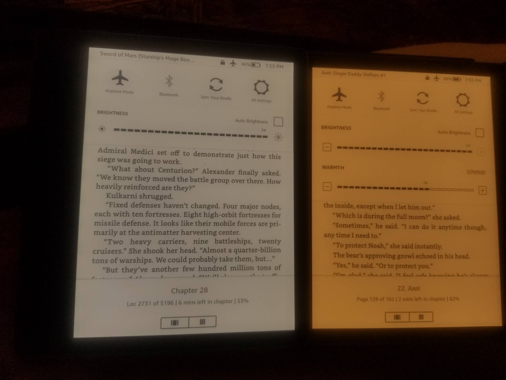

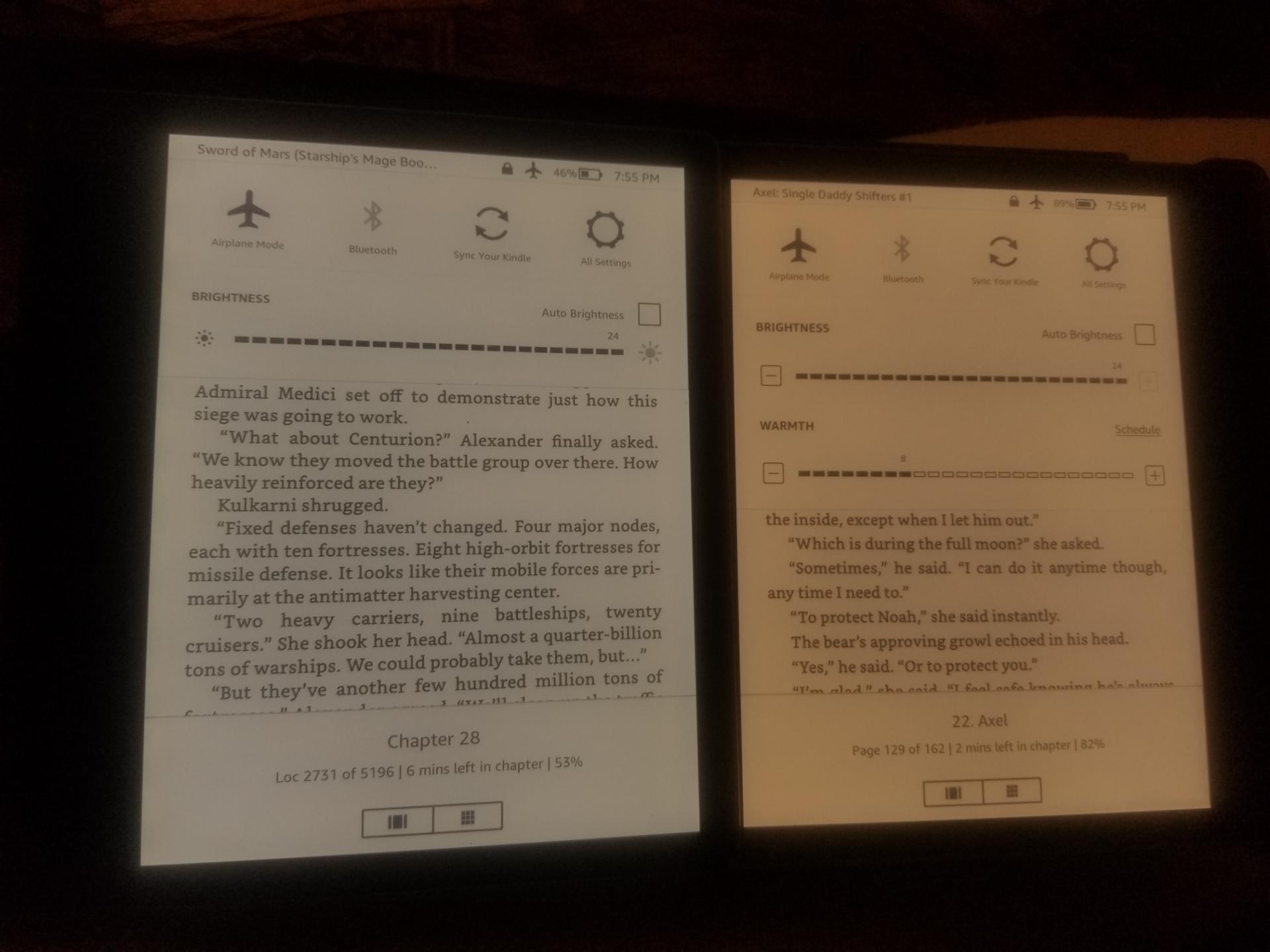

It appears that there is white leds without warm setting, and additionally yellow/orange added on top when warm setting is enabled. My Oasis 2 and the Oasis 3 look near identical without warm.
Attached are some pictures showing how warm setting changes at 0,8,16, and 24 setting. The Oasis 2 on the left as reference unchanged. To my eyes it looks more yellow in real life, but I chose manual white balance setting of 6600°. Not sure how to set my phone screen to 6600°, so that the picture matches. Otherwise with automatic white balance the Oasis 2 changes color as well.
