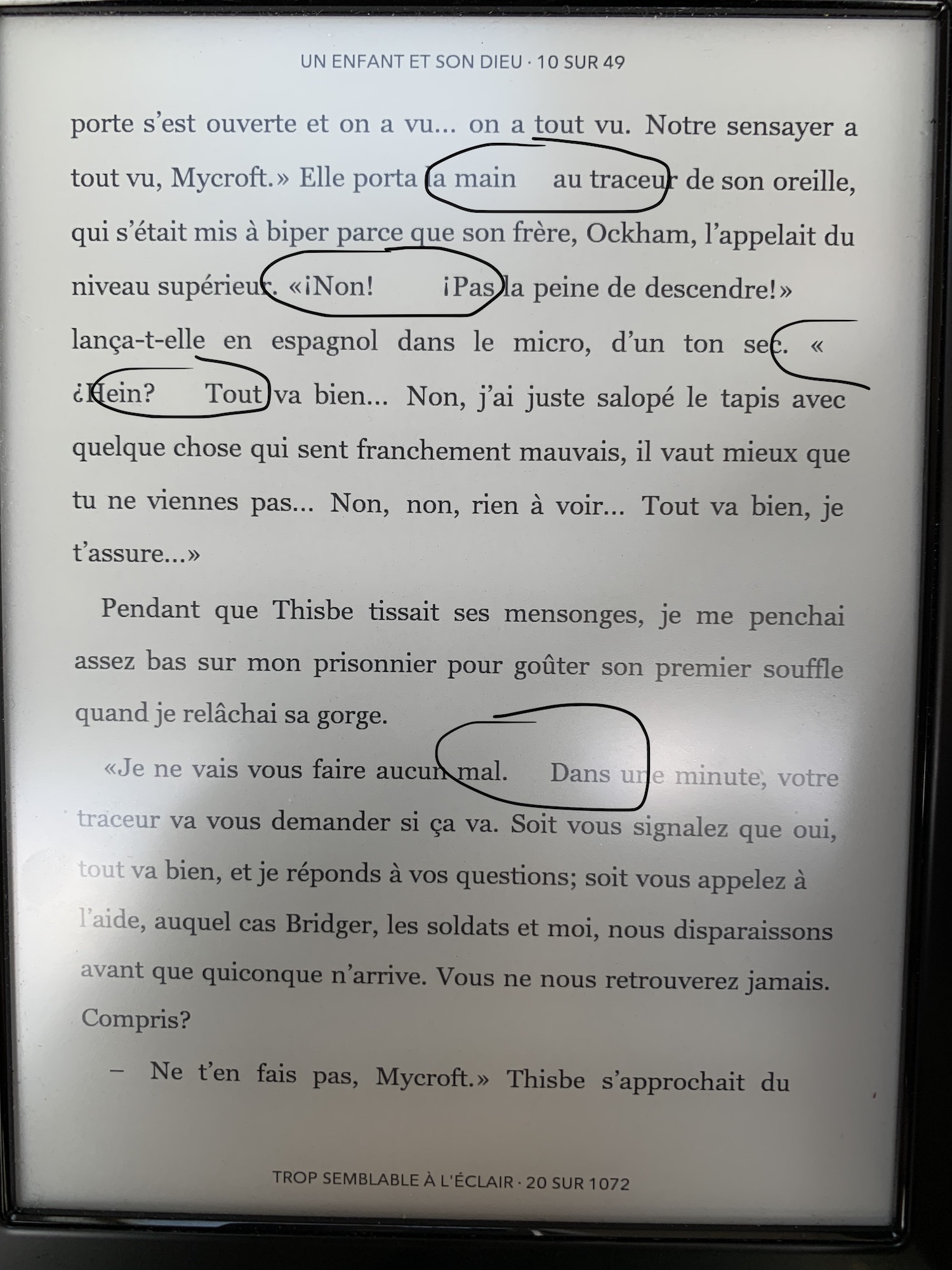

Hi JSWolf,
Thank you for your help.
I tried it too before asking for help. I explained it in my first post:
Originally Posted by wff View Post
I sent the original ePub to kobo, and there was no problem of display and spaces and other stuff. But I need Kepub, because I like to see the real page number even when I change font size or margins.
It is the way I read it for now, with ePub on my Kobo device. But I would really love to have it as KePub, to display the real number of pages when I change font size or margins.

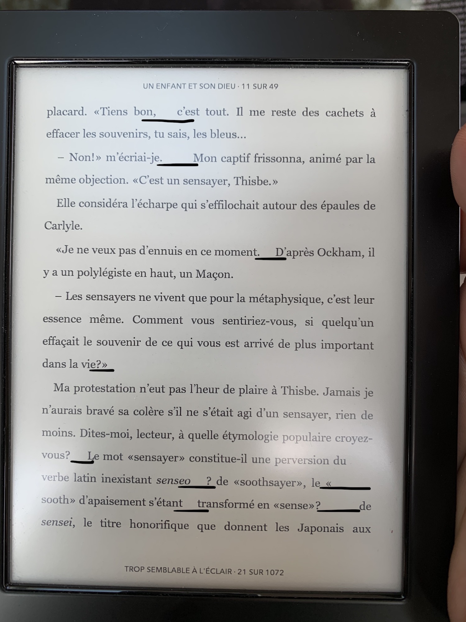

I noticed these thin spaces before and after some signs (like ! ? ; " ) and I was wondering if it was part of the issue, but as I am not used to epub code, I was not sure.
So I will try to search and replace, so hopefully I can get rid of the thin spaces. How could I proceed to manage leading spaces in paragraphs?
There has been a bit of discussion on how Kobo handles non-English punctuation like this. The conclusion is basically, "not very well". In this case, the extra spaces and line breaks in the book code is making it worse. But, they should be ignored. Or treated as a single space. And not justifying the text helps. Or probably just hides some of the errors. As @JSWolf pointed out, the RMSDK used for epubs appears to handle these better. But, I think it has other issues with this sort of thing. I don't remember what, I'm just sure it has come up in the past.

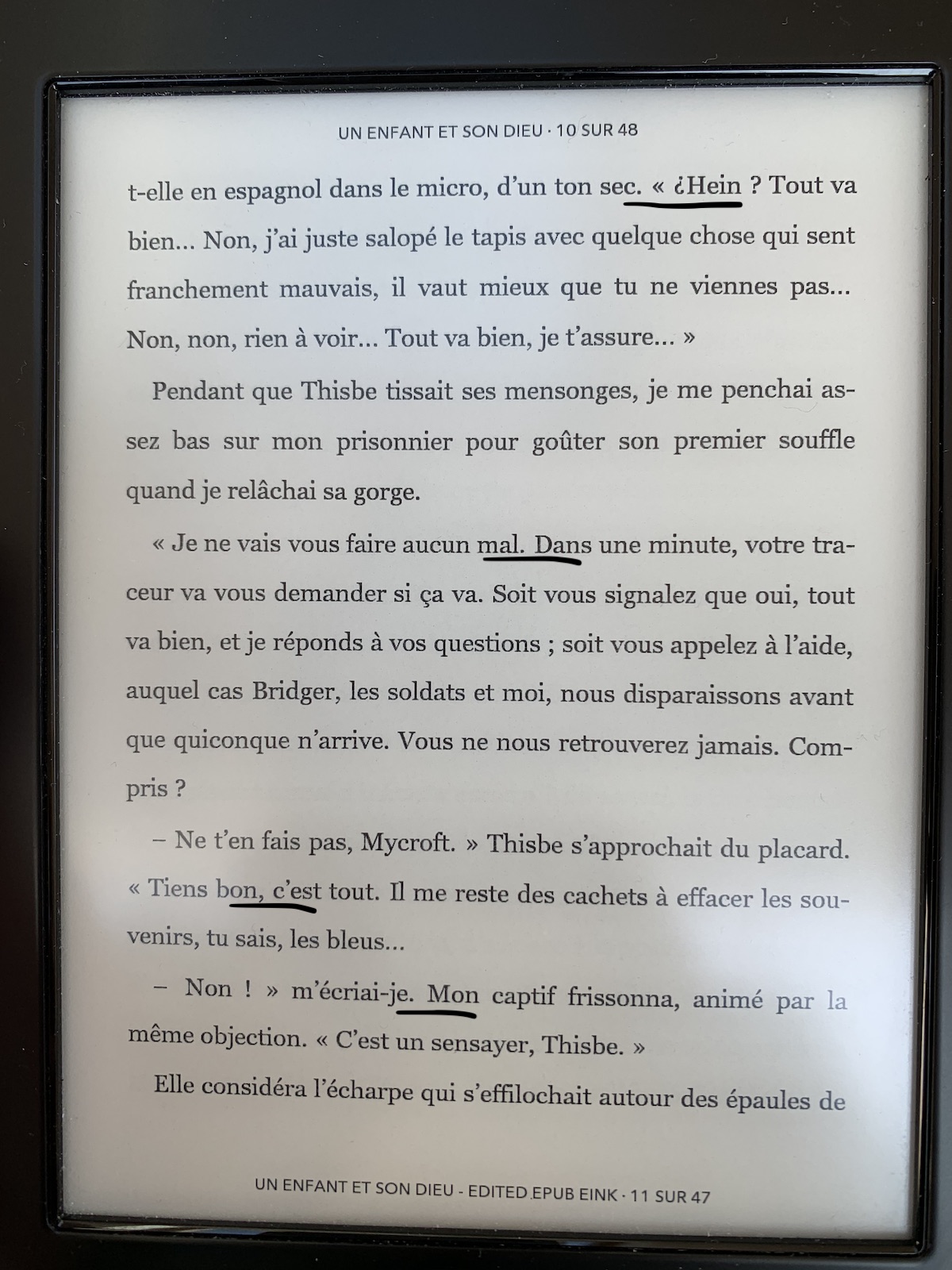

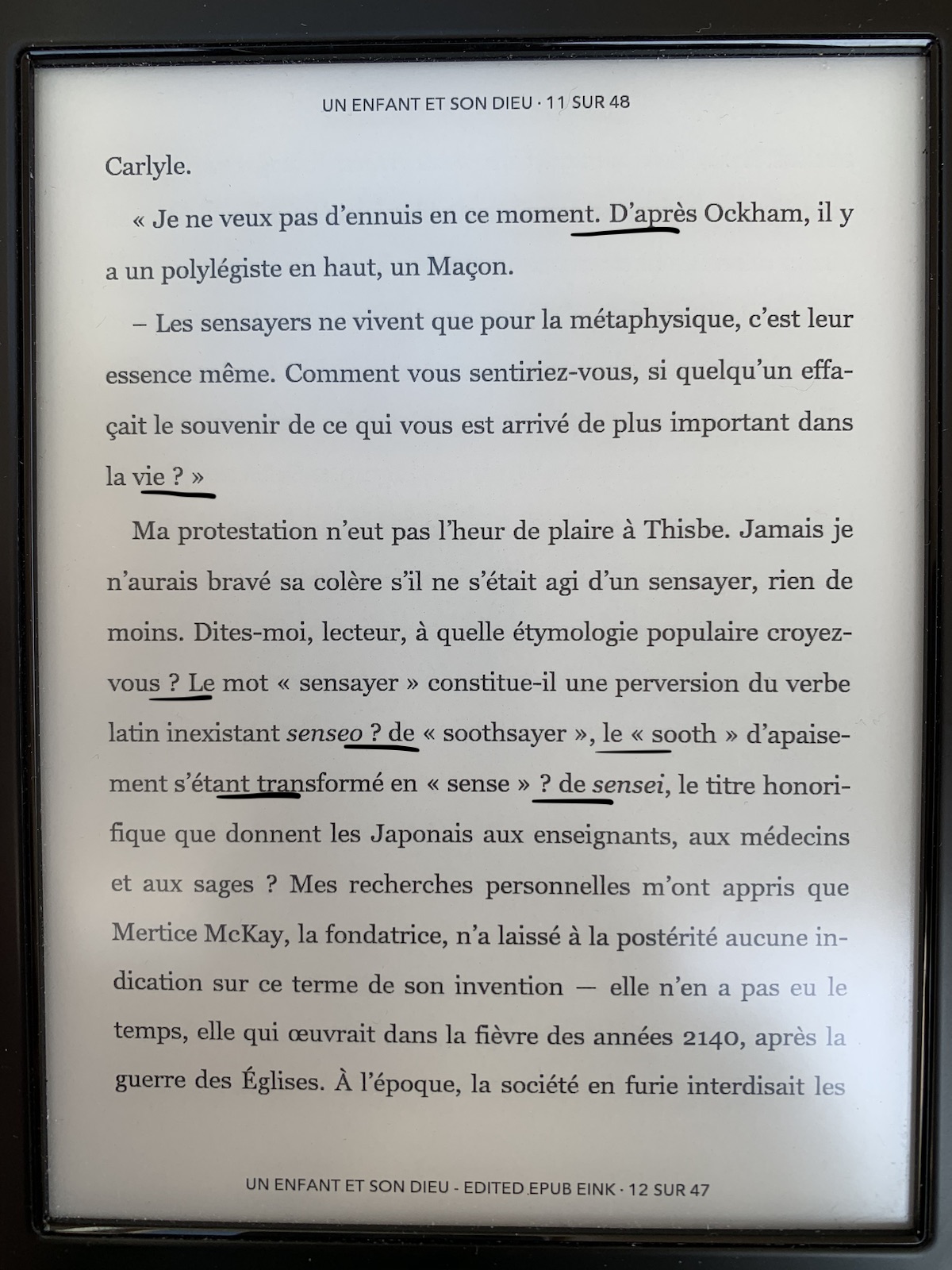

Bingo, guys, fix may be on its way :-)
It seems that thin spaces were responsible for my problem.
I performed several "search and replace" after copying epub code in TextEdit:
- EN DASH replaced with –
- THIN SPACE replaced with   (for each punctuation sign, like ! ? ")
- Extra spaces replaced with single space
It looks great until now, but I have fixed just one chapter... Lot of work ahead :-)
I took SS to show you.
Thanks again everyone! I will tell you if everything is ok once it's done.
