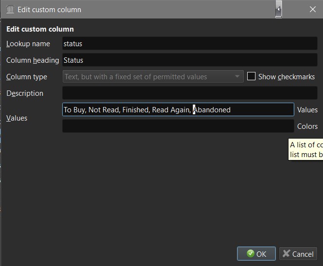

I would add another column, something like this:
Name:	Annotation 2020-04-13 081502.jpg

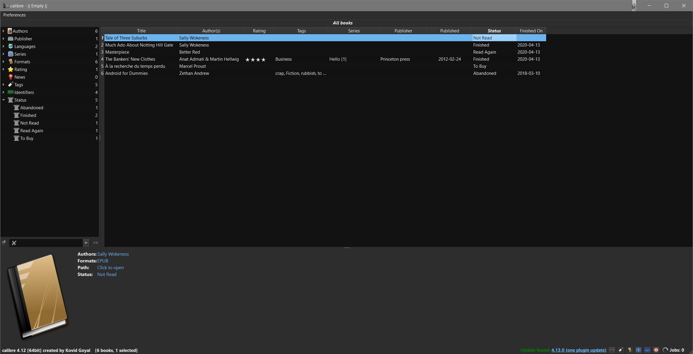

And I would arrange the book list something like this
Name:	Annotation 2020-04-13 083458.jpg
The number of books for each Status (To Buy, Finished etc) are in the Tag browser
When I added a book I would press F2 on the Status cell and set it to Not Read, when I finished reading the book I would press F2 on the Status cell and set it to Abandoned, Finished or Read Again, tab into the Finished On cell, press '=' to get today's date then press Enter.
The Status cells will have a drop down list, if you choose the allowable values appropriately you can just press the first letter - a.g A for Abandoned, R for Read Again etc
