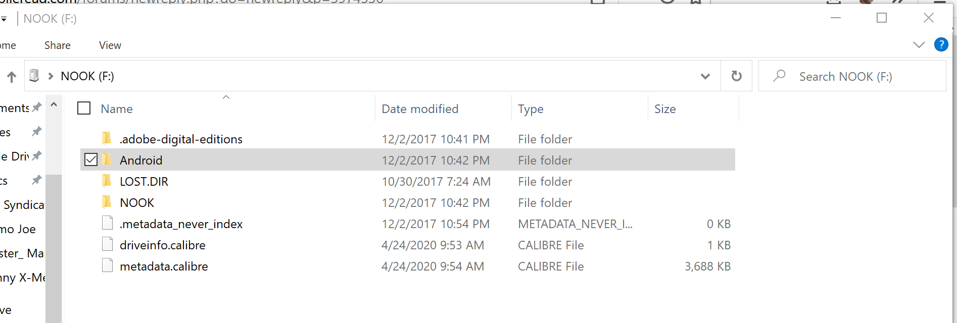

Did you ever get your Glowlight 3 sorted? It's way too late to be of any help I guess. But here is a screenshot of what I see in Windows Explorer when I plug in my Glowlight 3.
Name:	Windows Explorer - Glowlight 3.png
