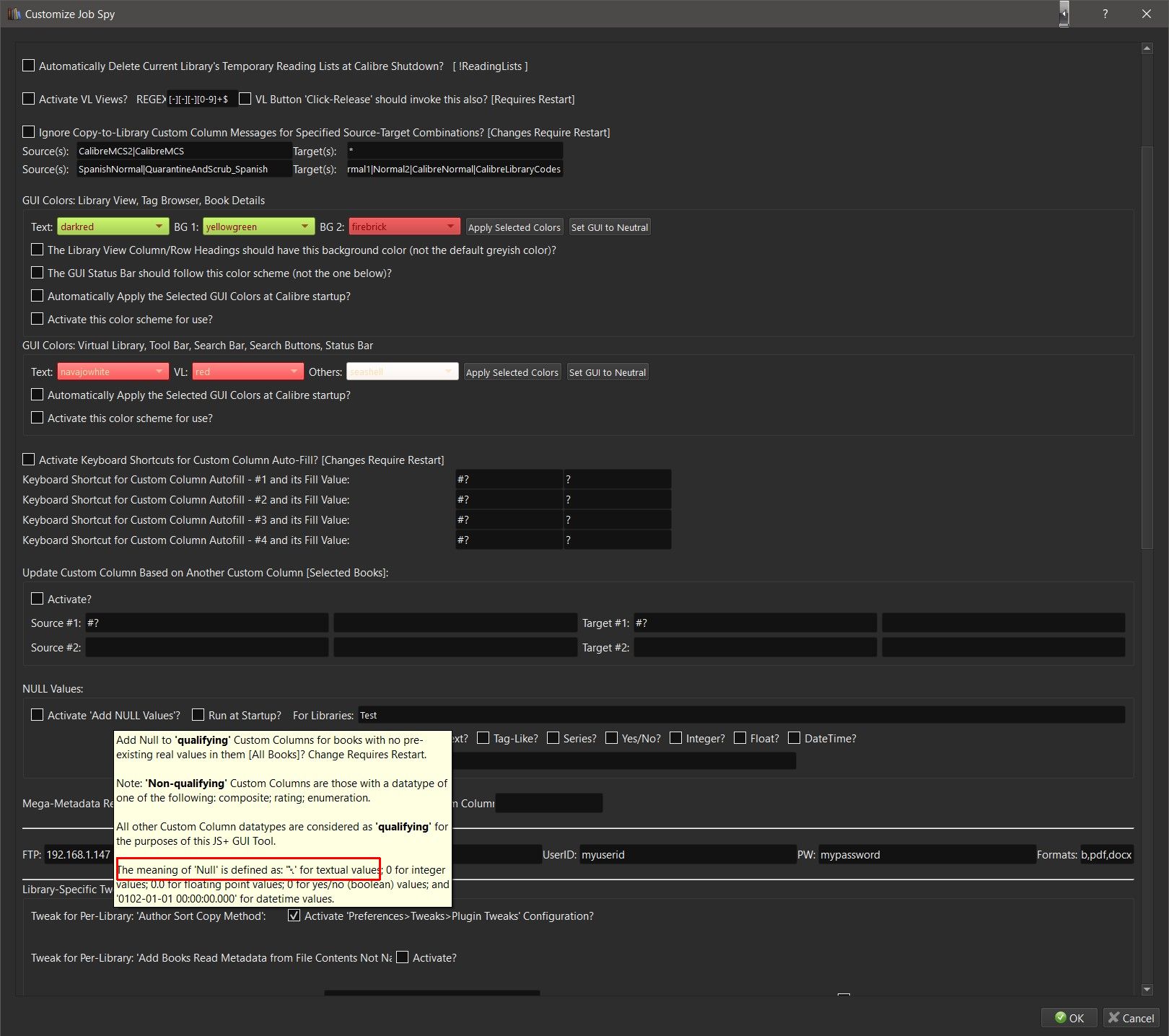

@theducks and @betterred - The insanity was a lot of (thousands of) backslashes (\\\\\\\) in the comments field, at least for the comments fields I was able to edit.
Do you use the JobSpy plugin? If so, maybe the backslashes came from here ?
Name:	Annotation 2020-02-17 091418.jpg
Not sure why JS equates '\' to undefined/empty/null, or whatever a zero length string is called these days.
Attachment 177191
No, I don't use JobSpy.

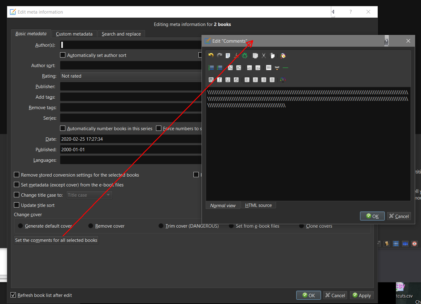

Another possibility
  • select a bunch of books;
  • do whatever you do to get into Bulk metadata edit;
  • press the Set the comments for all selected books button (last widget);
  • up pops the Comments editor dialogue;
  • press and hold backslash for a while;
  • click OK or press Alt+K
et voila- a bunch of books get a boatload of backslashes in Comments
