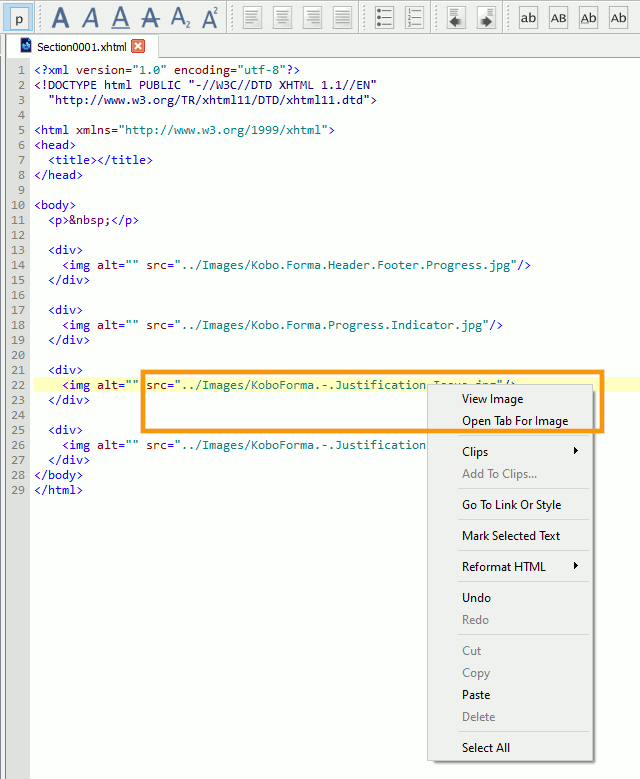

Originally Posted by Vroni View Post
No indication available, so replace and watch the preview pane. Oops, that wasnt a fleuron.
In Code View, you can also Right-Click an image's filename and View Image or Open Tab for Image:

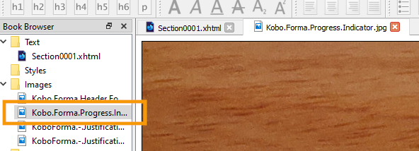

If you "Open Tab", it'll highlight the file in the Book Browser too, so you can easily know which one to rename:
(This is one thing Sigil does WAY better than Calibre's Editor. When you have a huge list of files+images, Sigil keeps the active one visible within Book Browser at all times.)
