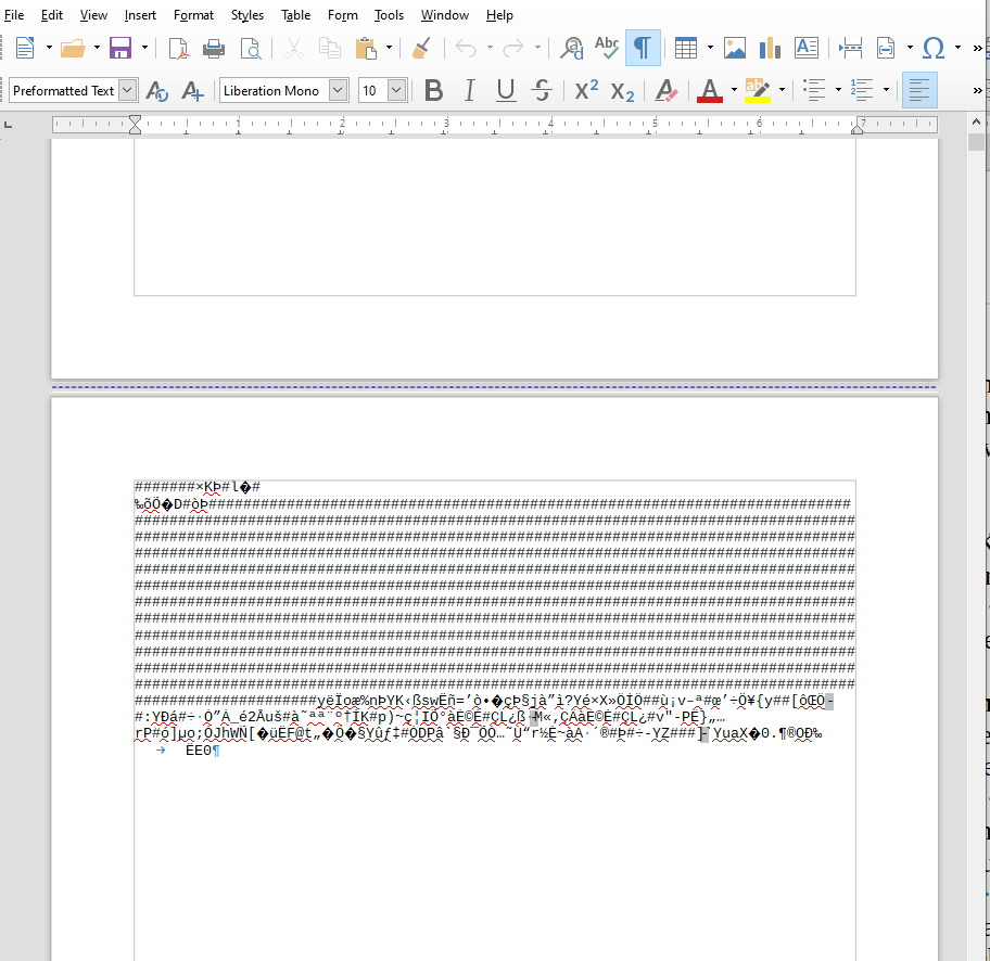

Did you try opening the QXD with LibreOffice? Does it open it? Or is the QXD created in a newer Quark?
This is what the Quark files look like in LibreOffice:
I've already invested a significant amount of time in cleaning up typos and other issues with the PDF version. Starting over again from the Quark source would generate more heat than light.
