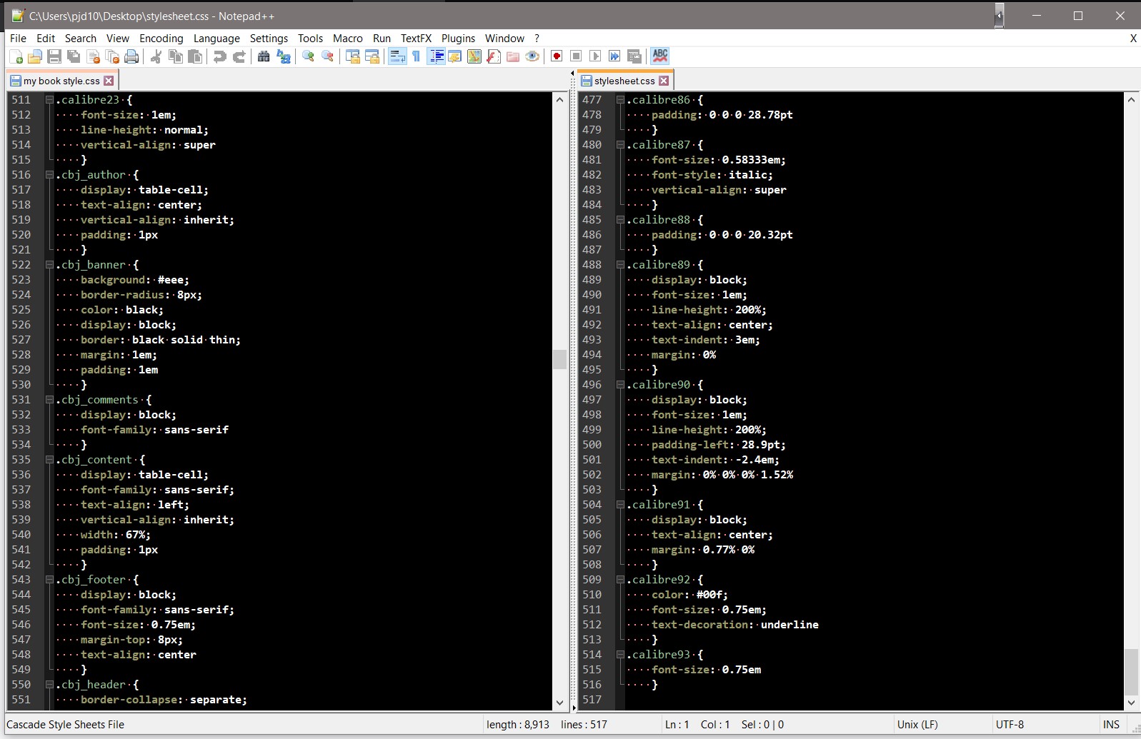

The CSS entries for the jacket are absent, viz:
Name:	Annotation 2019-07-30 101243.jpg
The one on the left is from the book I attached to post 11, the one of the right is what Odyssee posted. I can't find the styles used by the jacket, cbj_author, cbj_banner etc. No idea how, why - other than some css cleaner deleted them.
@Odyssee - try the Polish Book tool (select book and press 'P'), use the Remove a previously inserted book jacket option, and then run it again and use the Add/replace metadata as a "book jacket" page option
Thank you all once again for all the help. This really is a great forum with kind helpful people.
BetterRed, I did what you suggested (polish book etc) and ................... it did the trick! The metadata was inserted and I see everyting on my reader as well as in ADE. Problem solved. Great! Thanks again.
