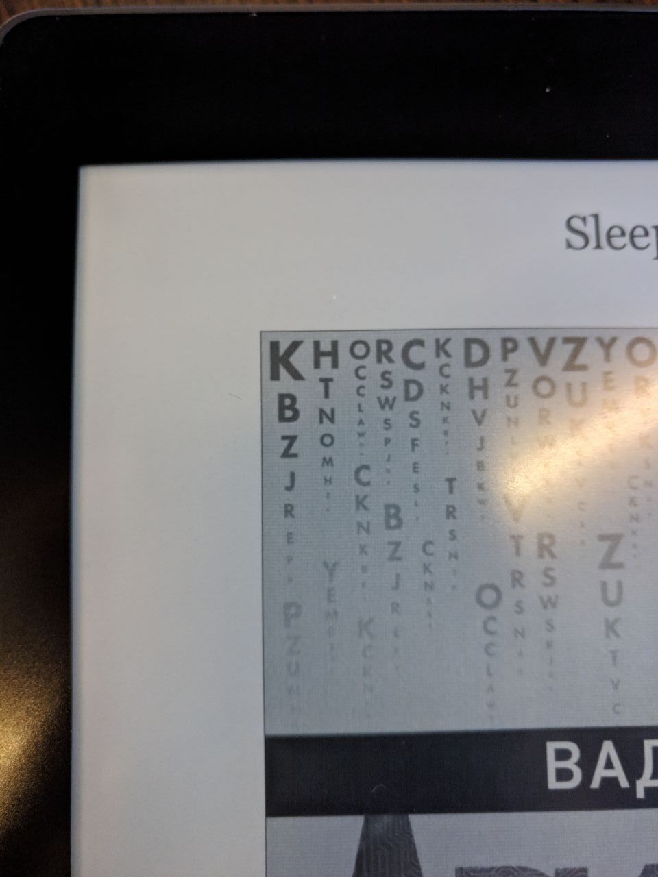

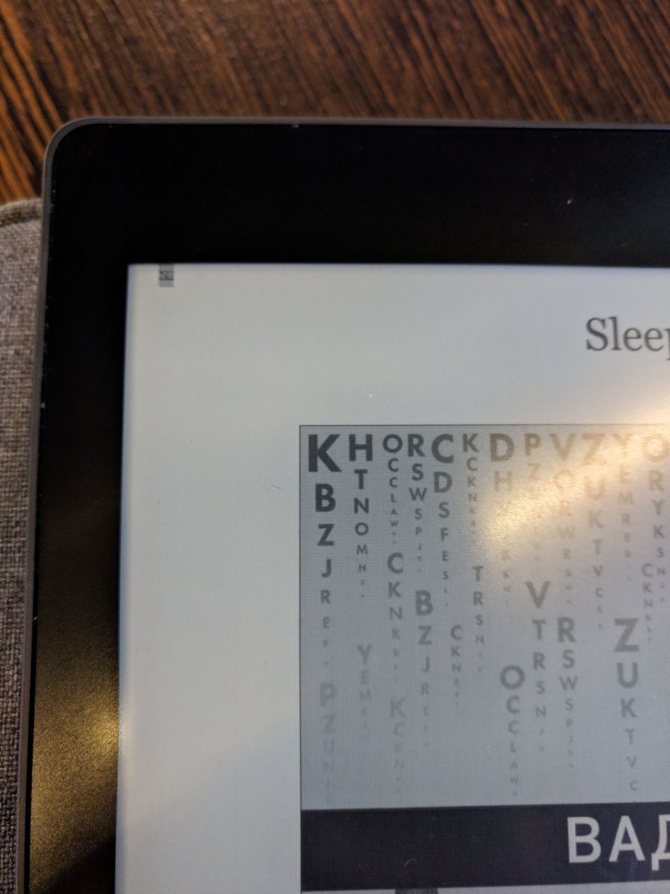

Works fine, but I have a little glitch. In sleep mode in left upper corner exist cursor mark. They appear in all synced books, but not exist of I upload book by cable.
It's stays the same form and size for attributed item and they are different from each other.
I can provide the photo of this glitch.
Hi, yes please do. Can it be that it's a kepub/epub format problem? I don't think I see anything similar.
I'm got it with kepub, don't taste on other.
In attach you find photo of it.
I'm recognize the mark - it thumbnail of cover.
It appear only in sleep mode.
I'm think that issue accorded to file placing on kobo. By default all my books placed to root of device, but synced files placed in ./kobo/kobocloud/library
Name:	photo_2019-12-19 10.47.14.jpeg
ID:	175716   Click image for larger version
Name:	photo_2019-12-19 10.47.18.jpeg
