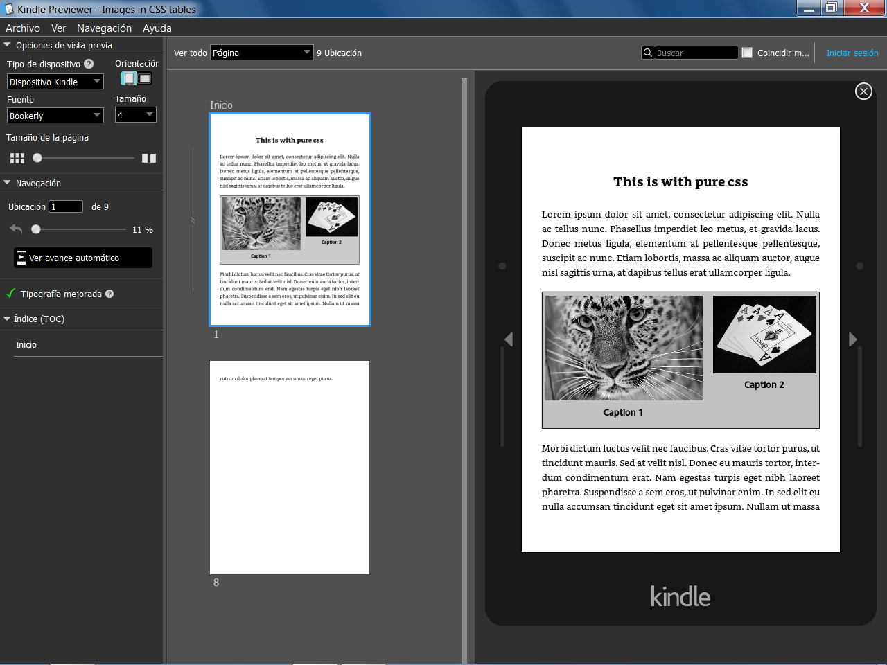

Originally Posted by kso View Post
@RbnJrg: The problem with the images has, as far as I can see, nothing to do with the images but is due to the bug the Voyage suffers from, as Hitch reported. The Code (and images) I'm using works everywhere else, except on the Voyage Preview.
No. I knew you should be doing something wrong I attach an .epub with the correct code. Open it with Kindle Previewer 2.94 and 3.29; in all devices you'll see the things correctly, even in Kindle Voyage preview. And also you have "enhanced typesetting" in Previewer 3.29. Of course, I'm using pure css so you'll need to write code for K7. But regarding all other formats, your issues are solved (at least, that is what I think )
ID:	170279 Click image for larger version
Regards
Rubén
EDIT: Of course, I used a background color and borders; you can remove that.

Last Question re my Kindle Problem:
How does one get egg off ones' face?
Seriously, all I forgot, and I've done this before, was to include
display: table;
for the outermost div, the display:table-row and display:table-cell divs are not much use without. As soon as I saw Rubén's code, I felt my face going red.
No. I knew you should be doing something wrong I attach an .epub with the correct code. ...
Regards
Rubén
Thank you so very much, all of you, that just made my day^h^h^hweek.
klaus

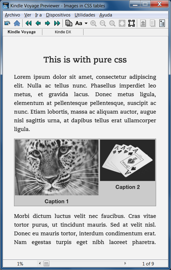

Hi Rubén
I found the time today to change my design draft code so the outer containers now are set to
display:table
Still didn't work on the Voyage until I noticed you have an additional DIV in each table cell to contain the image and caption.
As this DIV isn't needed for any other device or preview (both in 2.9 and 3.29.1) or any other target (Web, EPUB) I was wondering what gave you the idea to add this. Not sure I would have ever tried this as it works without the additional DIV everywhere else AFAIK.
Still, as the Voyage problem has been bugging me for some time I'm pleased as punch now. Thanks again.
As to the DX or any other KF7 devices: I'm not sure it's doable if they have different screen sizes (need to look into that), as you'd have to specify width and height in PX in the HTML directly. As it stands now, each image covers 100% of the page width if it's not an amzn-kf8 device.
klaus
Hi Rubén
display:table
Without that "<div>", the code doesn't work for Kindle Voyage. In KV the images fill the 100% of the screen width, and it should fill the 100% of the container width. So the width of the cells gives the width to the divs, and the width of the divs gives the width for images
Yes, you won't be able to get a perfect view for DX and others KF7 devices. You'll have to chosse to do things for DX or for Kindle 2. I would write the code for DX.
