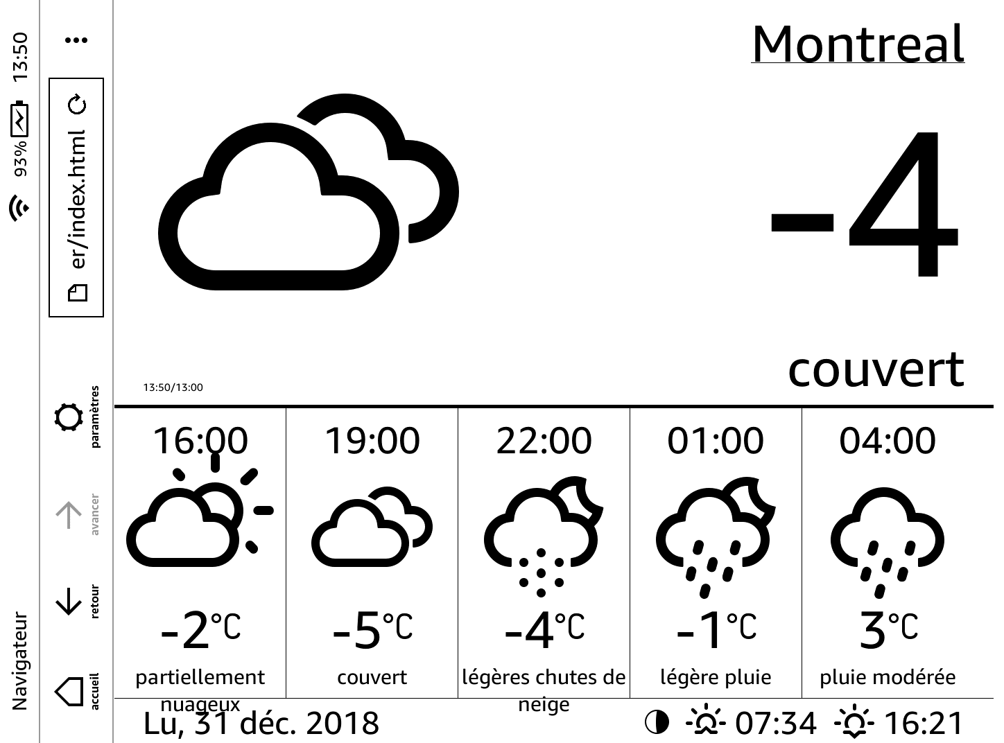

Originally Posted by matopeto View Post
i see on your screenshot that sunset and sunrise times are off. In current versiou you can set utc offset to match your country and all times will be ok.
Yep

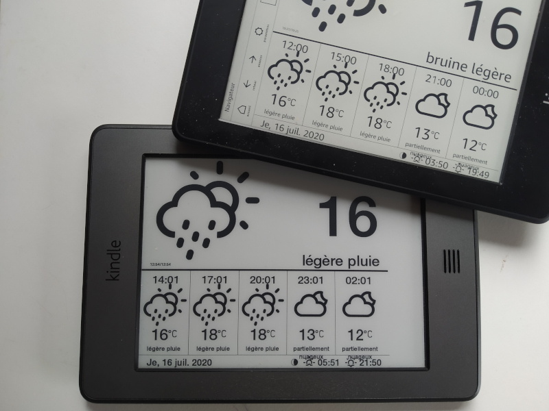

Hello,
Nice project. Could make it working on an old Kindle Touch, with Kual without navigation border.
Couldn't have the local neither the js working on my own server, so using the url query parameters on it.
Thanks!

Could you elaborate on the steps needed to get it without a border?
Perhaps you can go to fullscreen with jailbreak and Weblaunch https://github.com/PaulFreund/WebLaunch, but i don't known if it is working
About time on two lines, send me please a screenshot. I will look at it. (I think it is problem with AM/PM identificator, because i don't use it)
I did like this, using kual. I installed it many years ago... and was still working.
Do you have kual installed?
I don't know today about kual installation, I didn't tried it on my 2 paperwhites. I guess you have to be careful with it...
Narval is offline   Reply With Quote
