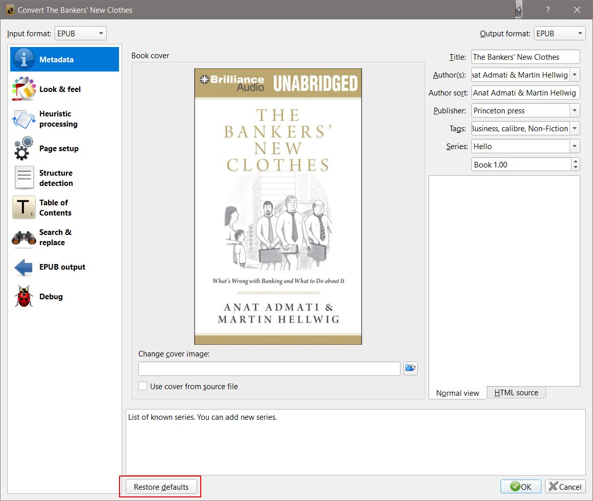

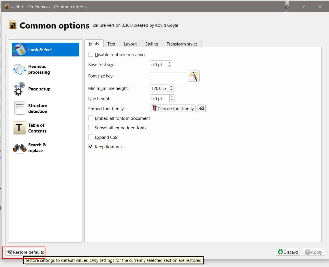

Old 12-26-2018, 05:31 PM   #29
Posts: 22,397
Karma: 31000056
Originally Posted by ilovejedd View Post
I believe "Restore defaults" only restores the Calibre-wide general conversion settings to their original values. (so those would be in config/conversion/*.py)
It doesn't affect the per book saved conversion settings which are stored in the "conversion_options" table in metadata.db.
Which "Restore defaults" are you referencing:
Preferences Click image for larger version
ID:	168629 or Single Conversion Click image for larger version
Name:	single conversion.jpg
My reading of the tooltip for the the first is that it resets the selected Preference values to the Factory (installed) Default settings; and I have always assumed the second resets the selected values to what is currently set in Preferences. I haven't messed with conversion settings for a couple of years, so my memory is a bit rusty.
The button in Single Conversion lacks a tooltip, perhaps that could be remedied, and maybe relabel the button to "Restore User Preference Settings", or "Remove Book specific stored settings". The latter would make it consistent with Bulk Metadata Edit; if that indeed is what it does.
IMO the QC plugin would be the logical place to provide something that listed the books with one-off conversion settings, e.g. a Check individual conversion in the Check Epub structure group. But, given plugin is a) not being actively maintained, apart from making sure it continues to work, and b) it currently relies on the content of metadata.opf files for related checks, then this may not be easily done.
So, if it can't be done in via template function used in a custom column as suggested by DivingDuck, then IMO, the next logical place would be a new tool in DaltonSt's JobSpy plugin. Assuming there is someway to interrogate SQL database to get the right answer, as per ilovejedd's post #24.
