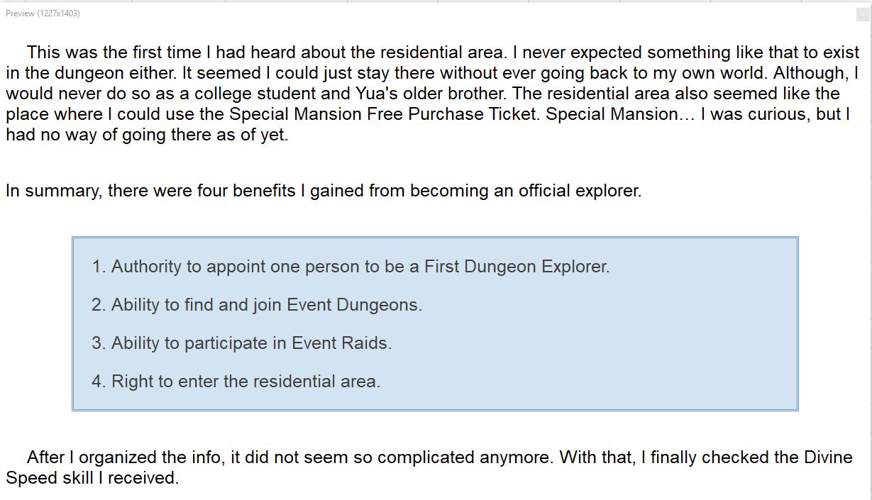

I agree that this is probably an issue with aldiko and not with the book. Honestly, the code/css snippet you showed is one of the cleaner examples I've seen. I would listen to Hitch and BR and either rotate your screen or use a different reader.
If you are intent on deleting all references to a <table> then it will take a few find/replace steps. I've outlined the procedure below, however I would NOT do this with my books. For the example code you showed above, I would change the <table> to a <div> and transfer the CSS styling so that it looks the way the author intended...and also so you can differentiate what kinds of communication are being portrayed. Simply deleting the <table>s will make all the paragraphs look the same - you won't be able to easily tell what is a system message and what is a character talking.
Here is an example of how I would code the <div>s (screenshot attached):

WARNING: Using this procedure may will have some unintended consequences...make a backup of your file before doing this...
Open the "Find & Replace" tool (Ctrl-F if it isn't visible). Check "DotAll" and "Wrap" in the options. Select Regex and "All HTML Files" in the Mode. Enter each of the following searches, one at a time, into the find and replace fields. Click the "Find" button, then click the "Replace" button. If you are happy with the results then repeat, or you could use the "Replace/Find" to automatically go to the next instance after making the replace. OR, you could use the "Replace All" button to do it all at one go...but you cannot Undo the Replace All...again, make a backup...
Search 1:
Find: <td>\s*(.*?)\s*</td>
Replace: \1
Search 2:
Find: <tr>\s*(.*?)\s*</tr>
Replace: \1
Search 3:
Find: <table.*?>\s*(.*?)\s*</table>
Replace: \1
If you want to try replacing the <table> with a <div> then use this as the 3rd search:
Search 3:
Replace: <div class="msg">\n\1\n</div>
EDIT:
This procedure is based on your example...it assumes that all the information inside of the table is already wrapped with <p> tags.
