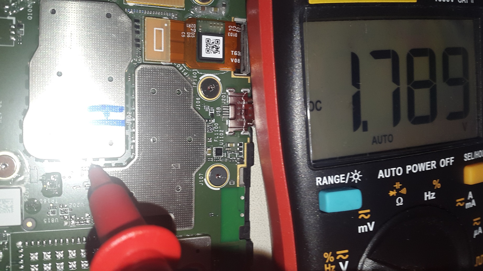

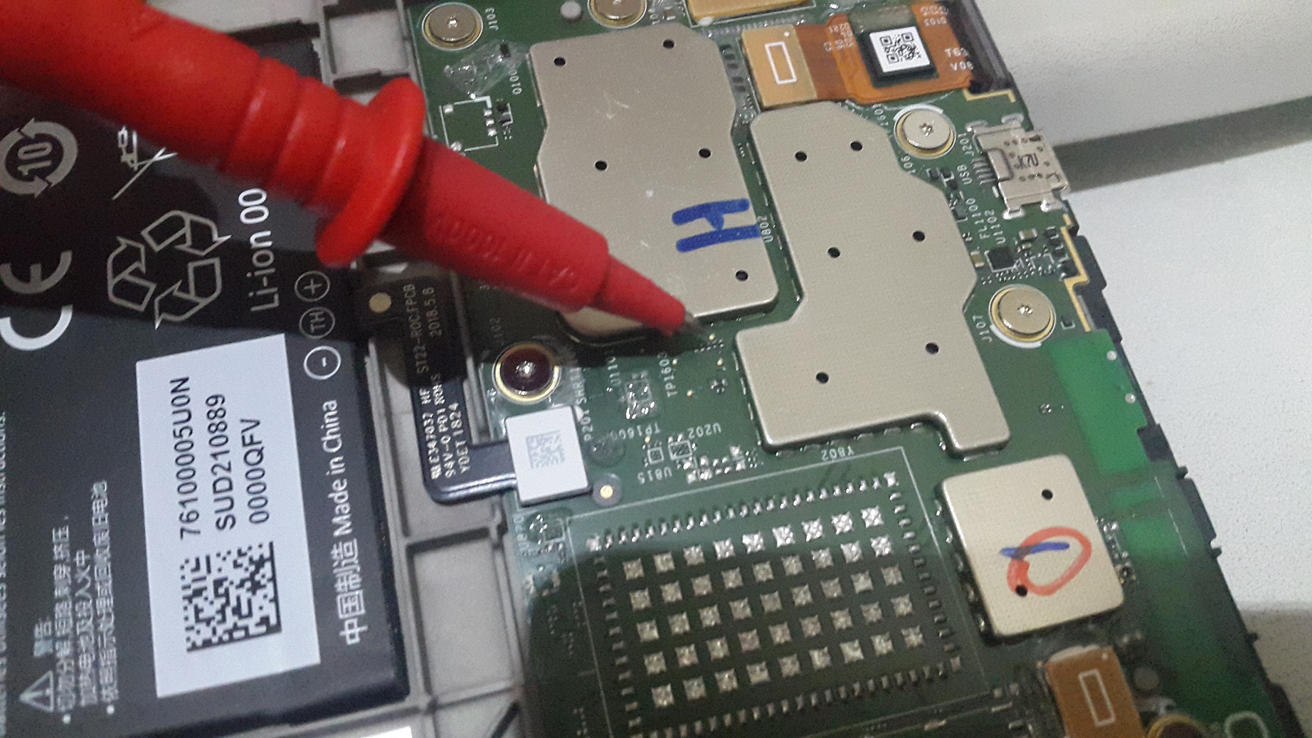

eruditionastic where is to put fourth wire for power to the board, this is picture of board of pw4 from this topic, same board i have on pw 4.
https://www.mobileread.com/forums/at...8&d=1544783589
I don't know where the power is on a PW4. You could use a multimeter and find it though. Use a screw as the ground and poke around until you see something with 1.8v on it.
I only saw one person try so far and they didn't find a 1.8v source on a PW4. Hopefully you can and let us know!

I find 1.8v on pw 4
ID:	170162   Click image for larger version

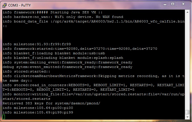

I am stuck in demo mode.
I entered command ";demo" and now not possible to exit.
Kindle now connected with serial cable with putty
What to do in putty ?
stmusic is offline   Reply With Quote

PW4 wifi, good pw, i type ";demo" and not use wifi and pw 4 now stuck in demo mode.
I use serial cable and what need to do now ?
On enter in putty i have this:
Menu
3. Load MMC over USB storage
E. Export FAT partition
U. Update using update*.bin file on FAT partition
D. dmesg / kernel printk ring buffer.
Q. quit
On 3 not working, how to see storage on kindle ?
Update:
I try E. Export FAT partition and now i see partition of kindle,
what to do next, what to upload on pw4 memories, which fw ?
I resolve this with DO_FACTORY_RESTORE in demo folder.
But still is my question only for curiosity :
When i do E. Export FAT partition what to upload on pw4 memories, which fw is good solution ?

Your choice of update packages posted by Amazon for your device.
(They only list the most recent, but you can get older by just changing the URL version field.)
Export to USB
Put package at top of visible USB storage
Remove USB cord
Reboot
