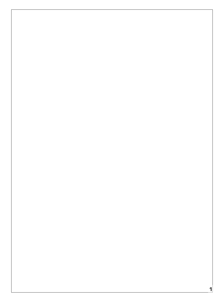

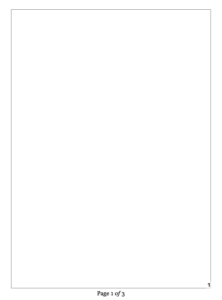

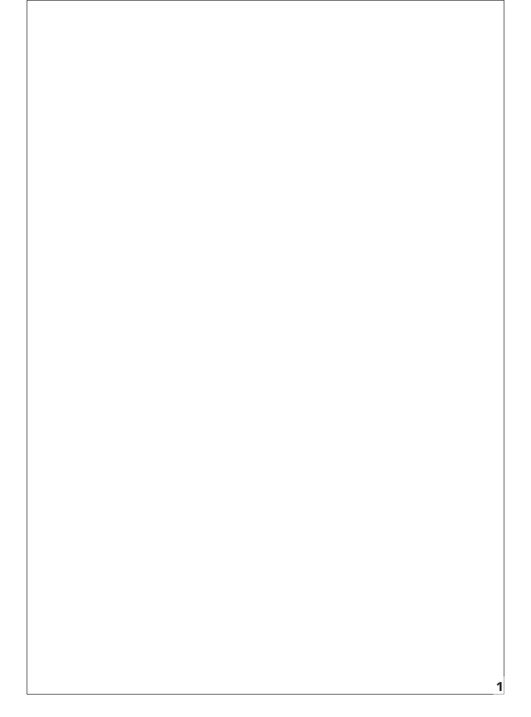

@GeoffR: Unpatched H2O. (Initial settings: NO page numbers, footer+header).
(fbgrab capture, to avoid Nickel's shenanigans with the top-11 pixels on the H2O).
ID:	168345   Click image for larger version
ID:	168346   Click image for larger version
ID:	168347   Click image for larger version

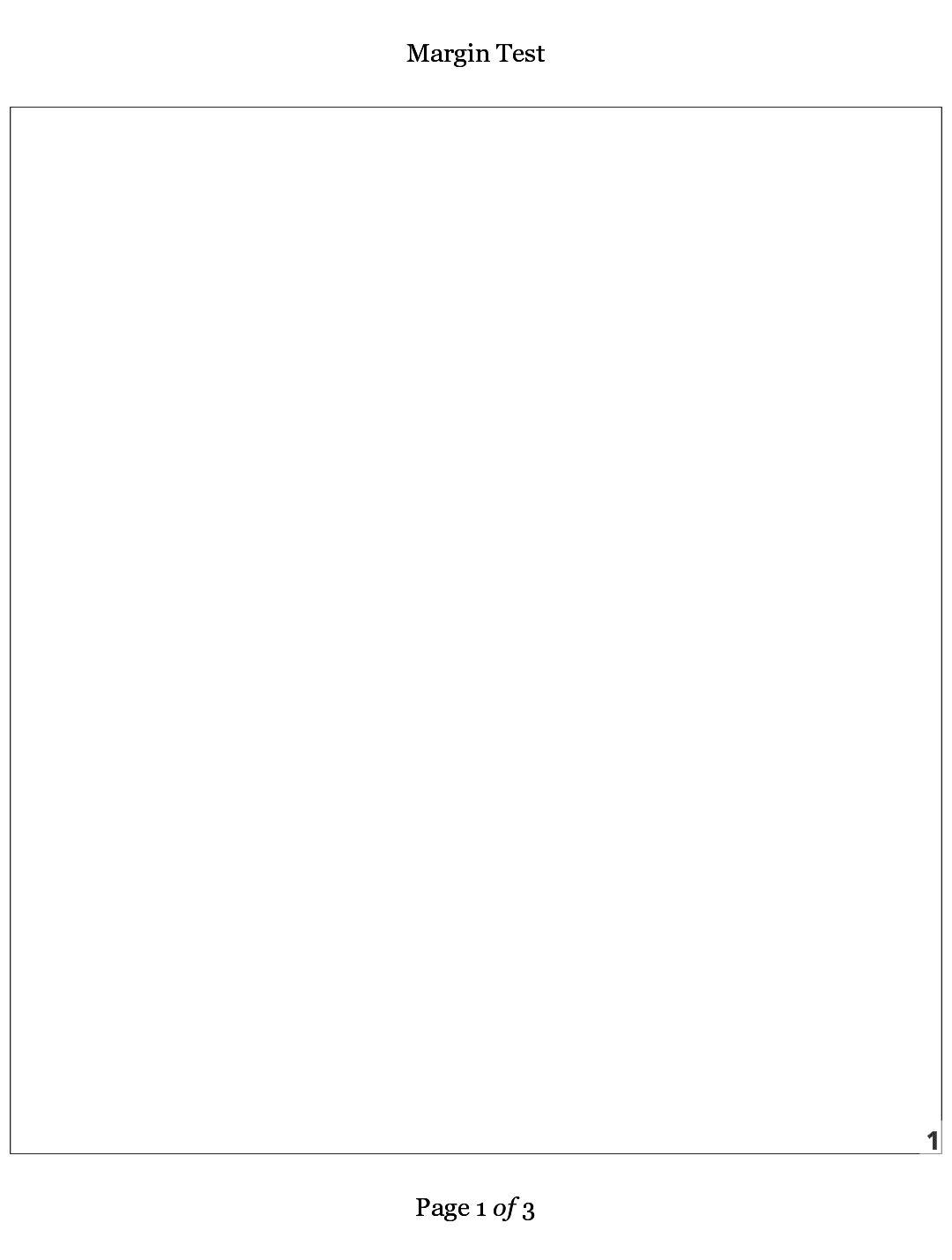

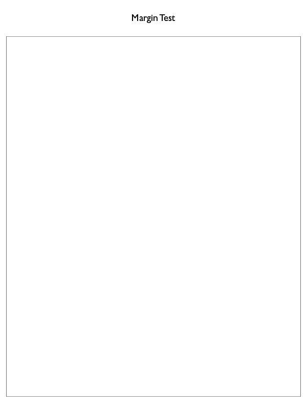

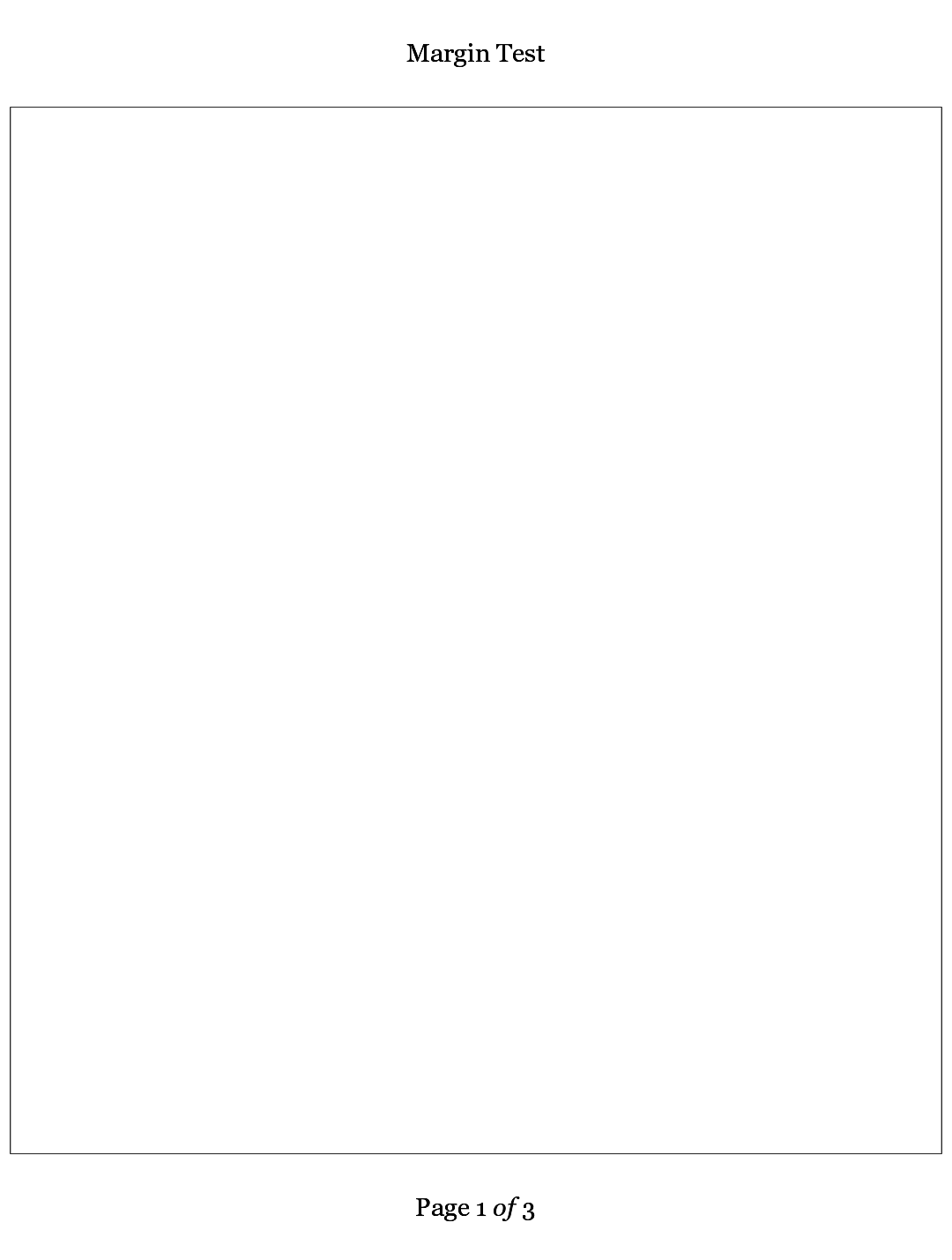

And here are screenshots on my Aura Ed 2 without patches.
So, I noticed one thing. When the reduce header menubar patch is applied, the header shrinks (compare this one with my previous set of screenshots). I'm going to try reducing the header menu to 0 and see how tall it is.
ID:	168352   Click image for larger version
ID:	168353   Click image for larger version
ID:	168354   Click image for larger version

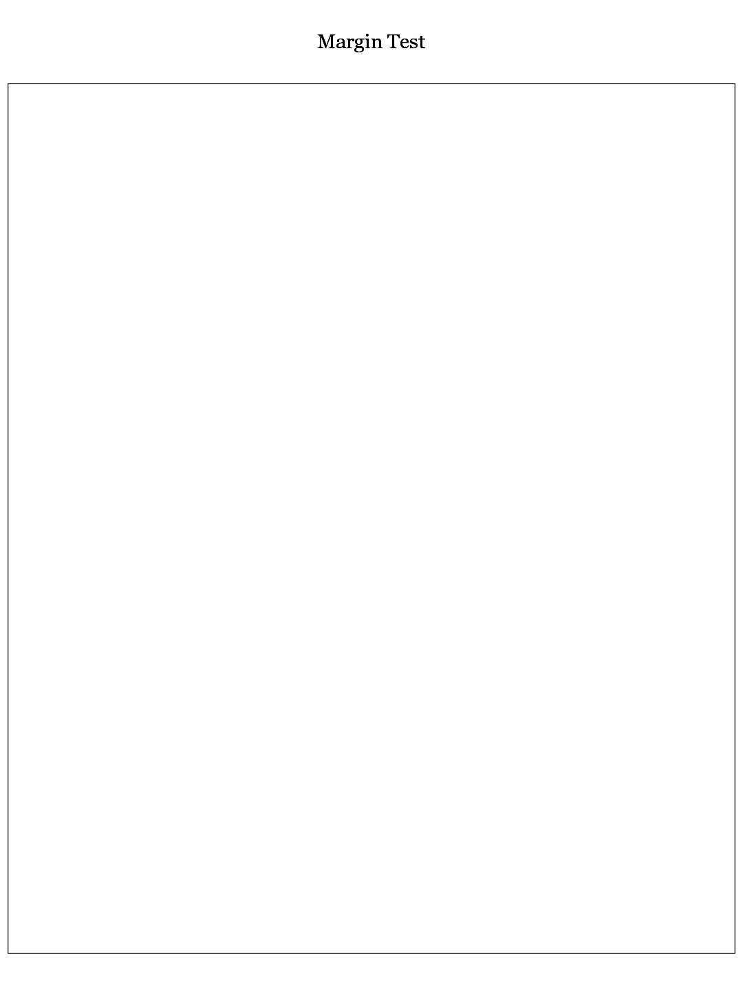

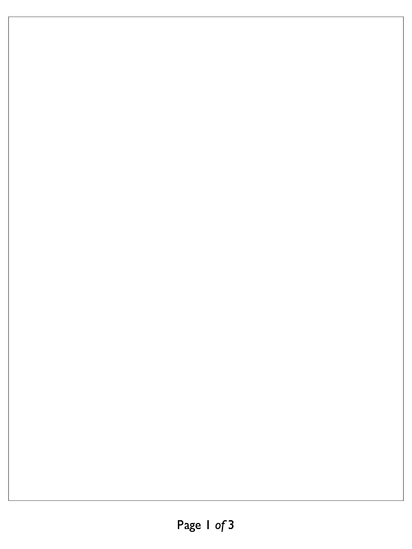

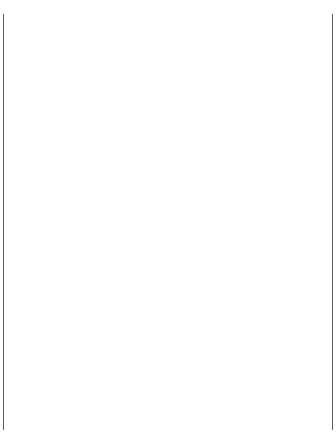

So here's the really interesting screenshots. This was taken with my usual patch configuration, but instead of reducing the header menubar by 33%, I reduce it by 100% (to 0px).
Now, when the title is shown, there is not anymore margin! I think we have almost found the patch. And also, we know now that there is a fixed margin at the top and bottom when it is hidden. I'll measure it in a moment, and see if I can find anything like it in the firmware.
Edit: So, I've measured the screenshots, and it seems that the top/bottom margin when hidden is 32px on my Aura Ed 2. When the top is showing, the top margin is based on the menubar height, which can be controlled by the custom header menubar reduction nickel patches (I'll calculate it later). The bottom margin is controlled by libnickel, and is not based on the menubar height, but by the height which can be patched by one of GeoffR's.
Here is the result:
ID:	168357   Click image for larger version
ID:	168358   Click image for larger version
ID:	168359   Click image for larger version

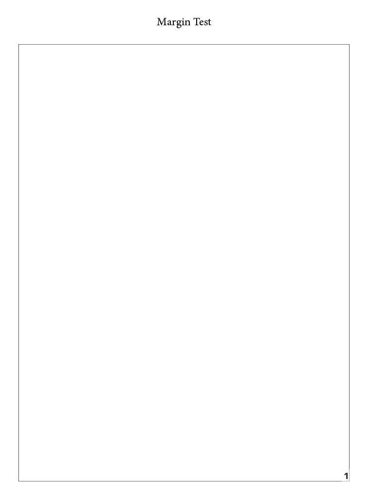

Device: kobo touch

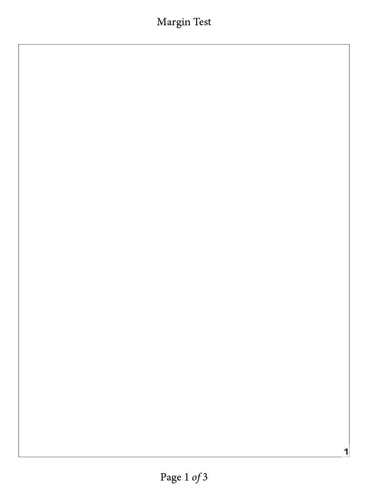

If someone has this firmware installed on a lower-resolution device such as Touch or Glo, could you post a screenshot of the first page of this test ePub please?
Kobo Touch
ID:	168366   Click image for larger version
ID:	168367   Click image for larger version
ID:	168368   Click image for larger version

Originally Posted by tshering View Post
Kobo Touch
So the margin is 24px for the touch.
Originally Posted by John F View Post
I haven't updated my firmware since 3.15.x. A lot of cool and helpful patches. Kudos.
And 44px for the H2O.

Thanks for all the screenshots, it looks like the size of the ePub header when the title is hidden is approximately (but not precisely except for the Touch) 3% of screen height, or 4% of screen width.
Touch: 24px
Aura2: 32px
H2O/Clara: 44px
Forma: 56px
I'm guessing other devices will use one of those four sizes as well.
Edit: It could be the header size is being calculated as: divide screen width by 100, round to nearest integer, multiply by 4. I think that would fit all the examples so far. Or else they could just be hard-coded pixel sizes.
