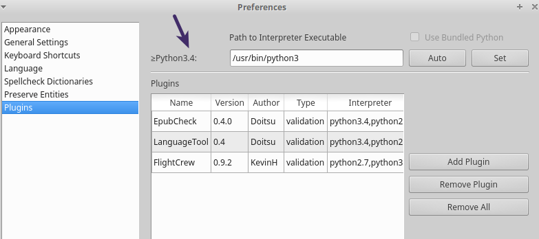

I wanted to try SlowSmile's plugin, https://www.mobileread.com/forums/sh...d.php?t=288294 but didn't know if I had Python 3.4. (screenshot) Does that mean I have 3.4 or do I have to get it? (And if I have to get it, where would I get it?)
Thanks.
