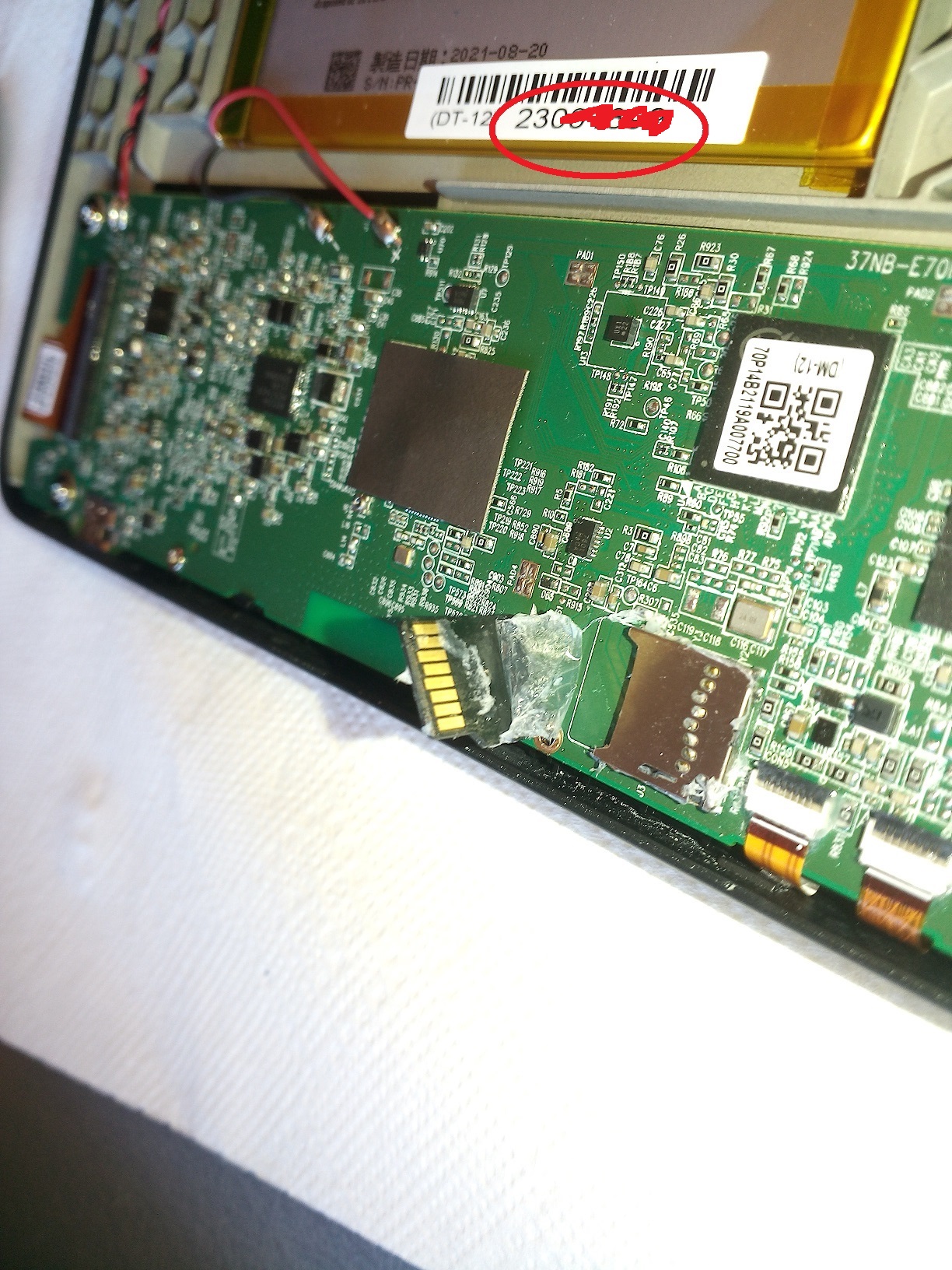

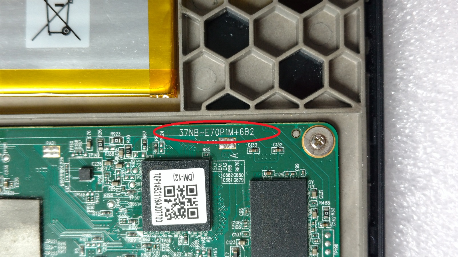

As it turns out, there are at least two versions of Vision 6.
Devices with motherboard 37NB-E70P1M+6B2 and devices with motherboard 37NB-E70P1M+6C1.
I have images for 6B2.

Hi @Waldy!
I have a +6B2 motherboard in the semi-bricked Vision 6 I bought. The OS is crashing upon boot, or rather the System UI and the tolino apps are crashing so it is basically not usable.
My guess is the sd card is either dead or the device didn't survive an update.
Anyway I successfully fumbled out the sd card, and took a backup using dd. But the backup is probably useless if the OS files are corrupted anyway.
Would you send me the image via PM?
Thanks a lot!

"A few days ago I bought two defective Vision 6 devices.
One had a system UI error message, the other was in bootloop.
Try to restore in the usual way using Recovery,
were, as expected, unsuccessful.
It turned out that both devices had the serial number 2313xxxx and a motherboard 37NB-E70P1M+6B2.
I have such images and simply replaced the SD cards by first rewriting the corresponding serial number.
Now, to experiment, I saved images from defective SD cards and wrote these images to working SD cards.
The image with system UI error message started working after resetting in recovery mode and the image with bootloop started on its own."

Thanks a lot! Before your post here I already started writing the dump from the existing sd cards to my new sd cards.
Afterwards I put the update.zip from the Tolino website onto the partition that was labeled "media_data" where an existing update.zip resided, which I overrode. Afterwards I started the recovery and selected the recover option which went through without problems (while the original update.zip on the partition failed) and then the ereader worked perfectly fine afterwards with the new sd card!
Today another defective Tolino Vision 6 (with a +6B2 motherboard) arrived and I just now did the same procedure and it worked just fine as well!
So I both recovered them from crashing System UI apps by just replacing the sd card and replacing the update.zip in the "media_data" partition, I'll later test the sd cards with f3, if they appear to be working I'm guessing that the previous owners updated the device with an empty battery and bricked the device this way.

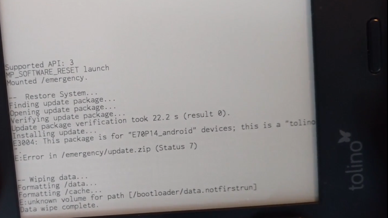

In my images, update.zip - 15.4.0 (was 15.0.0) was obviously inserted into the “media_data” partition. If “media_data” contains an update.zip lower than 15.3.0, and the device has firmware 15.3.0 or higher installed, when resetting to recovery we will get this error:
https://www.mobileread.com/forums/at...1&d=1728797954
In this case, you can simply flash the corresponding recovery.img (without modifying “media_data”, this will always have to be done after updating the firmware):
https://mega.nz/file/Wp132CrR#HSGKZq...EzHsleLJ1G95SA
https://mega.nz/file/z7oDxLba#lW6eAE...h-8UrD7nSKb5rM
