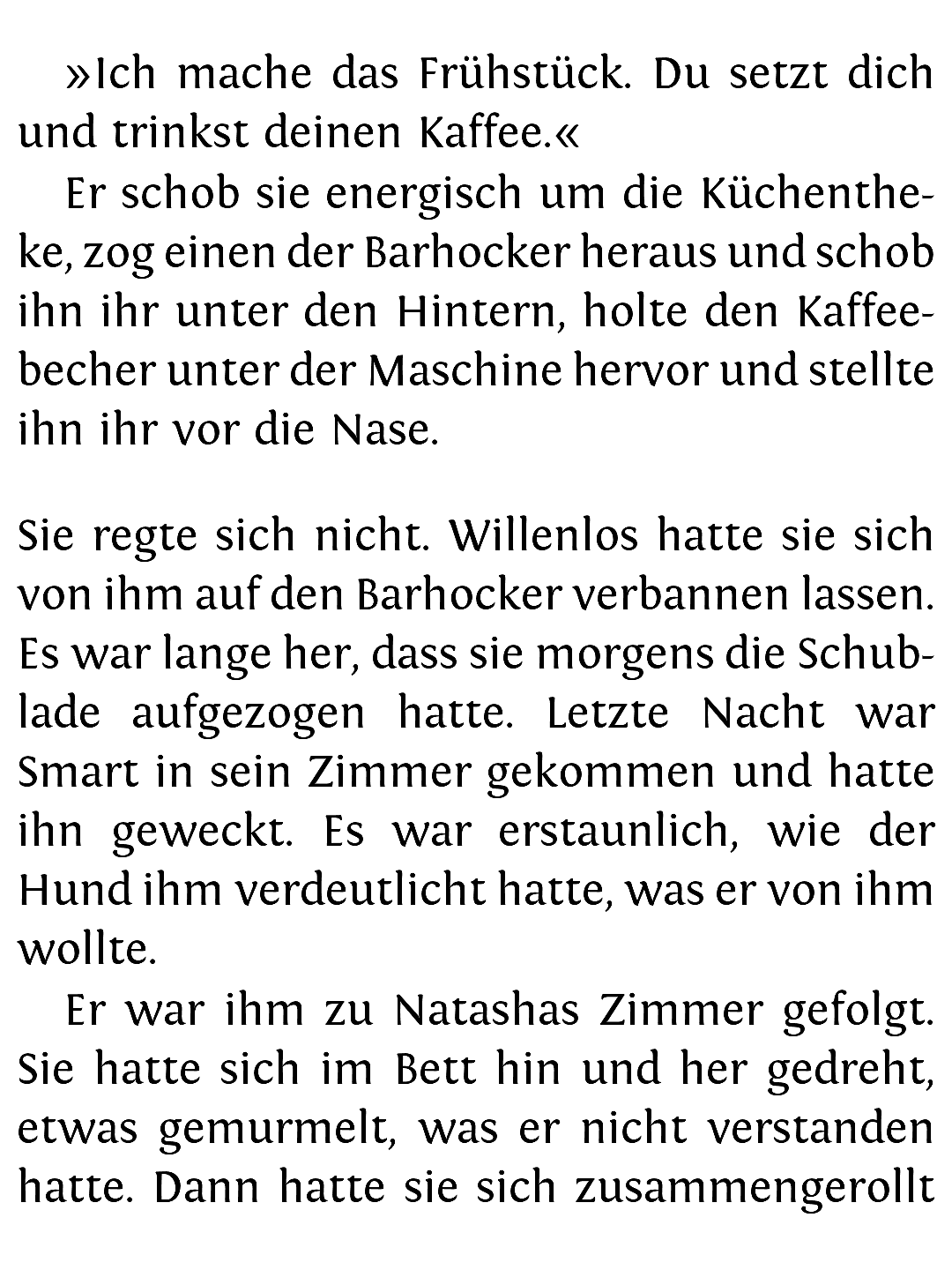

Old 10-28-2018, 07:26 AM   #24
Martina Schein
eBook-Reader-Fan
Martina Schein ought to be getting tired of karma fortunes by now.Martina Schein ought to be getting tired of karma fortunes by now.Martina Schein ought to be getting tired of karma fortunes by now.Martina Schein ought to be getting tired of karma fortunes by now.Martina Schein ought to be getting tired of karma fortunes by now.Martina Schein ought to be getting tired of karma fortunes by now.Martina Schein ought to be getting tired of karma fortunes by now.Martina Schein ought to be getting tired of karma fortunes by now.Martina Schein ought to be getting tired of karma fortunes by now.Martina Schein ought to be getting tired of karma fortunes by now.Martina Schein ought to be getting tired of karma fortunes by now.
Martina Schein's Avatar
Posts: 175
Karma: 444178
Join Date: Sep 2012
Location: Saarbruecken / DE
Device: Kobo Aura H2O 2nd Edition
Originally Posted by jcn363 View Post
Can you put a screenshot? please.
Good luck.
Enclosed the desired screenshot. As you can see, the distances above and below are quite large. With the firmware versions before, they were about 2 mm.
In the file Kobo eReader.conf I entered this under the section [Reading]:
fullScreenReading=true
Martina Schein is offline   Reply With Quote
Old 10-28-2018, 07:31 AM   #25
jcn363
absolute beginner
jcn363 ought to be getting tired of karma fortunes by now.jcn363 ought to be getting tired of karma fortunes by now.jcn363 ought to be getting tired of karma fortunes by now.jcn363 ought to be getting tired of karma fortunes by now.jcn363 ought to be getting tired of karma fortunes by now.jcn363 ought to be getting tired of karma fortunes by now.jcn363 ought to be getting tired of karma fortunes by now.jcn363 ought to be getting tired of karma fortunes by now.jcn363 ought to be getting tired of karma fortunes by now.jcn363 ought to be getting tired of karma fortunes by now.jcn363 ought to be getting tired of karma fortunes by now.
jcn363's Avatar
Posts: 323
Karma: 1750999
Join Date: May 2017
Location: Go with the wind (43°19'17.7"N 2°00'19.4"W)
Device: ka1
With this firmware this parameter has no sense because is included (I think).
I'll try before because I think there can be a collateral issues.
Good luck.

Old 10-28-2018, 11:05 AM   #27
jcn363
absolute beginner
jcn363's Avatar
Posts: 323
Karma: 1750999
Join Date: May 2017
Device: ka1
This is the cleanest I can figure it right now.
FOOTER
Select show footer into settings.
BE CAREFUL NOT TO CHANGE THE LENGTH OF THE REPLACEMENT STRING.
You can increase red color text.
  - FindReplaceString:
      Find:    "ReadingFooter {\n  qproperty-footerMargin: 105;\n}\n\
                ReadingFooter[qApp_deviceIsDragon=true] {\n  qproperty-footerMargin: 170;\n}\n\
                ReadingFooter[qApp_deviceIsDaylight=true] {\n  qproperty-footerMargin: 221;\n}\n\
                #caption[qApp_deviceIsTrilogy=true] {\n  font-size: 19px;\n}\n\
                #caption[qApp_deviceIsPhoenix=true] {\n  font-size: 23px;\n}\n\
                #caption[qApp_deviceIsDragon=true] {\n  font-size: 29px;\n}\n\
                #caption[qApp_deviceIsAlyssum=true] {\n  font-size: 32px;\n}\n\
                #caption[qApp_deviceIsNova=true] {\n  font-size: 32px;\n}\n\
                #caption[qApp_deviceIsDaylight=true] {\n  font-size: 37px;\n}\n\
                #caption[qApp_localeName=\"ja_JP\"] {\n  font-family: Sans-SerifJP, sans-serif;\n  font-style: normal;\n}"
      Replace: "ReadingFooter{ qproperty-footerMargin: 00; min-height: 40px; max-height: 40px; }\n\
                ReadingFooter[qApp_deviceIsDragon=true] { min-height: 00px; max-height: 00px; }\n\
                ReadingFooter[qApp_deviceIsDaylight=true] { min-height: 60px; max-height: 60px; }\n\
                #caption{ font-size: 16px; margin-top: -08px; }\n\
                #caption[qApp_deviceIsPhoenix=true] { font-size: 20px; }\n\
                #caption[qApp_deviceIsDragon=true] { font-size: 26px; }\n\
                #caption[qApp_deviceIsAlyssum=true], #caption[qApp_deviceIsNova=true] { font-size: 30px; }\n\
                #caption[qApp_deviceIsDaylight=true] { font-size: 32px; }\n\
                #caption[qApp_localeName=\"ja_JP\"] { font-family: Sans-SerifJP, sans-serif; font-style: normal; }   "
HEADER
If you have activated
  src/libnickel.so.1.0.0.yaml:
    Custom kepub default margins: yes
you can reduce
  - ReplaceZlib:
      Find:    "#StatusBarView[qApp_deviceIsTrilogy=true] {\n  max-height: 71px;\n  min-height: 71px;\n}\n\
                #StatusBarView[qApp_deviceIsPhoenix=true] {\n  max-height: 91px;\n  min-height: 91px;\n}\n\
                #StatusBarView[qApp_deviceIsDragon=true] {\n  max-height: 121px;\n  min-height: 121px;\n}\n\
                #StatusBarView[qApp_deviceIsDaylight=true] {\n  max-height: 157px;\n  min-height: 157px;\n}"
      Replace: "#StatusBarView{max-height:60px;min-height:60px;}"
perhaps to
  - ReplaceZlib:
      Replace: "#StatusBarView{max-height:35px;min-height:35px;}"
Beware because it's the menu bar size too.
Good luck.
jcn363 is offline   Reply With Quote
