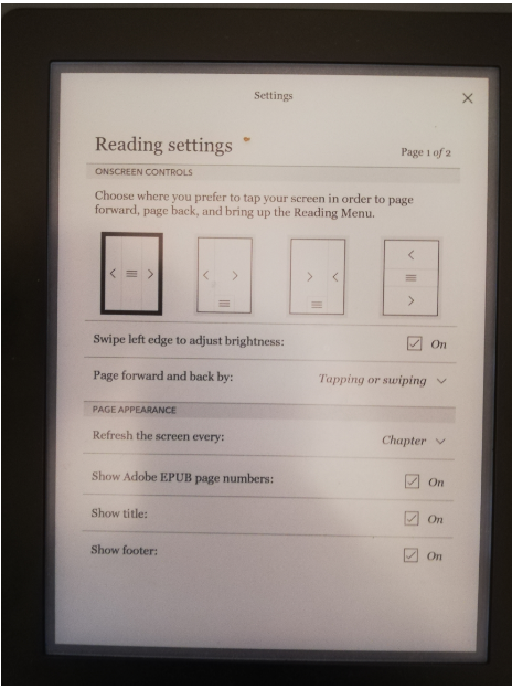

New firmware for the Forma is out today. If you sync your kobo you should get it.
Most notable change I’ve seen is you can now enable or disable the header and or the footer in kepubs
I’ve not looked for other features yet. This update did not come to my KA1 just to my Forma.

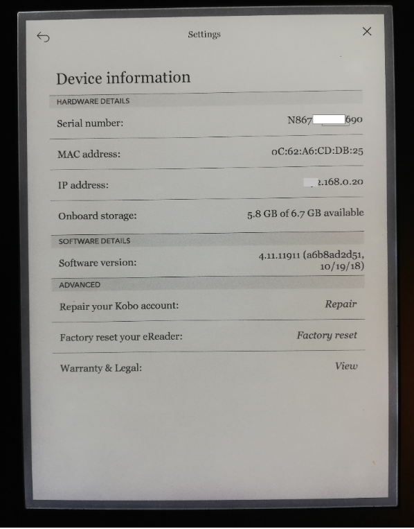

I install "Firmware 4.11.11911" it on my KOBO H2O 2Gen and for now it works :RÉ
[Reading Setings] :
[Device Info] :
PS : I see no problem, but take no unnecessary risk ;-)

Interesting, thank you!
...I see you blanked out your local IP address in the second picture (which would have been useless information to anyone), but you did not blank out your serial number.....?

Even if I do not think that the local IP address and serial number can serve anyone, but it's true, we're never careful enough. Thank you ;-)
