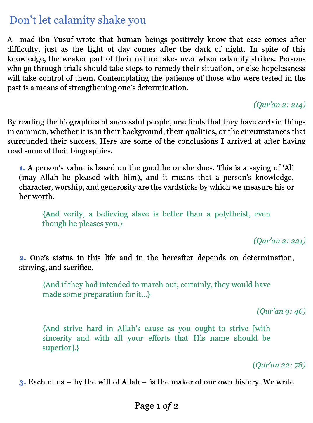

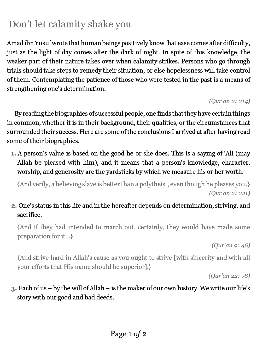

I've uploaded a 1 page sample for everyone. This epub on my kobo is all the same seize, no large text, no bold, just the same all round. The .mobi is fine. If you open the files in sumatra on Windows, you'll get an idea of how it works.

The attached screenshots are taken from my Glo HD. As with my previous example, there are differences, but, not really that much. I can see multiple font size, italics. There doesn't appear to be any bold text. The main differences is in line spacing and the indentation for quotes. As I stated a bit quickly above, some of this could be the font you are using. The two Kobo fonts at the bottom of the list do not work well with epubs. When you use them with epubs, you don't get bold or italic text. Using any of the other fonts should work. And if you are adding your own font, then you need to do this correctly. Again, a common error when adding fonts will mean no italics or bold text.

I looked at the samples linked to above assuming they were representative of the full book. But, you sent me links to the full books. When I looked at the epub version, it bore absolutely no relationship to the sample posted. The sample has no stylesheet and each tag has a style. The full book uses a stylesheet and each tag has a class.
The problem is that there are a lot of errors in the book. The fonts are invalid and the stylesheet has errors. Because of this, the stylesheet will be ignored and everything is styled using whatever defaults the device uses. If you fix the book, it will work. Open the epub in the calibre editor, run the error check and fix them.
